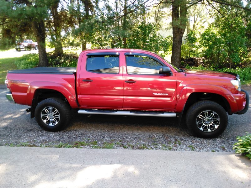

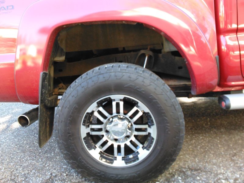

    I have a 2010 Tacoma with a 3" lift with 265/70/16 on there right now, I was wondering what your advice would be with going with a larger tire and not rubbing, maybe taller,wider..
    Thanks For Any Advice...

    33s! Fat or skinny

    255/85r16s (skinny 33s) I'd bet you wouldn't.

    If you're still running the stock alloys you won't be able to do 285/75/16s as they'll rub your UCAs. To fix that you could use spacers... but then you might need to trim plastic, worse case scenario you'll need a can mount chop.
    I'm at 2.5" front lift with 285/70/16 no rubbing for on road driving. I do get rubbing offroad while sharp turning

    You can go larger on stock wheels without rubbing. If you don't want to trim, run spacers or swap wheels your limited to pretty much 265/75s.

    I did change the rims..forgot to include that
