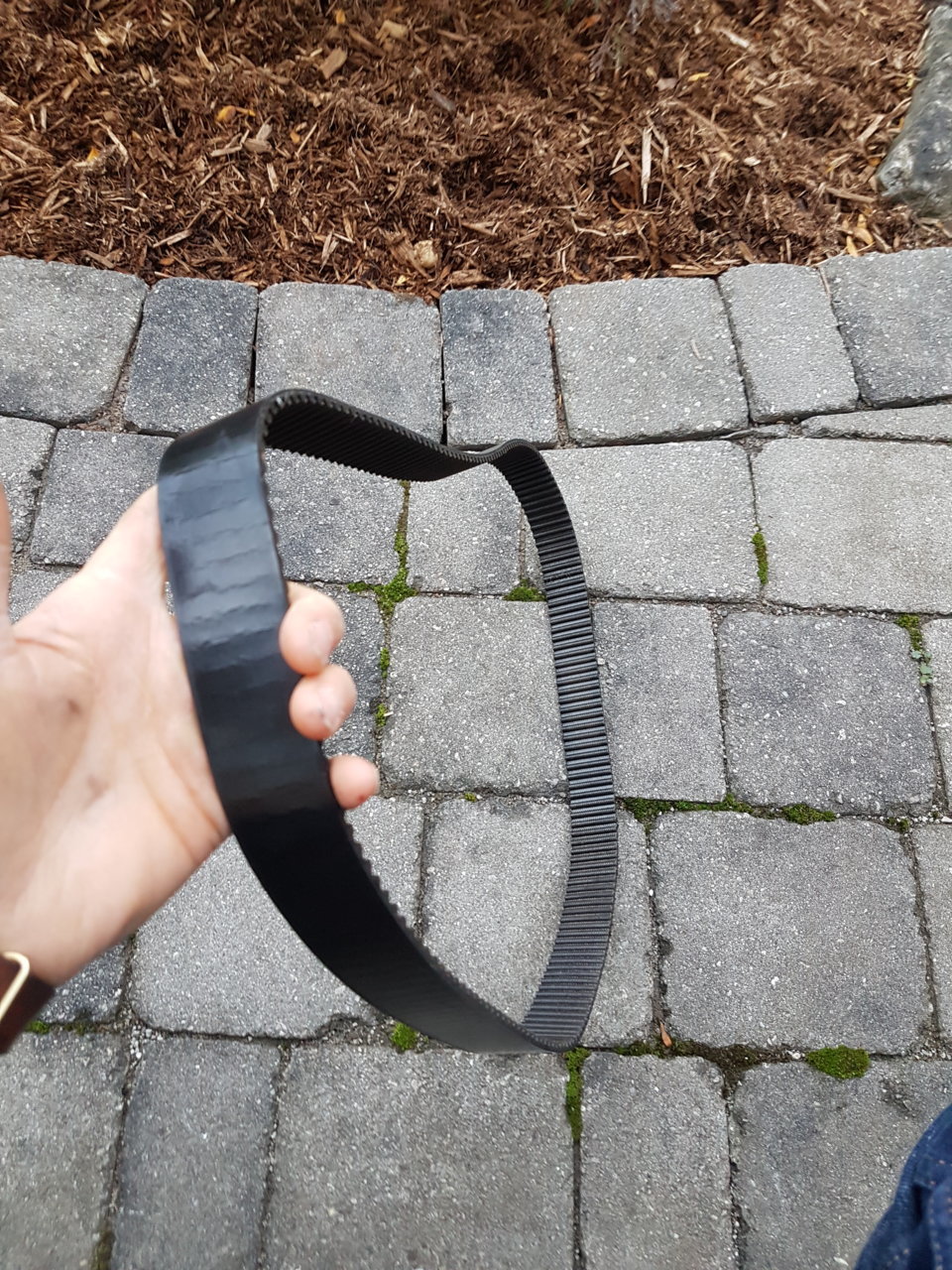

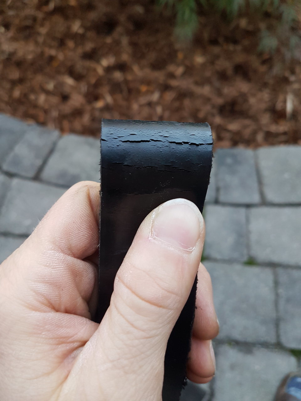

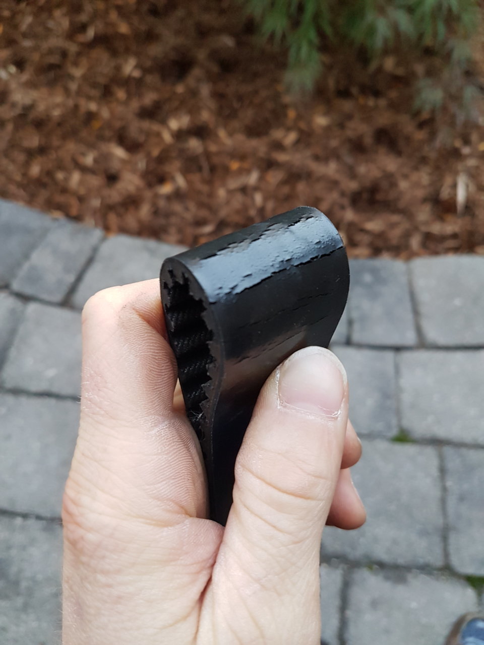

    I just changed my timing belt on my 1998 tacoma xtracab 3.4L 4x4. It has 153,000km. My mechanic said it was a perfect time to change it out since it is cracked basically every half inch all the way around. One cold morning start might have broken it. See attached pictures. Other work done at the same time was: timing belt tensioner, water pump, thermostat, alternator belt, A/C belt. Total cost was 1,000$CAD.
