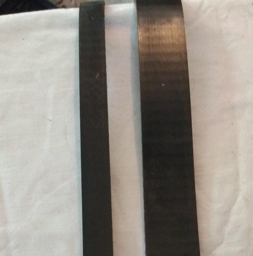

    1) Is it possible Evil Toy went 400k on a timing belt ? Possibly. The 5VZFE is a non-interference engine. So if it did brake, the engine would not be damaged I think it would depend on how fast the miles were put on the engine. I will show a belt comparison below.
    2) I have been told these things run forever but really has anyone had one break and @ what mileage? It is possible for one to break. Though no damage to the engine would occur.
    3) And are the 3.4s interference engines that destruct on failure? No.
    I need to know cause my PO replaced @ 108000. I'm @ 208,000 and planning on my 1st big trip towing 4000lbs which is going to load this puppy and require pulling some grades @ 4000 rpm!
    I was hoping to see how it goes before I put any more $ into it .?
    Honda V6 (interference engine) belt on the left compared to the Toyota 5FVFE (non-interference) belt on the right.
