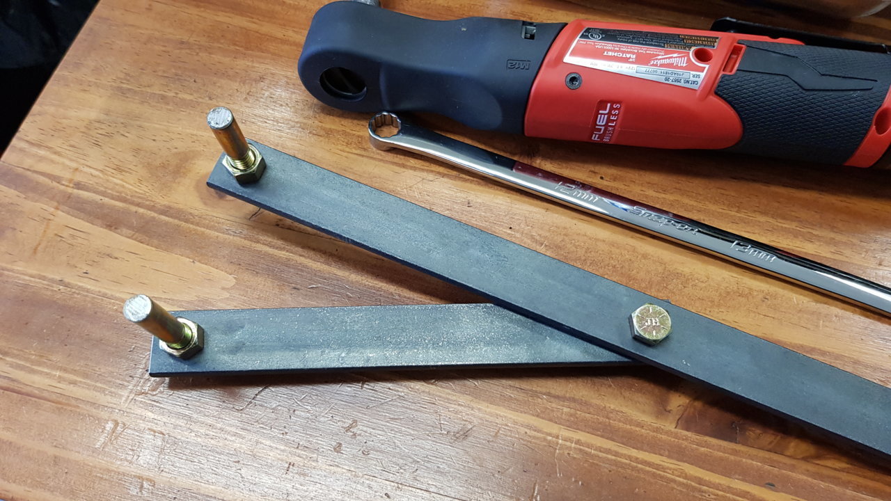

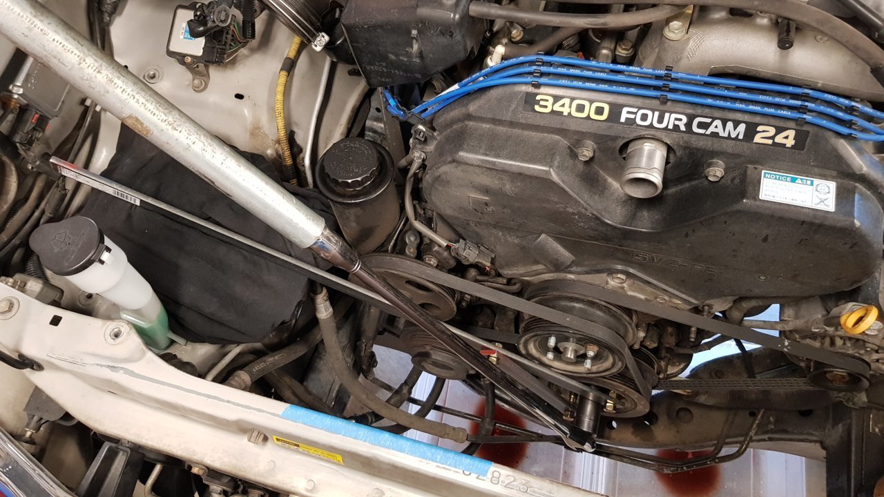

    That sucker is on tight. Neither of my 1/2" impacts (air & electric) would budge it, all they would do is slowly rotate the crank. Wasn't about to go buy a new impact for the job or the $100 tool to hold the pulley (which I would had to order online). Instead I spent $10 at Lowes and made my own.
    I took out my stock air box, layed my tool against the frame with a piece of wood for cushion. Then used a long 1/2 breaker bar with a pipe extension on it. When it broke free I though my breaker bar finally broke but nope. That Matco breaker bar has never failed me yet.
    Used the same home made tool to retorque the bolt. Again layed it against the frame, this time with the battery out. But I had to torque it from underneath the truck with my foot on the frame. When I tried to torque it from up top, my feet would just slip on my garage floor.
    Here's my home made tool. Lots of other examples in the thread too.
    https://www.tacomaworld.com/threads/homemade-crank-pulley-tool.140646/page-4#post-18172275
