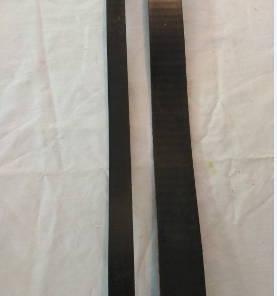

    Honda V6 Timing Belt has a maintenance schedule of every 105,000 miles or at seven years, whichever arrives first.
    Honda uses an interference engine that will be severely damaged if not destroyed when a timing belt brakes.
    Compare the Honda belt (left) to the Toyota (non-interference) 3.4L belt (right) to see the size difference.
    Which belt would you rather run?

    I've never worked on a Honda that the timing belt has broken but I'm sure it happens more frequent being a thinner belt. I wonder why they went with so narrow on the width?

    I suspect to lower the cost or to save engine compartment room. I didn't think anything about it until I saw a Toyota belt.

    Ford used to use a hefty one. Since it was a Ford I think it was considered lifetime.
    J/K but really it wasn't spoken of much. The old Fox body 2.3 4 cyl. Used in Ranger,Pinto, SVO Turbo, T-Bird. I don't think they were interference come to think of.
    Honda and Hyundai's were what I've seen trashed the most. Honda usually makes 150K or so but I have seen a lot of broken ones after that. Valves into head, cam breaks in half, pistons with holes. They're shot. Hyundai used to break them at any given time. 70K, 74K, whenever.
