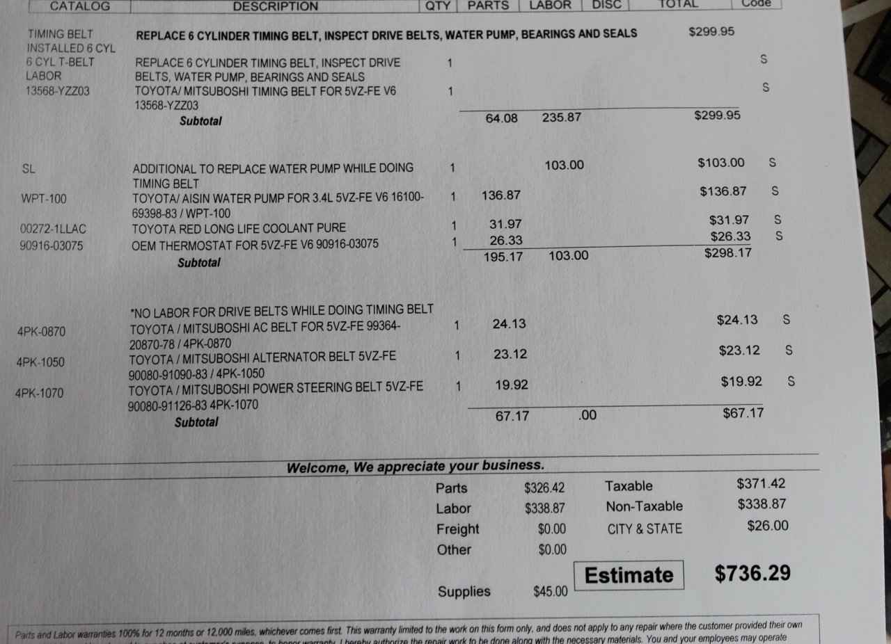

    @timmah this is the quote i got from an indie Toyota certified ex-dealer master mechanic
    include WP, thermo and all belts
    looks like a little over 2 hours labor charge for the timing belt
    parts maybe a little high though i don't know yet until Camelback fixes their website

    It cost me nearly $300 JUST for the OEM parts, and I did the labor myself.

    Well, really he's charging $340 to do the job. A water pump replacement is pretty much always part of a timing belt job. This doesn't include replacing either idler pulley, the timing belt tensioner or replacing the camshaft seals and crankshaft seal. So, it's still a good deal but not as good as I originally thought it was.
