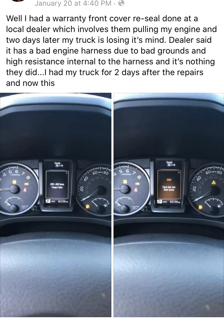

    Let it continue to seep then?

    This is the kinda thing that worries me.

    Not sure if it necessary to pull the engine for this repair.

    The dealership said they would hav to pull it, takes 3 days and cost $2500

    We usually reseal the covers on the trucks in the truck. At least the 4.0s. The 3.0 ain’t much different and I sure as hell know the cover on the 5.7 is more of a pain to do than the 3.5 and we do those in the truck too.
    Only pull the engine on fwd cars to
    Do the covers

    Pulling the engine seems unnecessary even though it can make it easier to do the actual re-seal. The extra disassembling of components may or may not have created other problems.
