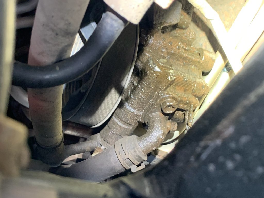

    Last night I noticed the leak collection on my PS pump. Thought it was a PS leak until I started searching and realized it's the timing cover. Based on what others describe I'm close to 100% that I'm effected too. I have an appointment with Toyota tomorrow. I bought my truck used CPO, so even though it's a 2016 with 76K miles, I should be covered under the powertrain side of things.
    Does anyone know if CPO repairs can be done at any dealer, not just the dealer purchased from? I have no relationship with the dealer I bought the truck from, and they're a lot further from my house than the one I typically use.
    I have no idea how long the leak has been occurring for. I'm terrified of how major of a job it is to perform, especially with my aftermarket bumper and winch, and various other add-ons I've accumulated over the years. I'd bet anything the tech who performs the job isn't going to put everything back correctly. How crazy would I be to leave it for now, and see if it gets worse before my CPO warranty runs out? The leak isn't dripping onto the ground (although my skid plate probably catches it), and the truck is never low on oil. I'm starting to wonder if the benefit of the repair is outweighed by the potential complications of the job itself. @Bishop84 , what are your thoughts?
  8. Jun 14, 2021 at 8:21 AM
    #308
    Rustytaco71
    Rustytaco71 Well-Known Member
    Sep 13, 2017
    #229894
    2,140
    John
    2018 4Runner
    When I had mine and it started to leak, I started the process right away as you never know when it can just take a complete dump on you. Took them a little over a week, and the repair paperwork I got back stated they pulled the engine out and tore it down and replaced every gasket as well as the front timing cover one. Definitely a big job.

    Good point. It's not like it's ever going to get better, it will only get worse. I do all my own work, I hate someone touching my truck but I don't really a choice here, especially if it's covered. The aftermarket add-ons give me pause, but I guess I'm going to have to man up and get over it.

  10. Jun 14, 2021 at 4:31 PM
    #310
    Bishop84
    Bishop84 Well-Known Member
    Dec 17, 2015
    #172494
    12,007
    Get it done now, take the skids off prior to the visit, they will appreciate it. Heck you can take off the grill if you want to and it will protect it.
    Most of us have started to do the reseal in the engine bay now, we no longer remove the motor.
    You can ask how they do it, if they do it in car and remove the rack and front diff, they should be using new fluid covered by warranty.
    Warranty won't cover a new drive belt unless its contaminated, I would ask they install a new belt that you supply.

    What about my aftermarket bumper/winch? It’s not a full bumper just a hybrid. Think they’ll hate me for having to remove that? And my fuse box /wiring through the firewall. I’d hate for someone other than me to need to remove and reinstall that. It’s not a mess but isn’t exactly going to win any awards either.
  12. Jun 14, 2021 at 4:45 PM
    #312
    Bishop84
    Dec 17, 2015
    #172494
    12,007
    Hybrid bumpers dont really interfere, its the big ass hoop/stinger bumpers we hate.
    I hate the damn huge skid plates, more than any bumper. Take it off prior haha.
    The aux harness shouldnt be affected, but they remove the engine they remove the harness through the firewall port that is on the passenger side. The other connection is the junction panel by the battery.
    Take pictures of your fenders and wiring but don't stress too much.
    The CPO will likely have to be done where you bought it from.

    Truck was at Toyota today. The tech confirmed that it is the timing cover that is leaking. They took pictures and sent it up the chain, and now they're waiting for Toyota to approve the repair. Really glad I bought certified pre owned. Even if I bought new I wouldn't be covered at this point. This is not the same dealership I bought the truck from, but they are performing the work under the CPO warranty.
    I got to speak to the senior tech who will be doing the job. He confirmed what @Bishop84 suggested; not taking out the engine but removing the diff and coming in from underneath. He asked I remove my IFS skid, but said the bumper and electrical mods won't get in his way. I definitely feel better knowing the engine isn't getting removed. He also said he's done over 20 of these jobs by now, which is also helping put me at ease. This is the first time anyone other than me is doing any work on my truck, or really any vehicle of mine since I was a teenager. I know I have to get over it but I'm glad I spoke with him. I'm also glad I found a dealership who is cool about my modified truck and willing to work with me. I'm not going to have the job done until the end of the month because I have a wheeling trip planned the last weekend of June. But once the job is done I'll report back again.
