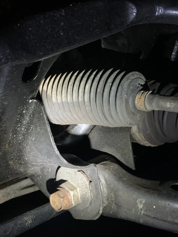

    Hey @Bishop84, when you take the cover off from underneath without removing the engine, do you have to touch the steering rack at all? I'm pretty sure my inner tie rods are shot, and I'm debating just having Toyota replace them while the truck is there for the timing cover job. The only reason I even found the leak was because I was searching for a front end noise and looking around, and I'm pretty sure the tie rods need to be replaced.

    I’ll take a picture tomorrow. I know the lower half looks wet from the outside though. My CPO is only powertrain at this point. No way the rack would quality for that, I think?

    Nope, its steering/suspension.
    Typically I don't change the inners on Tacomas, usually its leaking and requires full rack replacement. Inner rarely wear, but its possible.
    Junkhead and Bleep100 like this.

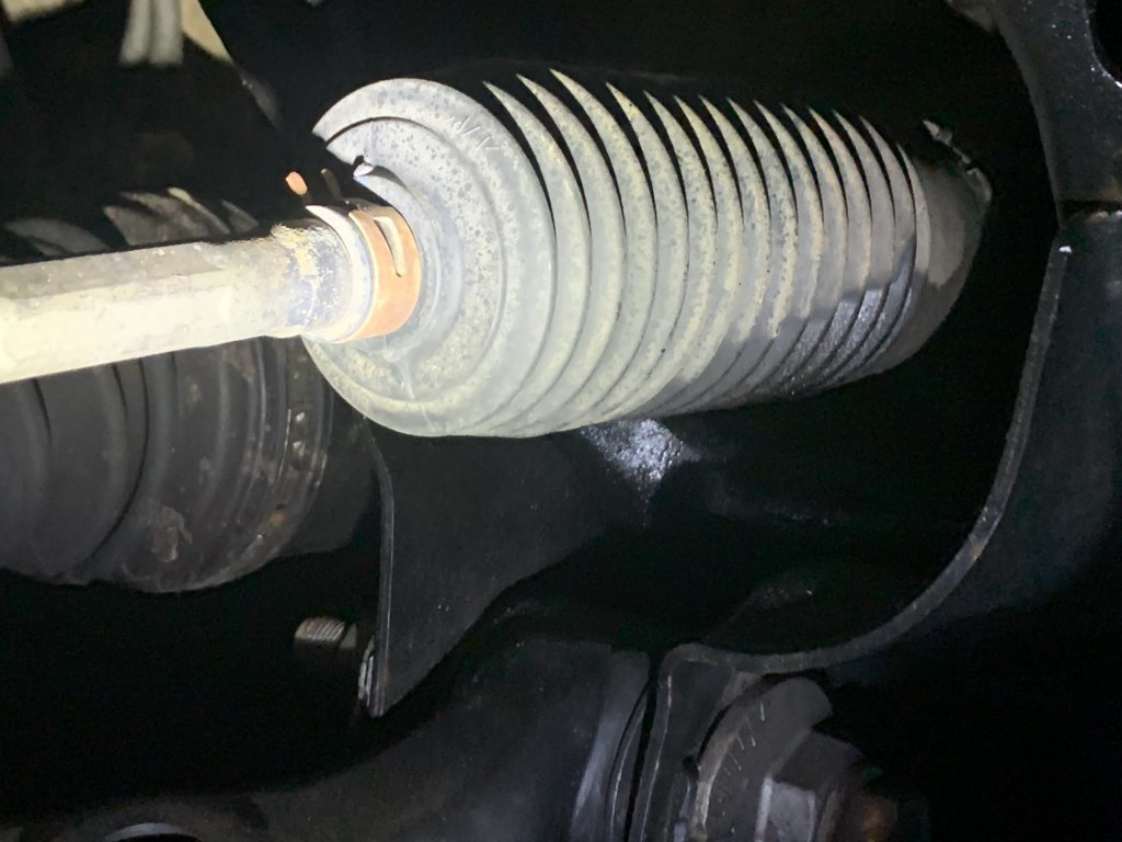

    Gotcha. I knew it wouldn’t be covered. Would a leaking rack cause a noise? I hear it when I turn the wheel while driving at low speeds, but I can reproduce the same noise with the truck stationary if I rock the steering wheel back and forth. It’s more of a low thud than anything else kind of sound. Sound is coming from the inner tie rods / rack which is why I assumed the inners were shot.

    It can make noise but not likely.
    I'd have them change it, supply a new one and ask how much to have it changed. Usually its 3 hours, so it should only be .5 to replace and swap over parts during the process.
    You don't have to remove it, but its a bastard unless you take it out.
    CrufflerJJ and Junkhead like this.

    Ok thanks. If they're gonna be half way there during the other job I'll definitely have them do it at the same time. If boots show the leak like mine do then the rack is definitely shot?

    Not shot, but worn, and it wont get better over time.
