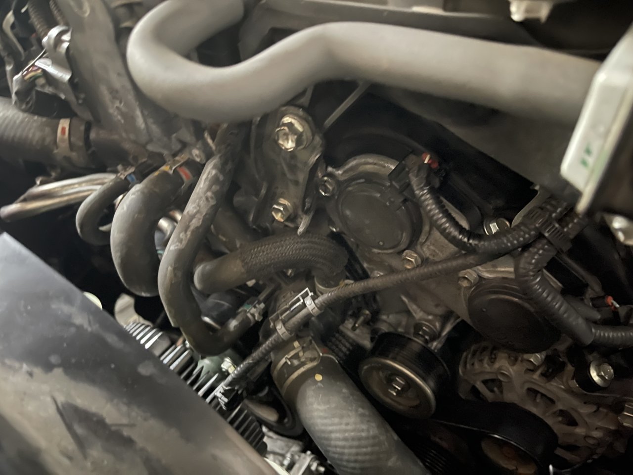

    I let my 2017 ride with the known leak for at least the last year, keeping an eye on it. Dropped off yesterday morning, truck was done this afternoon. Time will tell how well the job was done, but everything seems to be running ok. Attaching photos of the service order as well as photos of my engine bay.
    Seems most of the hoses have been relocated and bunched up in the front - with a few things too close to the fan for comfort IMO.

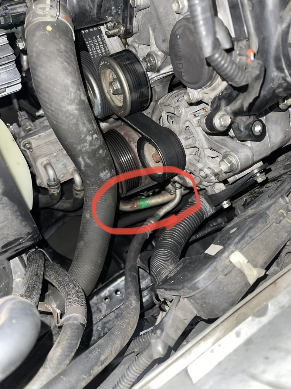

    looking under the hood after driving it home from the dealership, noticed some fluid or perhaps condensation on the line circled below. Could obviously just be a mess left over from the job (surprised they didn’t clean the engine bay…) but should I be worried at all?
    that aside, the experience with the dealership was better than expected and they got my truck back quickly.
    also thought I had a bad lower pulley - turns out it was a loose exhaust clamp making the squealing pulley-like noise…

    Clean it and keep an eye on it, i wouldn’t sweat it. As you said it appears to be a mess left from the last leak!
