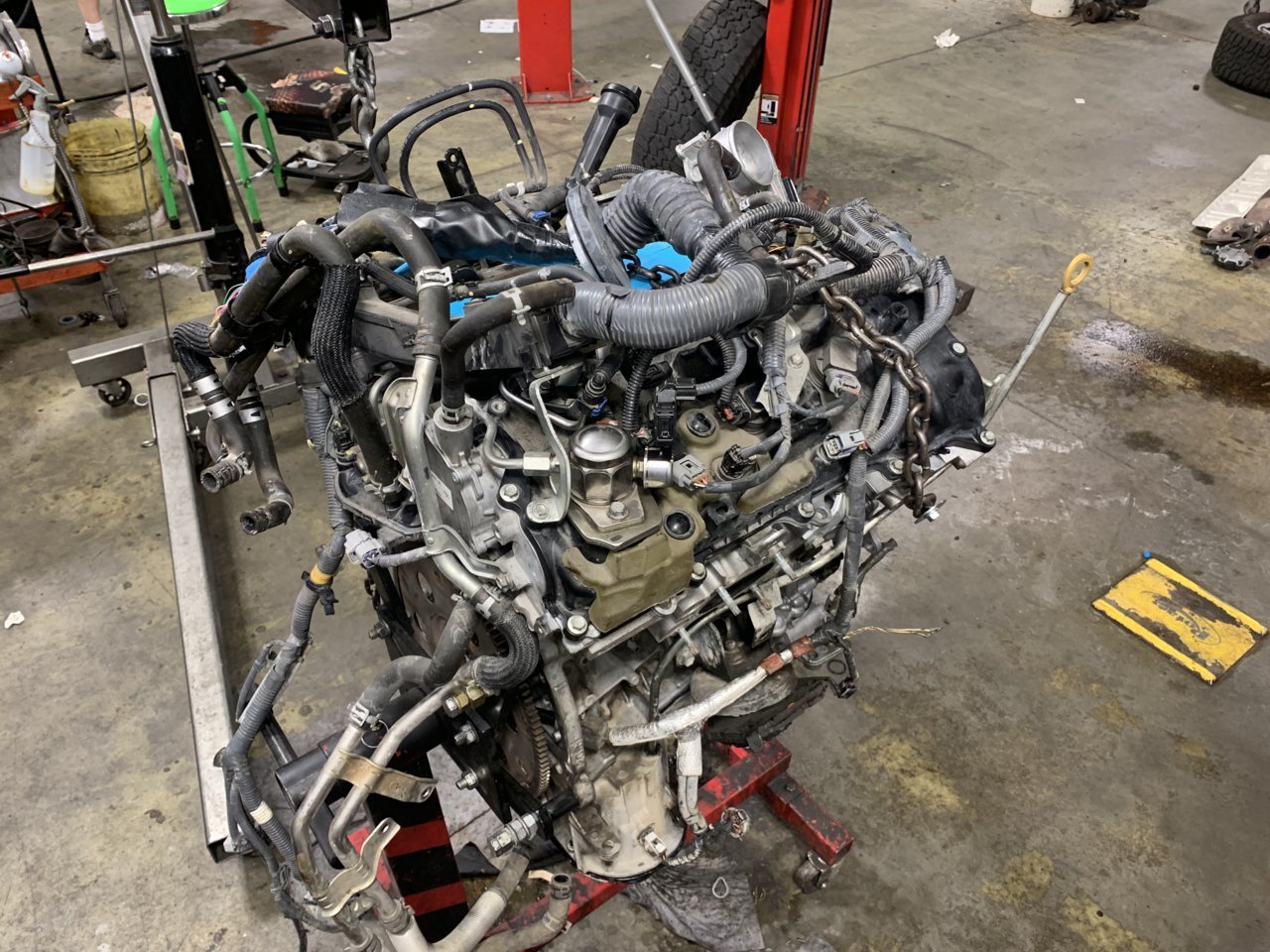

    Welp - Some issues have started to surface a couple of months after having my timing cover replaced. Finding loose wiring harnesses, some clamps have come loose, and I've got a ton of engine vibration that feels like engine mounts that wasn't an issue before. Still not leaking and no CELs so fine on that front but the engine is far from smooth now unfortunately. Previously the only time I'd feel much vibration in the cab/steering wheel was on the highway going 70-80 in the 2k RPM range. Now it's all the time and I've got rattling noises at idle I didn't have before...
    all depends on the mechanic and dealer, I'm sure, but to echo others... Mine had been seeping since new, of that I'm sure. There was faint oil smell from the grill/hood which I called out to a dealer a couple of times and was told no issue. Eventually it has seeped enough to be collect plenty to be visible, my CNA warranty covered all but $100 of it and I had it done.
    In hindsight, I wish I'd have just left it be. Now I'm chasing gremlins (again)!

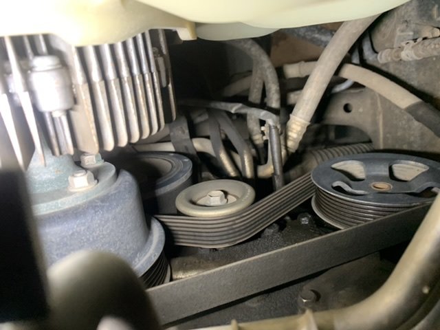

  14. Sep 20, 2021 at 9:24 PM

  15. Sep 20, 2021 at 10:40 PM
    #395
    Beerpayzdabillz

    #193169
    1,528
    Nor Cal
    2016 DCSB 4x4 sport
    Disclaimer: I'm no expert.
    But, that is way more build up than mine had when Toyota repaired it.

    477
    Jen
    Summit County CO
    16 Tacoma TRD OR Access Cab, 03 4runner v8
    Yeah it seems like a lot... I haven't lost any noticeable oil volume on the dipstick between oil changes either. I'll keep and eye on it until I can take it in

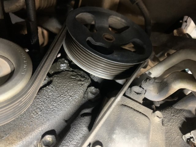

  17. Sep 21, 2021 at 6:25 AM
    #397
    littlefish
    littlefish Buzz, your girlfriend...
    Sep 13, 2018
    #266147
    2,021
    Hudson Valley NY
    2016 TRD Off-Road DCSB
    The one who dies with the most stuff wins.
    That's way less than all the oil that was caked onto my power steering pump. Yours looks much more like what Toyota might try and call a seep. And after reading all the reports here you might want to wait to address it. I had mine done but I'm always waiting for it to come back. What mine looked like. 2016 with 75K miles.
    jgr81[QUOTED] likes this.
  18. Sep 21, 2021 at 7:03 AM
    #398
    jgr81
    jgr81 Well-Known Member
    Feb 8, 2016
    #177511
    477
    Jen
    Summit County CO
    I need to take a few more pics so I can keep an eye on it... that looks worse for sure. My engine bay is muddy and needs to be cleaned, so I was tempted to clean that area up to watch it but I think I'll leave it alone until I have them check it out. I need to look at it from the angle of your pic it was dark when I noticed it last night
  19. Sep 21, 2021 at 7:10 AM
    #399
    littlefish
    Sep 13, 2018
    #266147
    2,021
    Hudson Valley NY
    Yeah the typical place for the oil to collect is the PS pump. When I brought it to Toyota it took the tech 3 seconds of looking there to confirm what I told the service desk. I find it better to go to the dealer and tell them the issue, rather than just say "I think it's got an oil leak."
