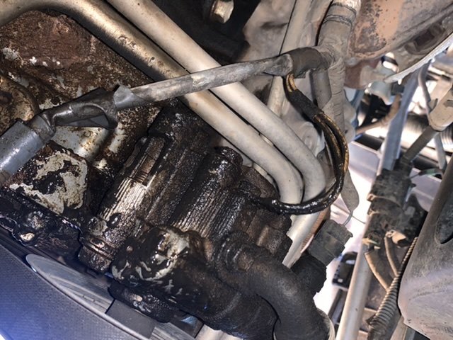

    Sacramento
    16 TRD 4x4 OR
    At 125k miles and just saw the power steering pump covered in oil during a recent oil change. The rear main seal has been leaking for the better part of 20k+ miles (thought it was the lower oil pan). Not sure whether to tackle these, let them leak or sell it whole and buy a newer one...
  10. Feb 22, 2022 at 1:17 PM
    #410
    TacoedBars
    TacoedBars TacoedBars
    Jul 30, 2019
    #300737
    113
    Sacramento
    16 TRD 4x4 OR
    Yikes, I'm in the same boat. Don't want payments anymore but don't want to spend $4k+ for another leak in the future.
