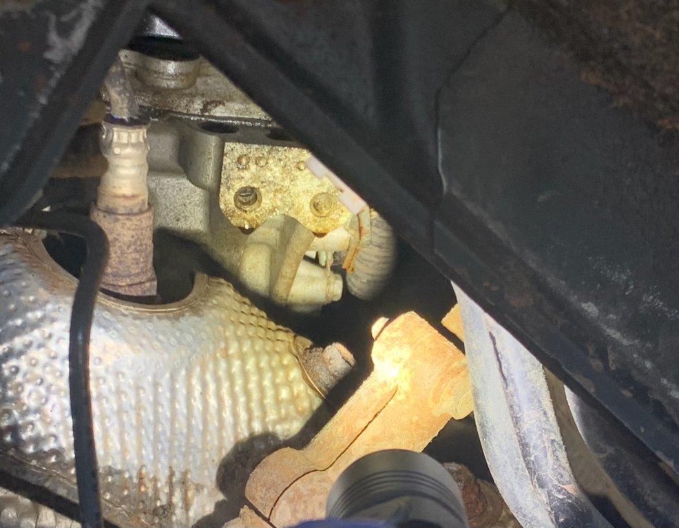

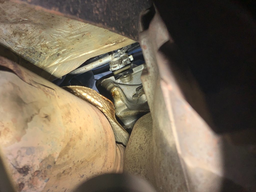

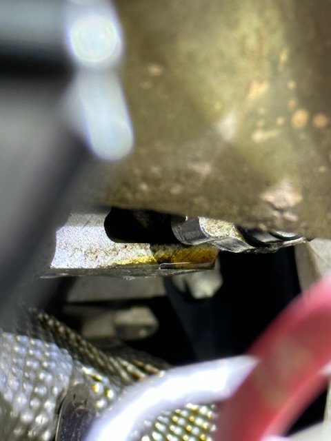

    littlefish I'm following in your footsteps unfortunately...
    Over a year ago I found what I thought was timing cover leak... took it in and they replaced PS pump since fluid was low. I had a feeling it was still the cover but it's under warranty so...
    Anyway of course leak came back and had the timing cover resealed maybe 3 weeks ago. And they threw a new steering rack in since that is why the PS fluid was low. I live 90 minutes from the dealership and got home and engine bay is covered in coolant...coolant overflow is low, ps fluid was low, front diff breather wasn't attached so gear oil everywhere. Loose brackets etc. clamp missing on the coolant line to the throttle body sprayed coolant all over engine. I fixed all that stuff and just figured the engine smoking after driving was burning that crap off.
    Today I was finally able to get in and figure where it was coming from - looks like I also have a leaking valve cover too smh. Oil dripping onto the exhaust right there on driver side back of the engine. I cleaned it off last night with brakekleen and it's back today.
    Bishop84 - does that look to be valve cover leak to you? I didn't take a pic from the bottom but it looks like the pic littlefish posted.
    I dread taking this thing back down to Toyota - hope the damn thing doesn't go up in flames on the way down
    Thanks for all your help!

    Yea looks like a valve cover leak.
    They are a huge pain in the ass to do, so there's always a chance for error. It's one of the benefits of taking the engine out. (Which I never do anymore)
    Hopefully its a smooth process to fix.
    jgr81 likes this.

    They def weren't stoked to have to do it, but it sounds like they've had to do quite a few. I think they came from the bottom/front instead from what I can see has been messed with. Oh and the front diff drain plug is stripped now too lol
