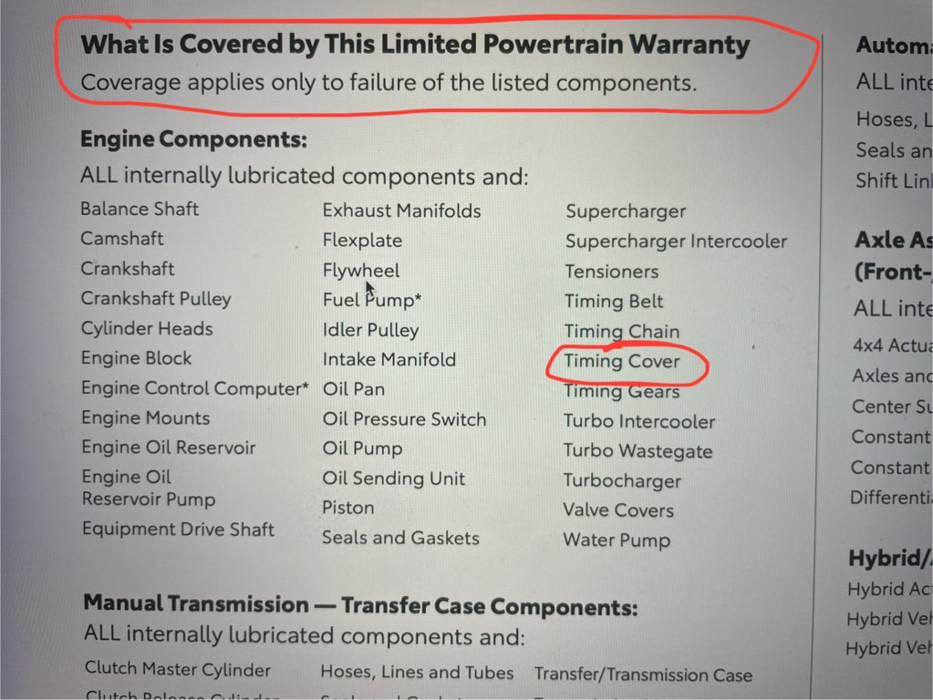

    2022 Lunar Rock TRD Sport

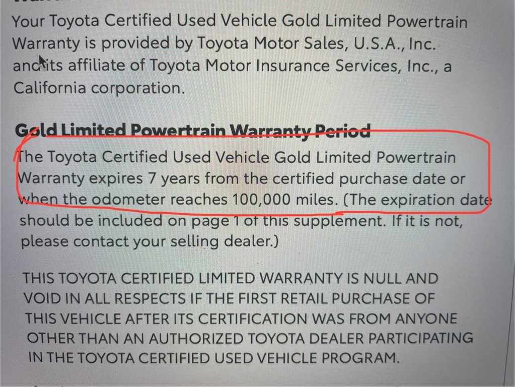

    That is not correct and they are screwing you if they told you that…
    This is right from the official CPO warranty
    supplement….if you are within 7 years from the date of purchase as a CPO vehicle, AND, your clock says less than 100k miles, you are absolutely within the CPO powertrain warranty, which by the way, the guide specifically mentions the timing cover as a covered item.

    #266147
    2,021
    Hudson Valley NY
    2016 TRD Off-Road DCSB
    The one who dies with the most stuff wins.
    Shit you had me excited. I ran up to the filing cabinet to check my papers. Looks like the gold warranty is seven years from purchase date, but the certified pre owned warranty is seven years from original date of service. It’s funny how when Toyota did the job last time they billed $2100, but now that it’s out of pocket it’s $5,000.
