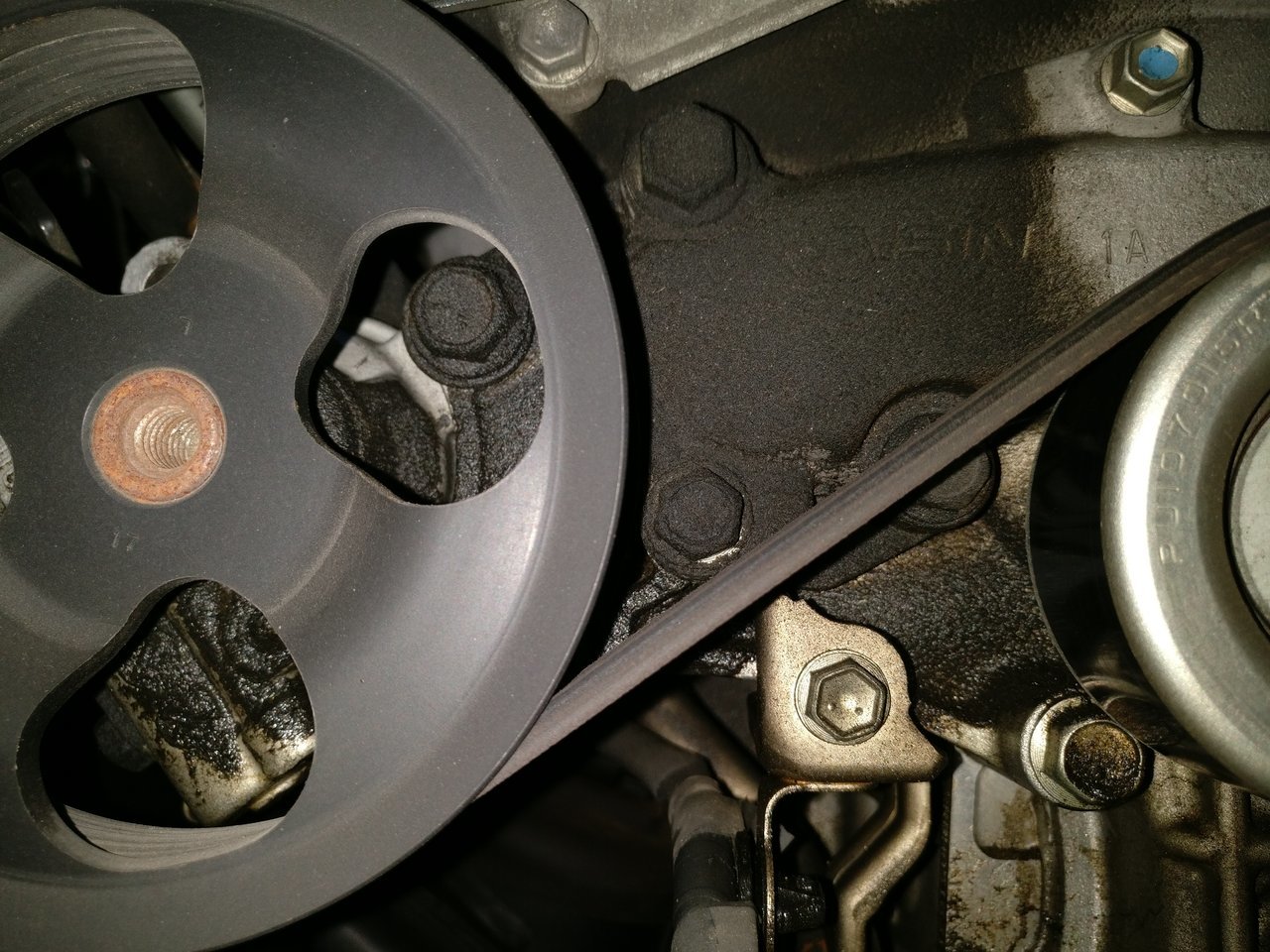

    2016 DCLB TRD Sport

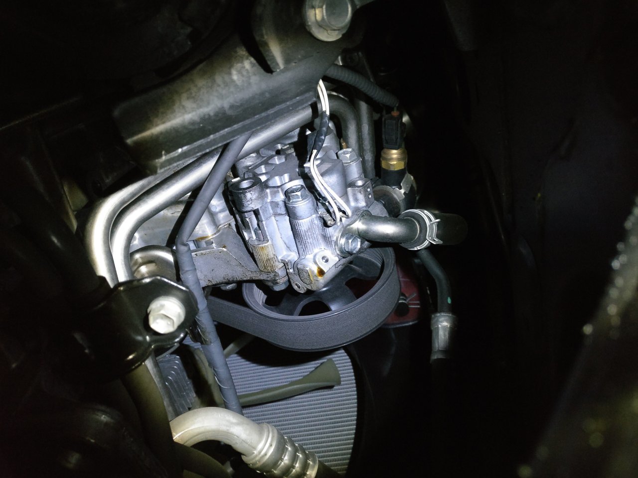

    Disclosure: I'm actually quite happy with my 3rd Gen.
    One more for this issue though. Was underneath doing an oil change and saw this accumulating on the bottom of the power steering pump. Took it into the dealer today to have a look and they said the same thing - leaking timing cover gasket and will need to do a lot of dissassembly in order to replace.
    Keep an eye out for something like this to see if anybody else's trucks are having this problem.

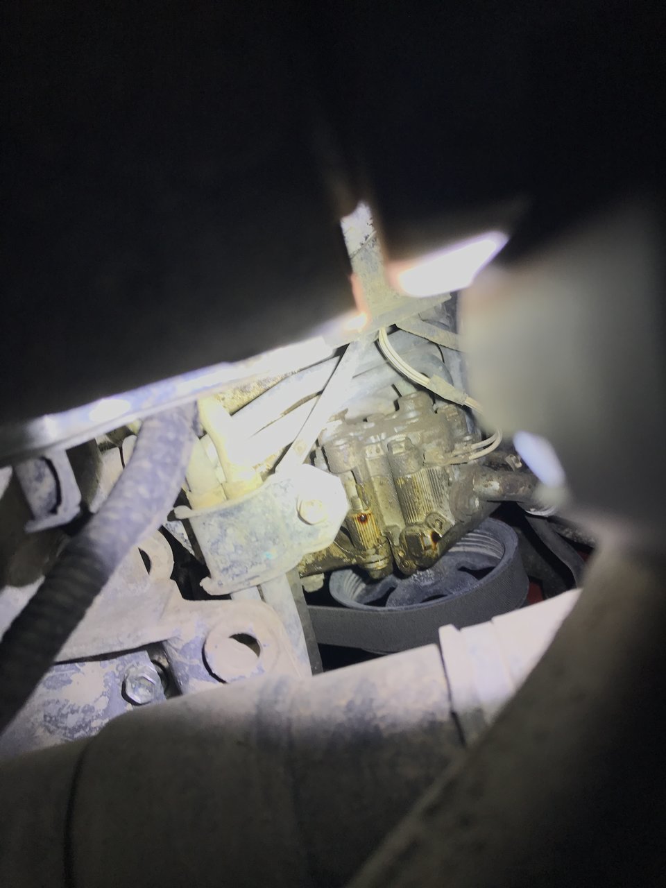

    Texas Taco 48
    Texas Taco 48 New Member
    Dec 1, 2017
    #237394
    2
    Tim
    2016 SR5
    Texas edition
    I just bought my taco a week ago and I'm coming across this same issue. I took it into the dealer today and they said it's a 16 hour job to fix instead of the 8 hour job on older tacomas. All he could tell me is that it's a problem with the seal or gasket on the timing cover and that it will be a couple days before I can get my truck back.
    I have the same pic as bryanjoh and also a pic of the front of the power steering flywheel. There's a ton of black gunk at the front of the timing case from dirt accumulating on the wet areas and you can't see it unless you are really looking for it.

    Make sure you ask them to clean the timing cover, especially if it looks like mine in the above picture. I asked too late and all I got was a standard "they sprayed solvent on it, sure it's clean" but it's really not clean.

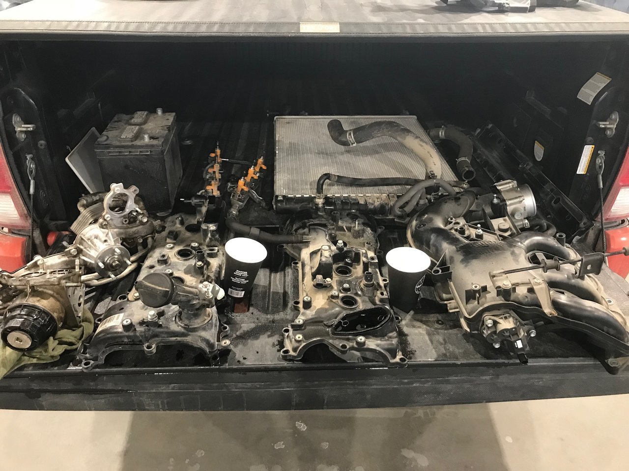

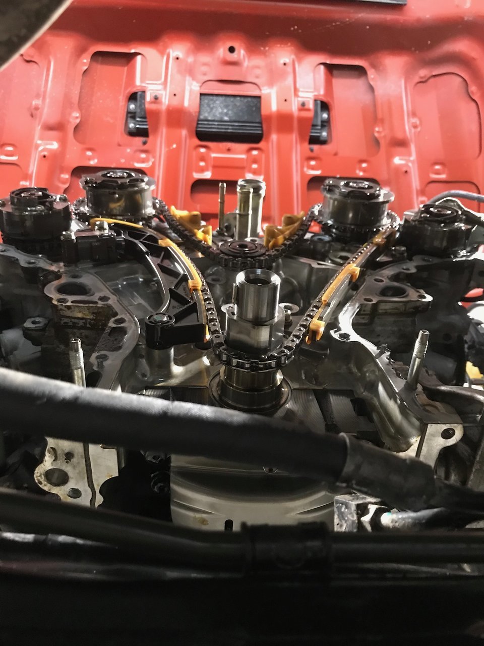

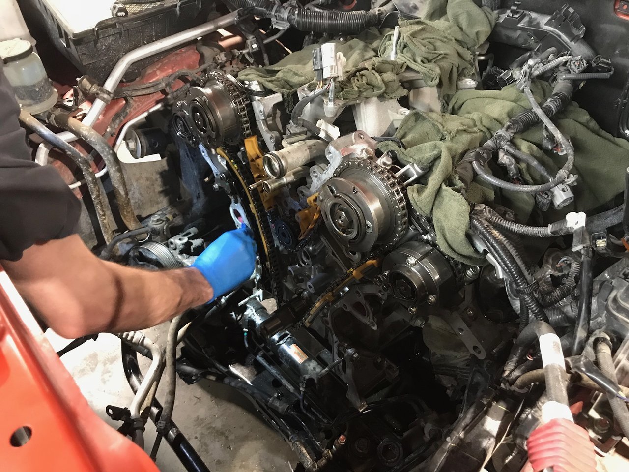

    bryanjoh
    bryanjoh Well-Known Member
    Jan 21, 2016
    #175612
    272
    Bryan
    Calgary
    2016 DCLB TRD Sport

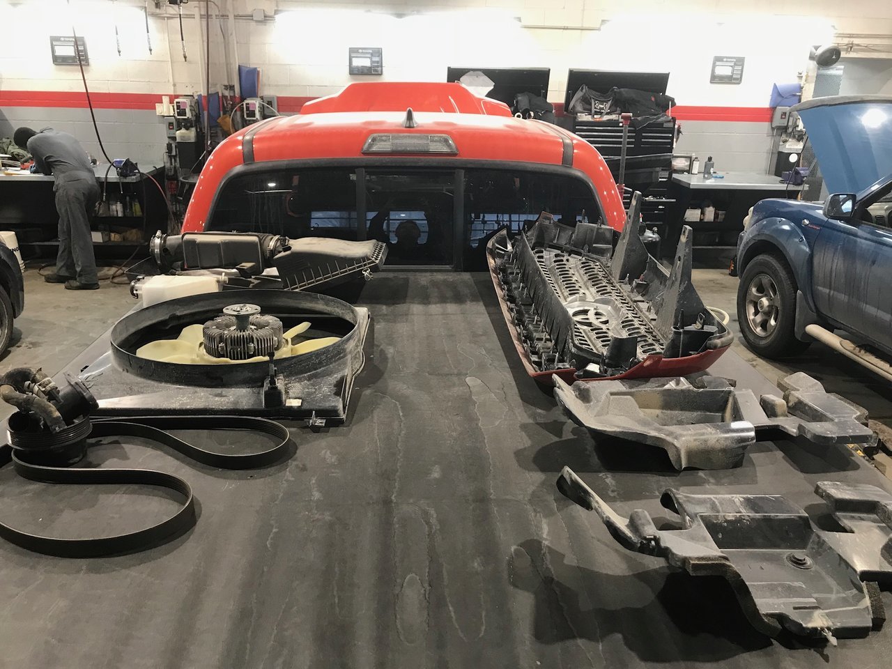

    So I went in to get my leak fixed. The tech provided a bunch of pictures of the process. Looks like an enormous job to replace a minor oil leak.
    There's definitely a part of me that worries this disassembly/reassembly could cause more problems than it solves... but I suppose we are supposed to trust the professionals.

  13. Feb 5, 2018 at 3:35 PM

  14. Feb 5, 2018 at 5:03 PM
    #54
    Burns
    Burns Excellent Member
    Jun 19, 2007
    #1871
    3,954
    17 DCSB Off-Road
    Bilstein 5100's @ 2.0", Wheelers 1.5" AAL, 265/75/16's
    Holy crap that is a lot of work.

  15. Feb 5, 2018 at 5:04 PM
    #55
    EdgeCrusher
    EdgeCrusher Well-Known Member
    Feb 14, 2017
    #210532
    998
    Chicagoland
    '16 OR DCSB Fully Loaded
    Think when they work on a Camry they put everything in the trunk and on the trunk lid?

  18. Feb 5, 2018 at 6:38 PM
    #58
    The hammer
    The hammer Who’s the Wrench?
    Mar 7, 2016
    #180475
    3,880
    '16 Tacoma SR5 4X4 DCLB TSS Pkg 17X8" BSW-Cooper DIscoverer AT3 4s P265/65/17
    Underworld Flex trifold, tinted, TRDPRO grill, TRDPRO shift knob, etc,etc
    WOW!
    That is way too much disturbance for a simple timing cover that shouldn't leak in the first place.
    Sorry to say it cause I do like the way my truck performs and so far its great, but were this to happen to me, it be traded.
    I would not want any future problems that are likely to crop up as a result of all that disassembly
    That is dumb, who would want to deal with that expense at 130k??
    I could see replacing a cover that requires 4-6 labor hr at a shop on an old truck, but this much work on one makes no sense to me and it turns it vehicle into a throwaway, not a keeper.
    Shame,
    shakerhood likes this.
