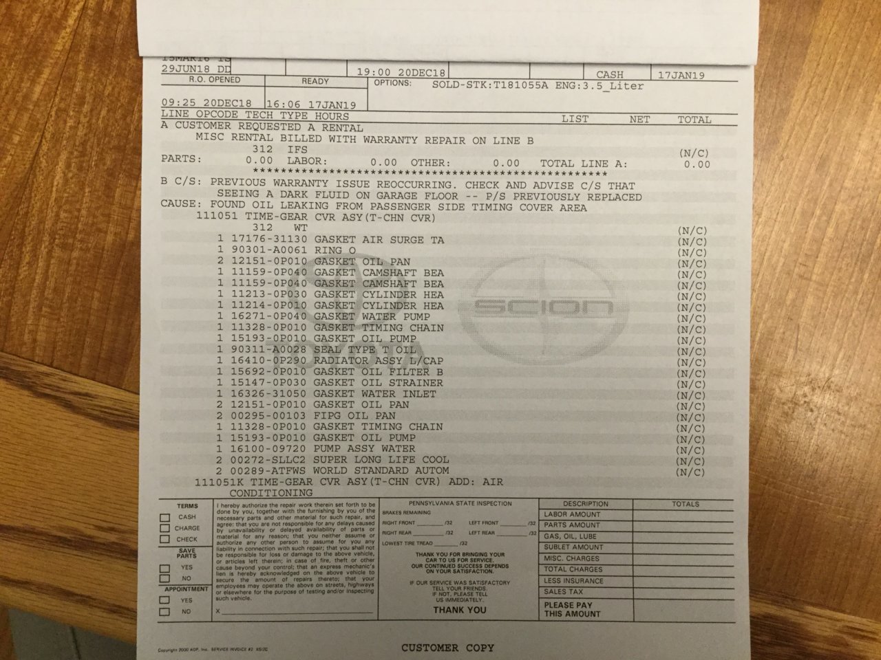

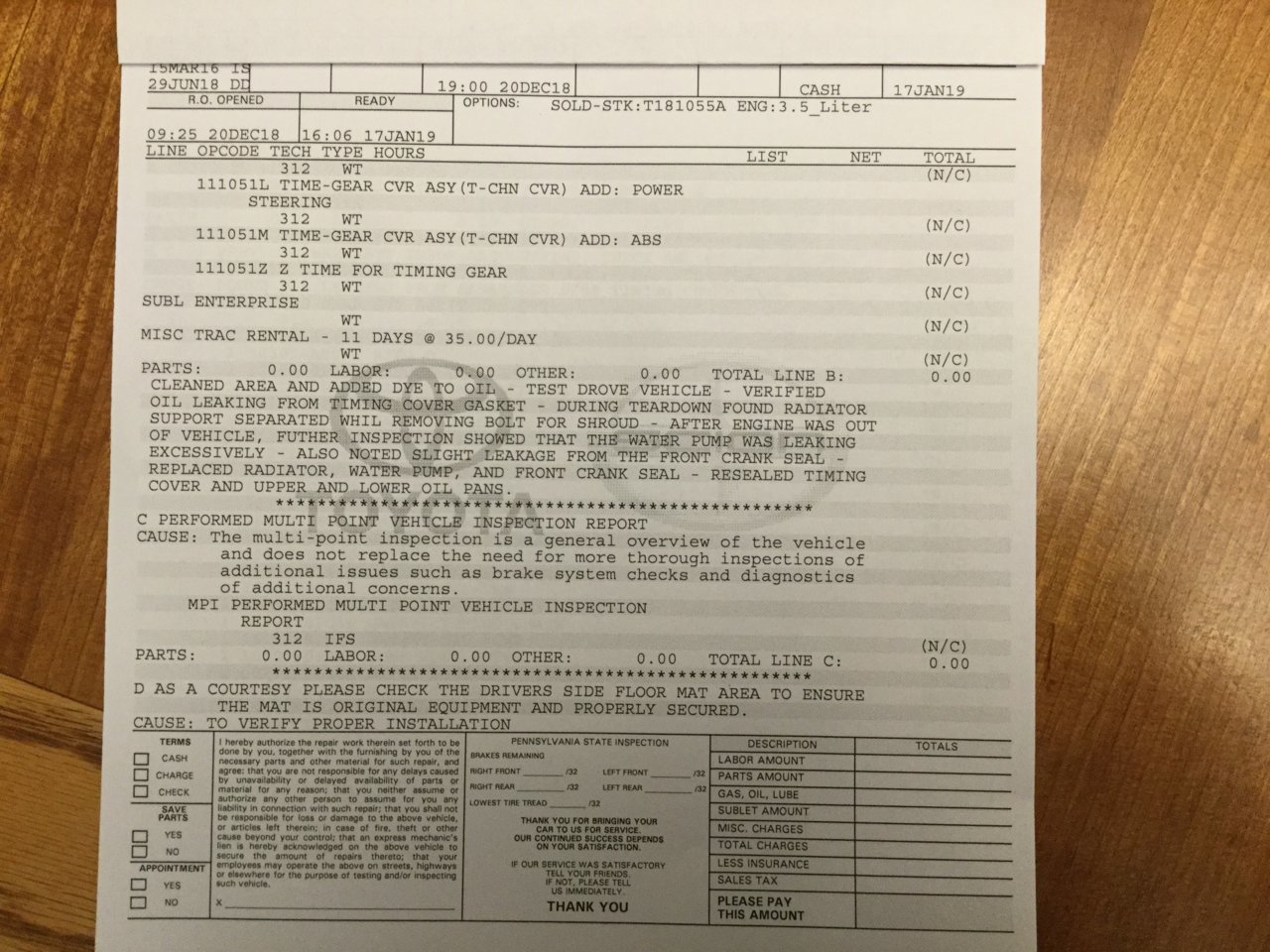

    Curious what method they use on yours. Went to check on my truck yesterday and it was in three pieces. Frame and bed on the floor, can in the air and motor sitting in front of the truck. There were a bunch of parts scattered around. I was surprised with what I saw.
    Hopefully I’ll have it back tomorrow.
  14. Jan 17, 2019 at 2:50 PM
    #94
    captainh00k
    captainh00k Well-Known Member
    Oct 6, 2017
    #232218
    209
    Pittsburgh, PA
    2023 DCSB
    Picked it up today and all seems normal. Attached is the invoice if you’re curious.
    shakerhood likes this.
  15. Jan 17, 2019 at 5:08 PM
    #95
    tacolab
    tacolab Member
    Apr 5, 2016
    #183411
    21
    Wisconsin
    2016DCLB4*4 sr5
    3 times out and in, new timing chain cover, 3 weeks later and done.
