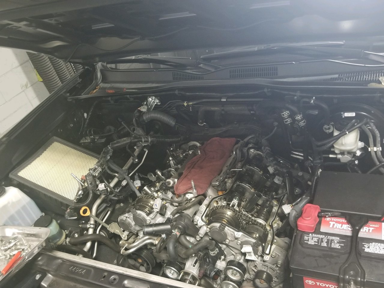

    Bro your profile picture is fire, sick setup there. I purchased this truck used and got the extended 100k warranty for 1,000 bucks. So glad I did now. Well I have 1 pic, looks like they didn't have to pull the engine. You may be in luck with the bumper 20190308_153348.jpg

    Yup, your truck Is officially badass! Love the setup. Well mine will be Done supposedly tomorrow. If I have any issues from the repair il post it here and let you know. I have a warranty for along time so I can keep bringing it back it's not a big deal for me. I thought about not having it done as well but I just think it's crazy to have an engine oil leak on new trucks and maybe if more ppl report it and have the work done Toyota might actually fix it at the source.

    I have a 4x4 and the engine wasn't removed for this repair. It took 3 days of labor once the parts arrived and I've had no issues since. If it's free let them fix it.

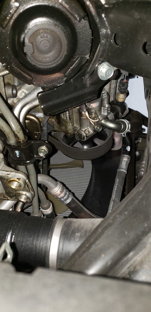

    You will definitely see the oil leak coming from what looks like the pulley from
    The power steering pump. You’ll also
    Be able to see the oil leak from the left side of the engine if you’re looking from the top side of the engine down. And looks like it’s beeb there for a while so I’ll
    Be complaining as to why the techs have not spotted this sooner?
