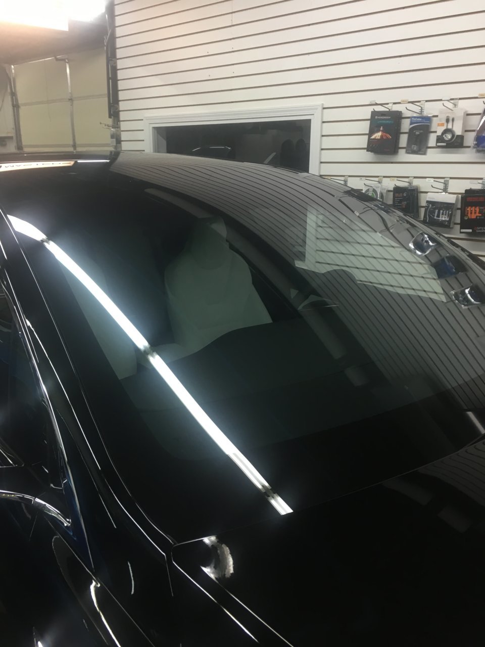

    You done a model x windshield yet? Haha took us about 2 hours to heat shrink the fucker.

    Nice! Where do you put the registration sticker at?

    We don’t, MO doesn’t require a registration sticker. You’re “supposed” to have your inspection stickers on the windshield but I’ve never heard or personally had issues for not having them.

    damn! nope haven't done one of those yet. we have done a couple Model S' but not the full windshields. another tough one believe it or not is the 2012-2015 Dodge Ram windshield. the top corners are a biiiaaatttccchhh. we tint a lot of truck windshields though. probably the hardest windshield we ever tinted was a Mercedes Sprinter Van that was being used as a limo. had to do it in sections because the windshield was so big.

    Yeah idk what’s up with those dodges binding at the corners, old saburban/silverados are the same way, always get some crispy edges. You guys don’t get 60” rolls for stuff like that?

    nope, we never need anything larger than a 40" roll. so we didn't order a 1/4 roll of film just for one windshield. the customer was happy the way we did it. it didn't look too bad honestly. we have done several RV's the same way so it looks pretty good.
