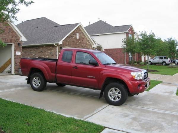

    Ok, so here is what my truck looks like with the stock tint...
    ...and this is what it looks like now, after a 30% on the windows and a 6" strip of 20% on the windshield...
    The first picture was taken at 9:30 this morning, and the second was taken at 11:30. It only took the guy 45 minutes to do it, and he did an incredible job. It actually took me longer to drive there and back than it took him to do the job! I gave him an extra $30 which makes it almost as expensive as going to a shop, but, eh, it's Easter Sunday! Anyway, anyone in Houston that needs a tint job, I know who to call!!!:D
