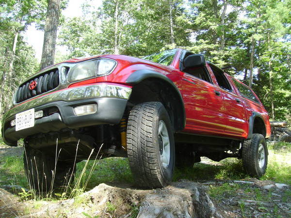

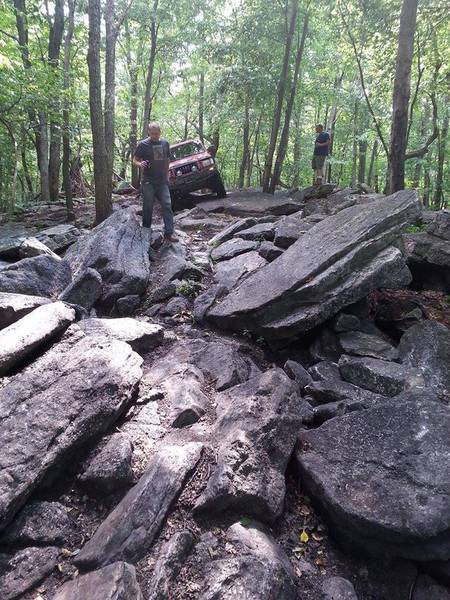

    Well, I finally decided to start a build thread for my baby, the "Rad Baron", a 2001 Toyota Tacoma v6 DC TRD.
    How it sits today: 4/11/15

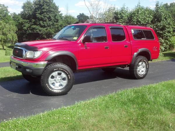

    My old '97 xtra cab was bought back from Toyota Corp. in July of 2011 (after only owning it 8 months) and I immediately began searching high and low for a replacement.
    After about a month long search, and taking a look at a few duds along the way, I finally found what I was looking for, a DC v6 TRD.
    The PO had taken really good care of this truck both inside and out, and despite having ~130k miles on it I felt it was a really solid deal @ $10,5; so I hopped on a train (With Toyota's check in hand!) and drove it home back to NJ..

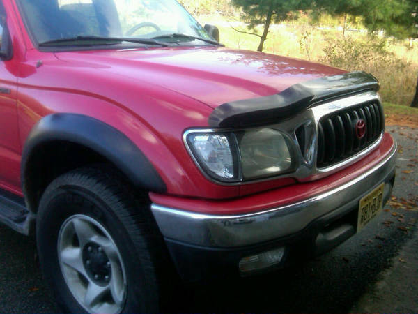

    First things I did was swap over some of the things that I took off my '97 like the deck plate mod, head unit, Sirius Radio (have since hard wired it), Magnaflow 18", and Thule Track roof rack for the cap.

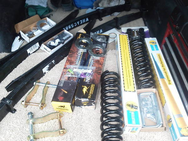

    By now.. the mod bug had hit and I decided to lift it.
    Wheelers 5 pack, 1" Toytec shackle, greasable main eye, 5100s out back, Nitro Sports in the front, the 10mm lift enhancer, 1" Diff drop, and a set of used 881s that I scored in the B/S/T
    BOY did that lift her up! (Also got Sock'd around that time too..)

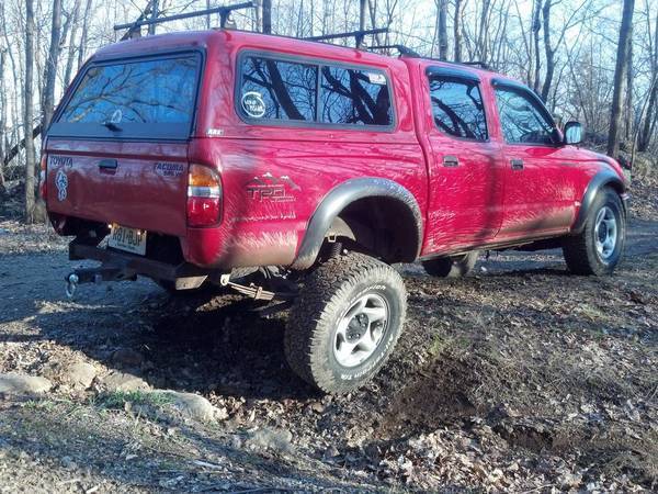

    Naturally, it was time to flex it out

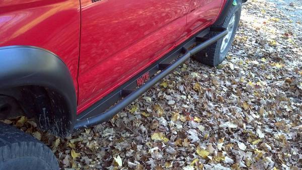

    spending a bit more time off road, and really wanting to push the limits, I figured that some armor should be my next investment. Got in on a BAMF slider GB, wanted the bold ons b/c at the time I had no access to a welder, and went w/ the kick-outs b/c of shit like this..vv install thread here: http://www.tacomaworld.com/forum/1st-gen-tacomas/298121-bamf-bolt-slider-install.html
    prepped and painted
    and got them mounted... even my Wife likes them!!!
    I have been absolutely thrilled with Jerry's product quality and design. They fit the truck perfectly, look baller, and have held up to a pretty good amount of abuse. :thumbsup:

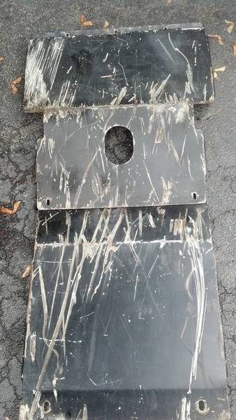

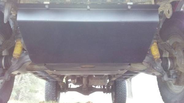

    Moar armor was in store!!.. RAT skids (IFS & Tranny) and a Sky Mnfg. elocker skid

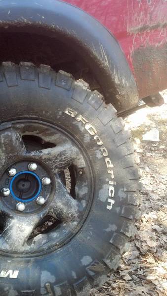

    Got a good deal on some BFG 255/85/16s and mounted them on my old wheels

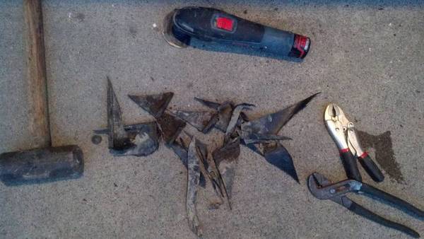

    did some trimming!

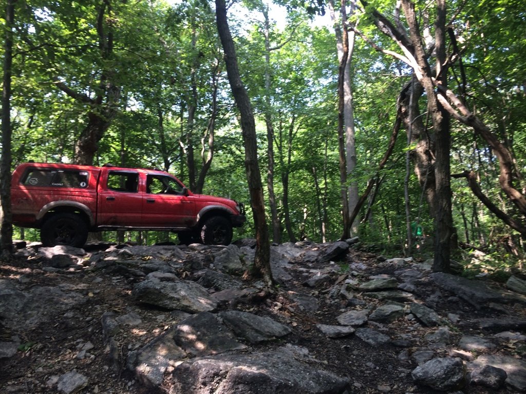

    a bunch of TW guys were having a meet @ Rausch Creek and I figured why not get some LCA skids last minute before the trip.. Thanks Jerry for the quick shipping!
    [​IMG] they def did their job on Trail 13!!

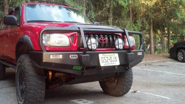

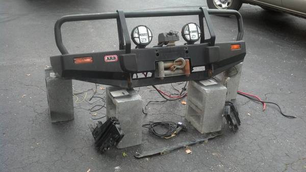

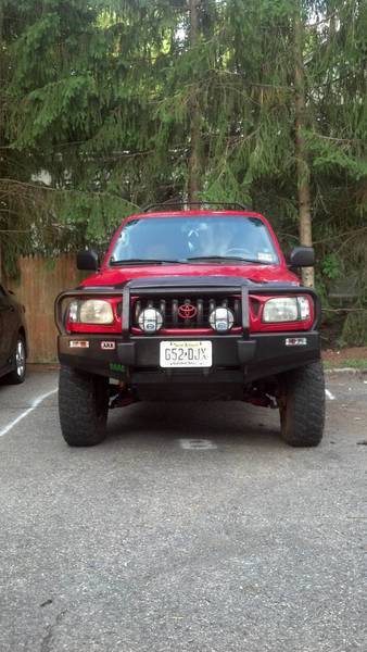

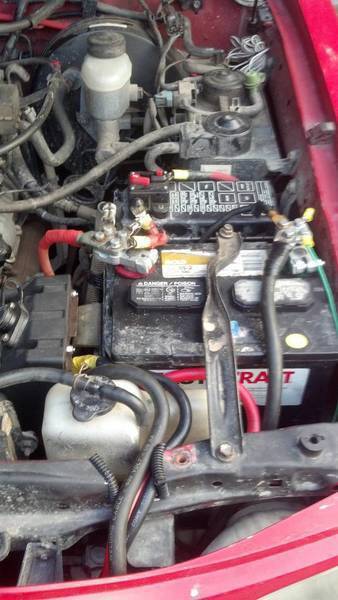

    Back in May I scored a used ARB bumper, Superwinch EP 9.0, and 883s that a local guy was selling off his rolled '01 xtra cab. got a super deal!! Took a couple months to 'refurbish' everything; sanded and painted the bumper, rebuilt the winch, found some super sweet clear lenses for the bumper, installed some Daystar poly rollers, had a dude do the end cap mod that I fabricated (more on that soon), remote mounted the solenoid, installed everything, and wired it all up to my liking!!
    heres how I got it..
    wired up
    how it looks now!
    The signal lights are for a 1981-89 VW Golf/Jetta Euro model SMALL bumper. they fit perfectly and also have 2 bulbs in them which I wired independently to serve as parking lights (168 clear) as well as blinkers (7507 amber) (also did the fog light fod waay back when) heres a link for anyone interested .. http://www.ebay.com/itm/400413005382?ssPageName=STRK:MEWNX:IT&_trksid=p3984.m1497.l2648

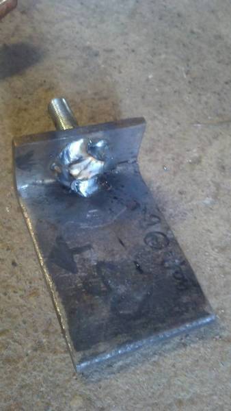

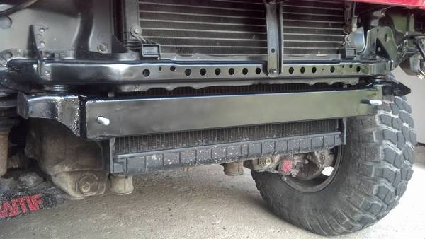

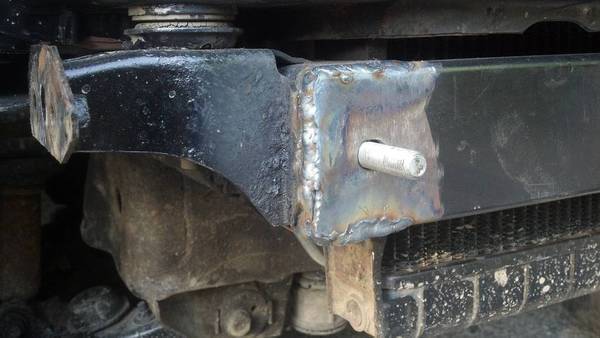

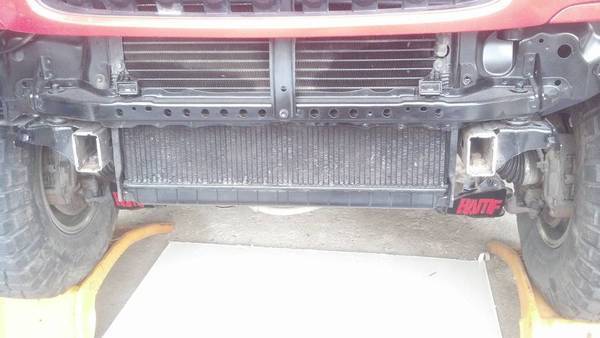

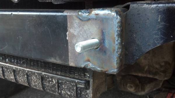

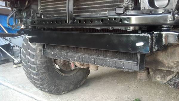

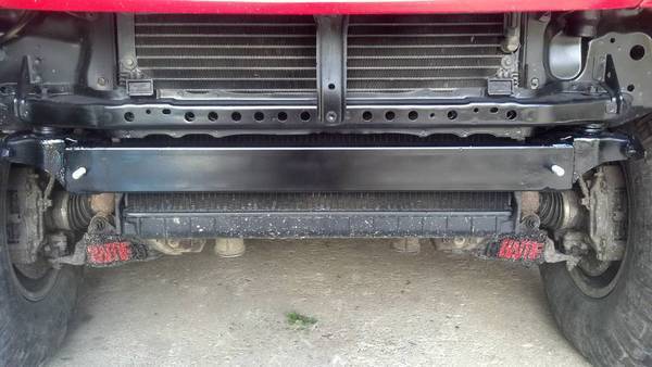

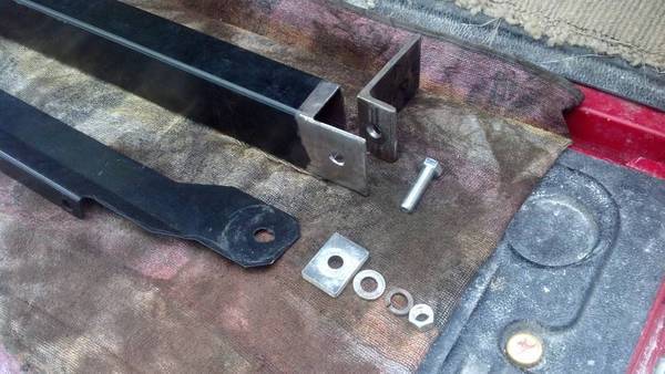

    End cap mod:
    Cut off stock end-caps and ground down to bare metal
    Fabricated a 1/4" angle iron to slide into the frame rail, as well as a piece of 2"x3" tube for a new crossmember.
    Mig welded a bolt through the new end cap, and also drilled some rosettes in the interior of the frame and welded those for additional strength
    Then welded in the new crossmember
    All painted up

    I didn't really box the frame, just added some beef to the front end caps, as seen above, to hold up against heavy winching. The stock end caps were basically 1/8" sections and the nut on the inside was only tack welded, a known weak spot on 1st gens
    I do want to box the rear frame eventually though

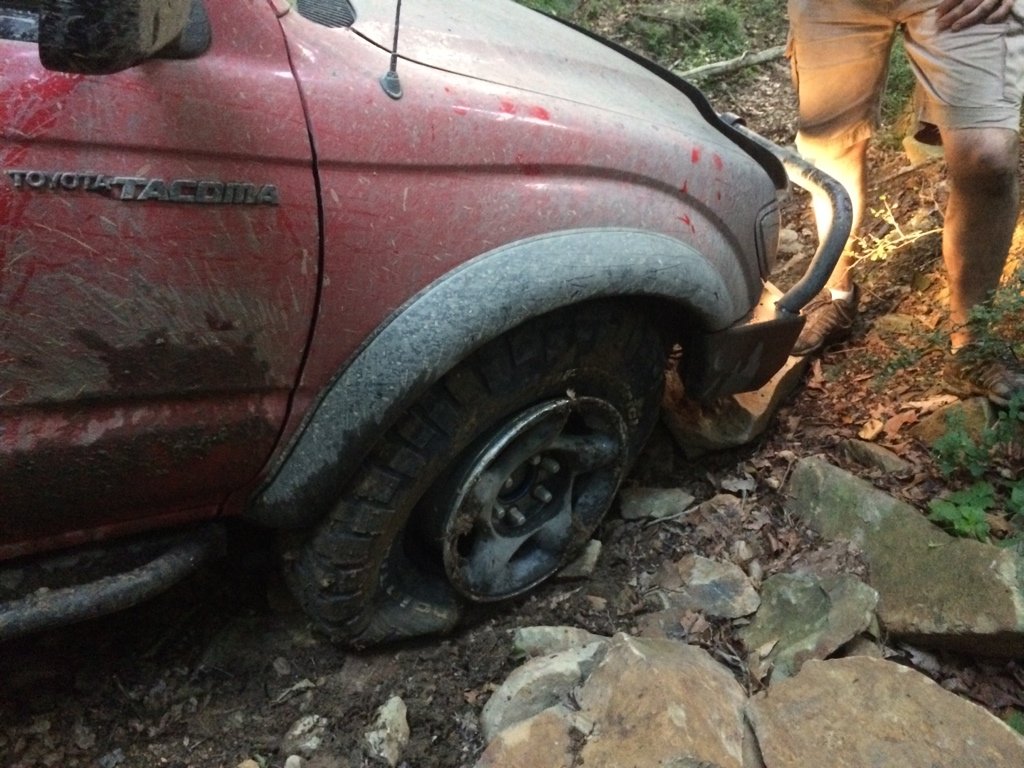

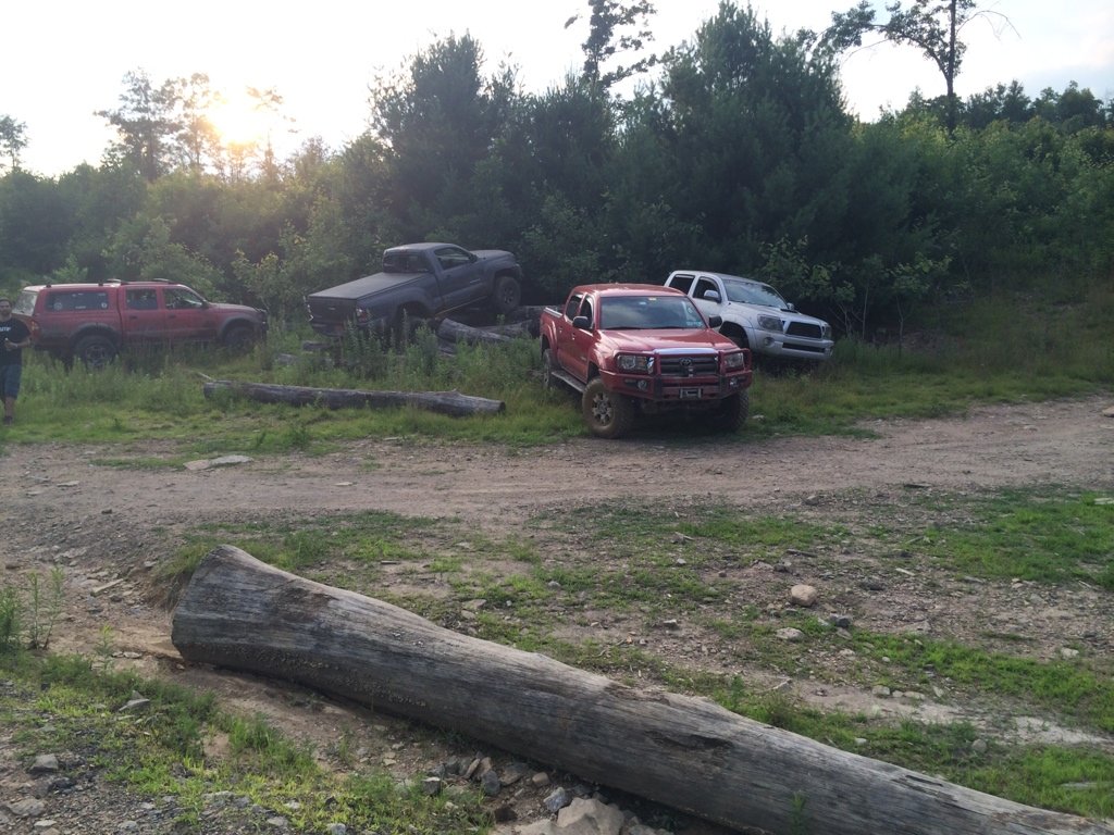

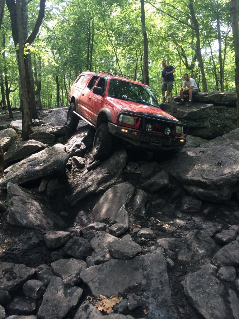

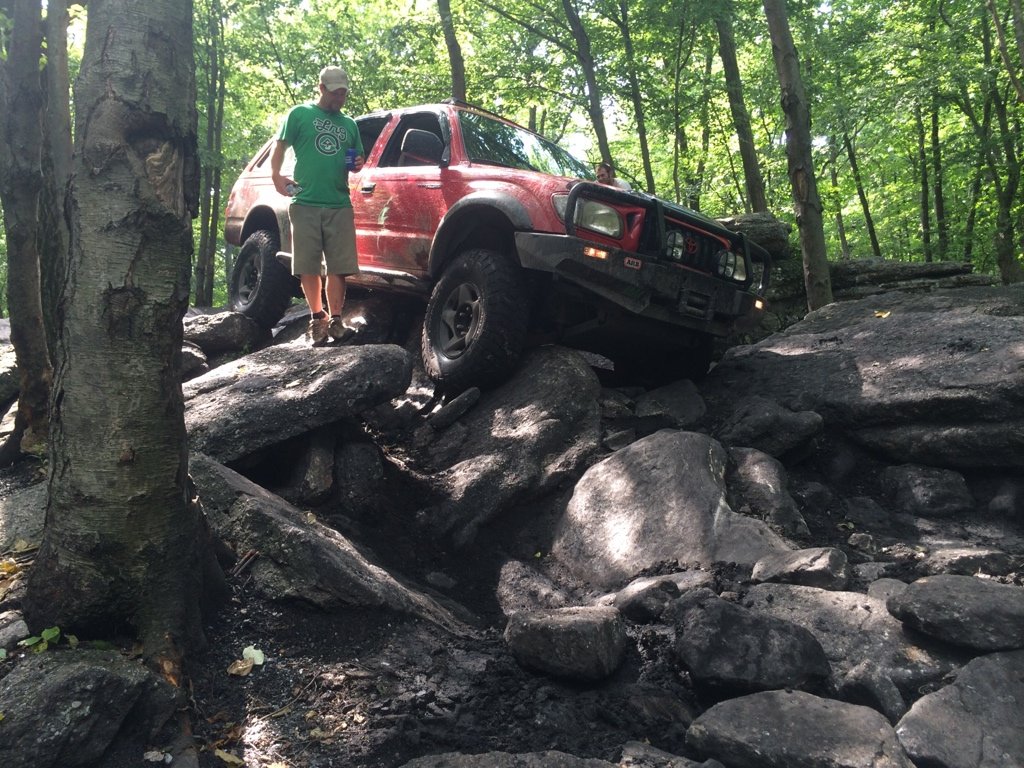

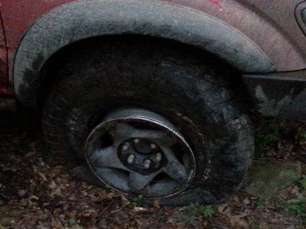

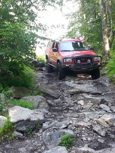

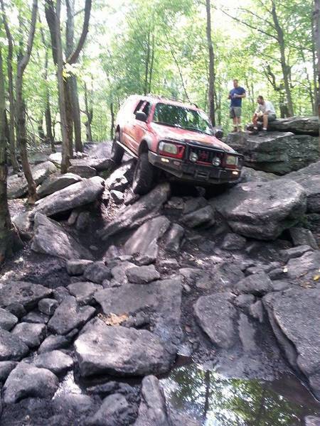

    Wheeled at Rausch Creek w/ some fellow TW'ers this weekend!!
    Fist time trying Yellowjacket !! aaand made it with hardly a touch of the skids :cool:

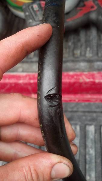

    suffered some carnage..
    But DAMN was that an awesome time!!
    I got some wounds that need licking; but it could've been alot worse. :cool:

    So did the tire pop off the bead or get sidewall sliced? I saw the one video and heard the big rush of air.

    just popped off the bead, it was a combination of all the weight, having to turn driver at the bottom, and being aired down to 12 psi
    pretty quick fix and we were back at it :)

    I've never had a tire pop off the bead. When it does happen can you get air into it so it re-seats itself or do you have to throw on the spare and have a tire shop reset the tire on the wheel?

    I was curious too if you used the heat method to reseat it on the trail or just threw on your spare
  19. Jul 15, 2014 at 3:54 PM
    #19
    avw4x4
    avw4x4 Well-Hung Member
    Oct 20, 2013
    #114886
    2,414
    (M)Andrew
    Rochester, NY
    2003 Yota
    ...loading....
    Threw on a spare, Greg was able to reseat it with his CO2 tank despite our encouragement to try it with fire lol.
