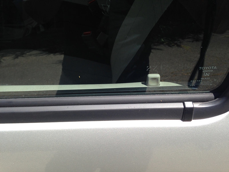

    Yeah I think I paid $30 a pop for mine from the dealer, took like 10 minutes to replace.
    FWIW OP if you look em up on any Toyota parts site, just use "weatherstrip," for your search, they'll pop up.

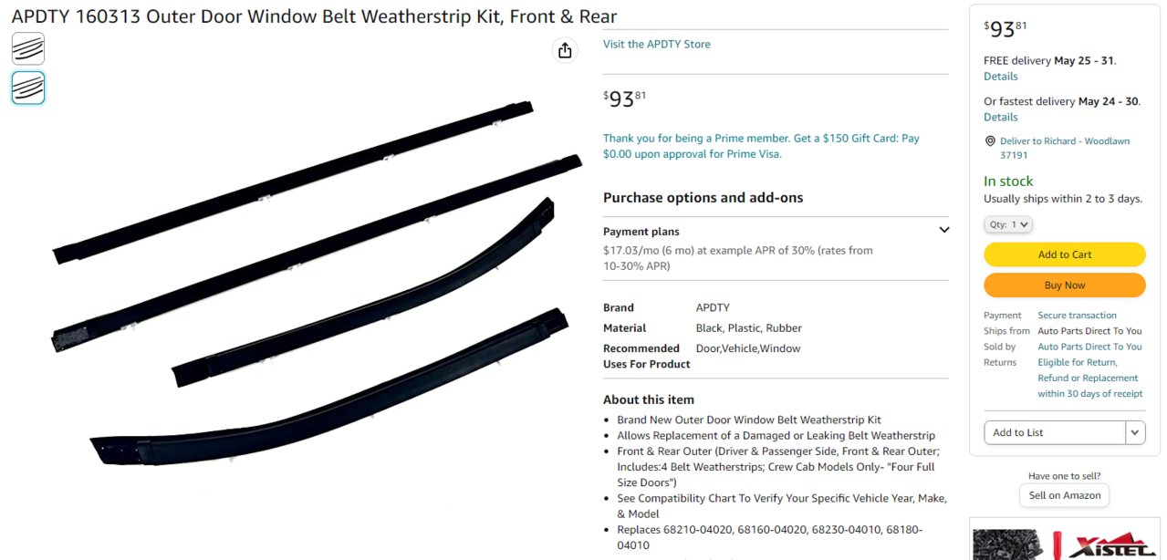

    My old ones are 22 years old so, beyond worn. I might put that on after about six months of wear with the replacement parts. Thanks for the info!

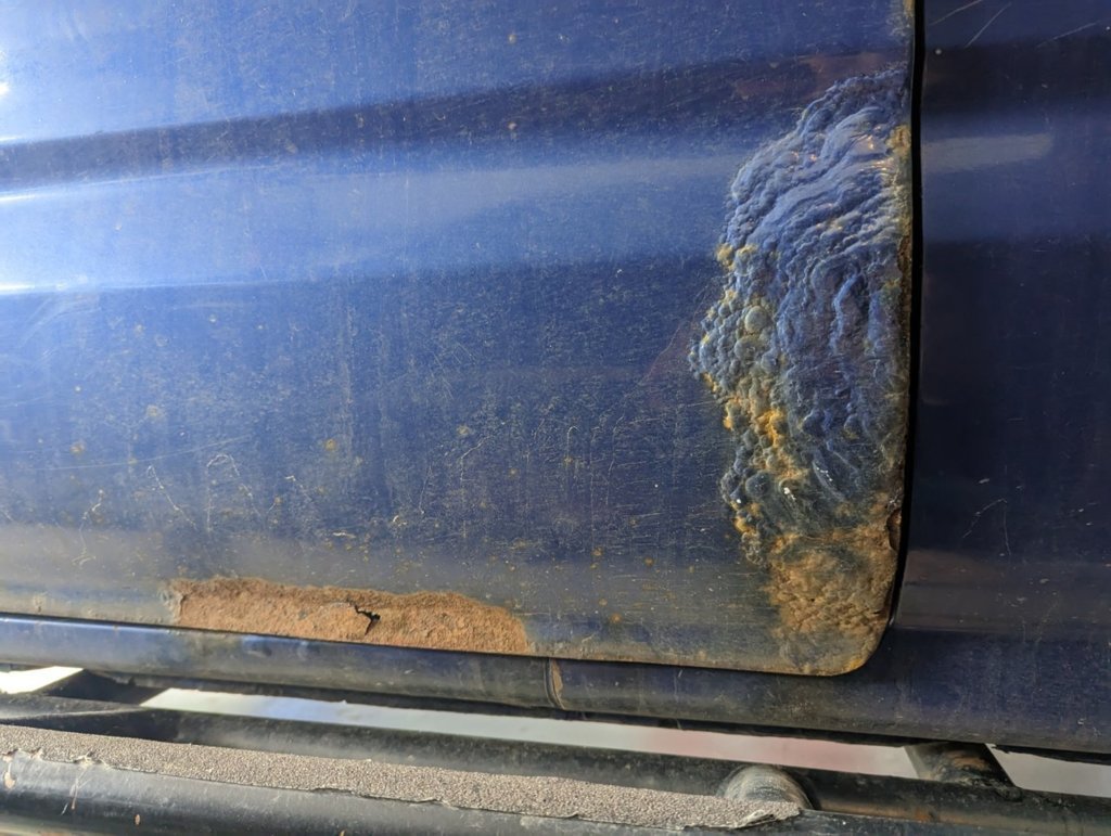

    It's not a bad idea to replace these and make sure everything is sealed up. After a few winters with a really leaky one I've said goodbye to my door

    Like....YIKES! Good point to replace those aye....
