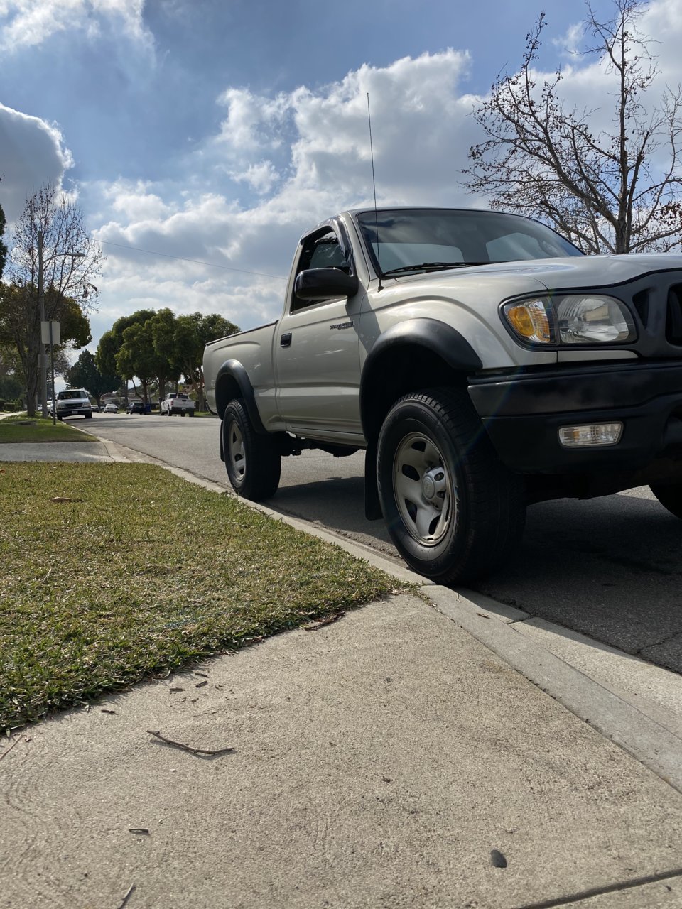

    This my truck everyone

    265s are about as big as you can run with no lift on a prerunner and 4x4

    too many variables to consider with your post. also don't listen to 2nd and 3rd Genners :D
    if you want a standard, stick with your current rims, and get a highway tire with good treadwear (michelin, cooper, etc).
    if you plan to do any gravel or dirt roads you can adjust accordingly. stock tire size would be 265/70-16 or you could get the 245/75-16 which is popular and same size diameter.
