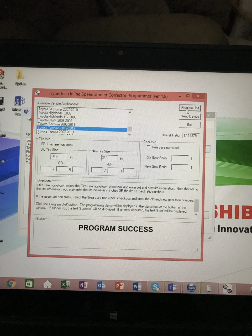

    Talking to tech support from Hypertech, reading Tacomaworld forums, and watching YouTube post after post I programed the Hypertech tuner to read new tire diameter in actual inches instead of using tire factory nomenclature. Now, since I'm rather ignorant about this stuff, I am assuming that when entering tire data into the Hypertech tuner if the old tire size is known does a person enter the factory spec diameter? Common sense tells me that is what is done due to the fact that the old tires are not on the truck to get an actual measurement. I then entered the new tire size in average actual diameter (lfom top of rubber to the ground) as discussed on forums tech support, and from YouTube videos. Any comments?

    I think that's probably a good move. Nothing you can do if you don't have the old tires to measure.....that said, the true OD gets smaller as the tires wear, so it's all an estimation anyway.
    I'm looking at going the Hypertech route sometime sooner than later (just put 33s on mine) and I think I'm going to go with the nominal OD sizes.....so 30.6" for the OEM 265/70/16s and then 33.1 for the new 255/85/16s
    Something makes me doubt even Toyota has different calibrations for different tire sizes since there are several OEM tire sizes on the different trims.
    As long as you're getting pretty close, that's about as good as it'll get

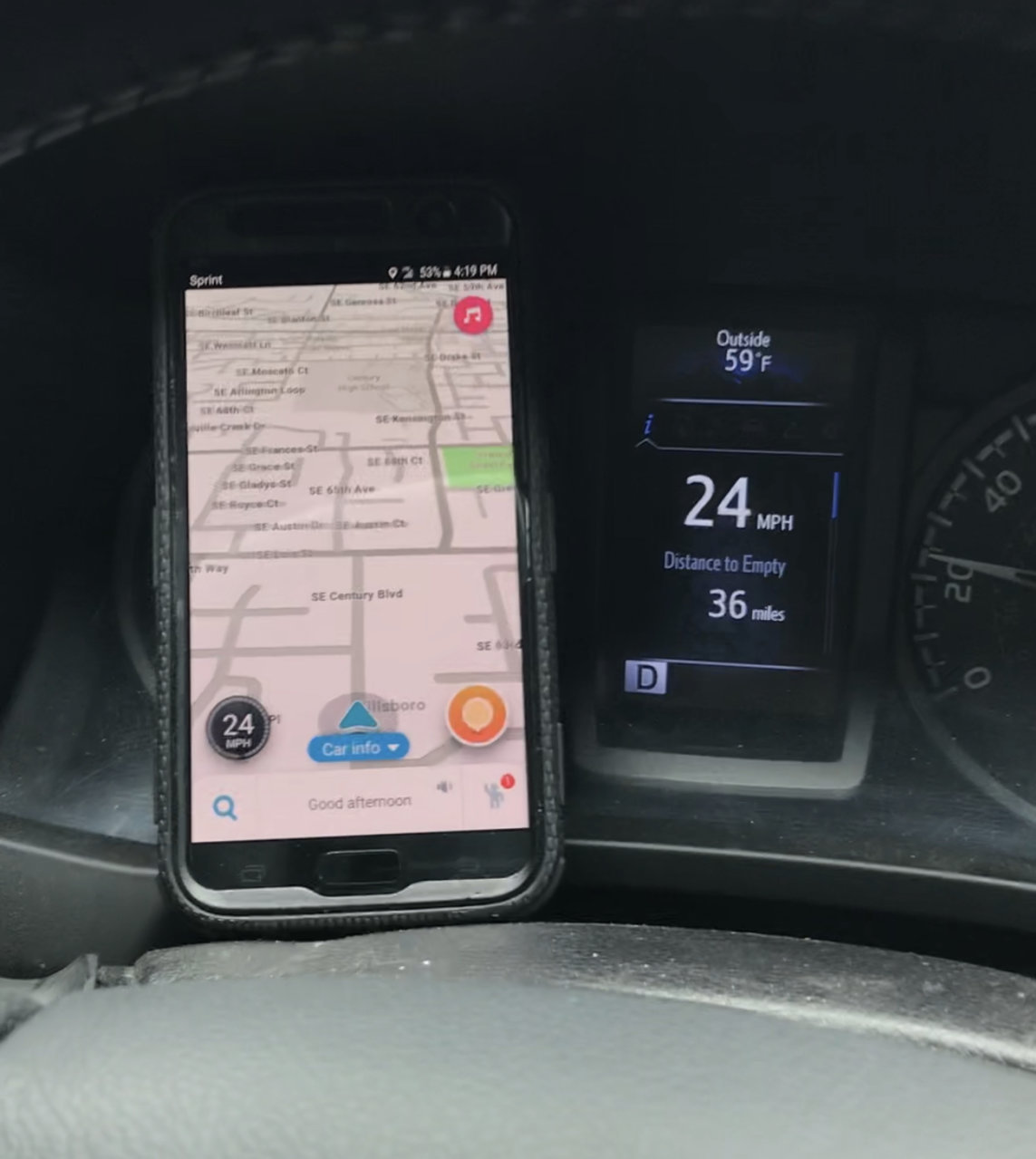

    I’m using the Rough Country version and it uses the Hypertech module and app. I put tire size in inches and it’s dead on with Waze

    Good to know...have you tested it at hwy speeds to see if it's still accurate?

    Yeah it’s still pretty accurate
