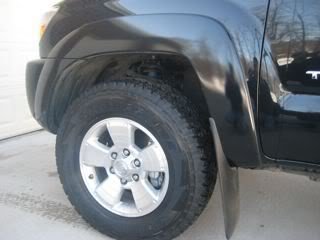

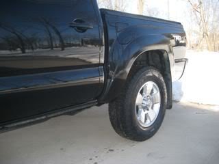

    I put Bridgestone Revo 265/70/17 on my stock sport rims. The speedometer is now more accurate according to my gps after going up a size. Here's what they look like (before I had the rear spring TSB):

    I too have 265/70/17 on my TRD Sport SB.
    JTDTacoma, How's the ride with the TSB leaf springs? Handling change?
