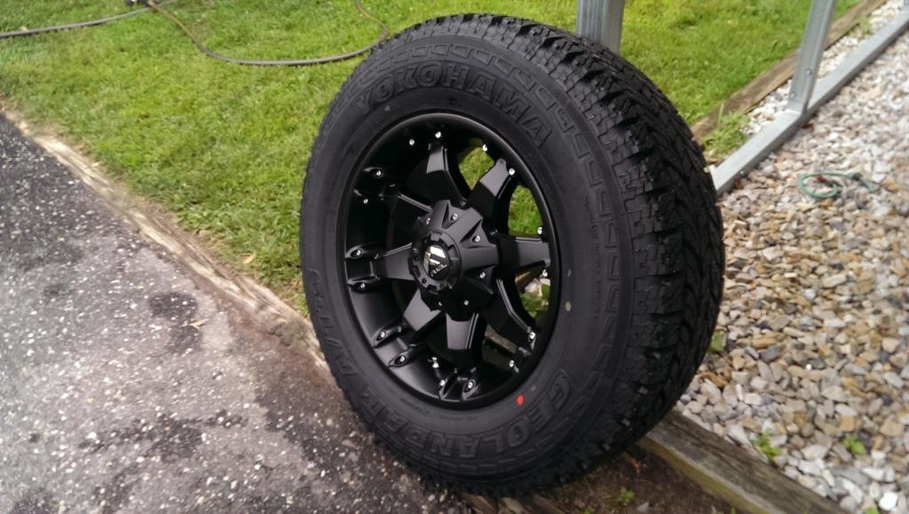

    Fuel Off-Road Octane Wheels,Yokohama Geolander ATS 265/65/17.Grillcraft,Borla Exhaust,Truxedo Lo Pro Tonneau Cover,Pop n Lock Tailgate Security,Custom Wet Okle TRD Seat Covers,Catch-All Matts,Gatorback Belt,Shorty Antenna,Toyota Bed Matt,Sirius Radio,Vent Sades,20% Lumar Window Tint
    Here's the Geolander AT-S 265/65/17 on Fuel Octane 17x8.5
    I think its a great inbetween tire
