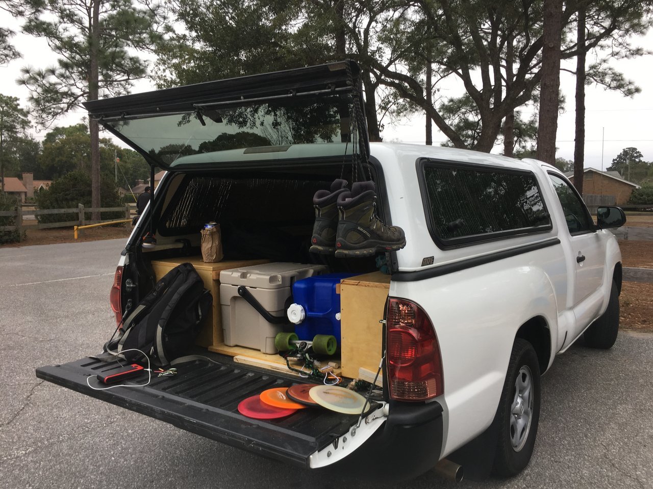

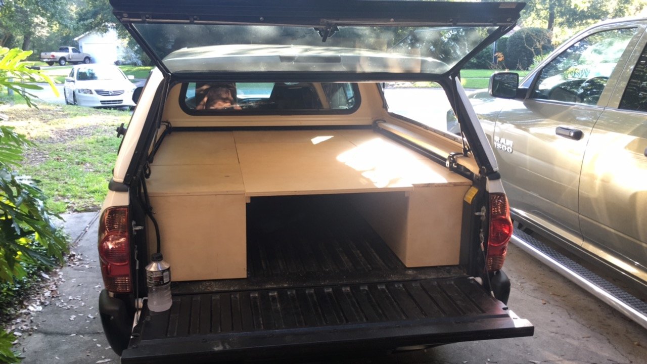

    Will these tires work with a second gen base model reg cab (2013) with an A.R.E. cap? Falken Wildpeak A/T3W 235/75R15XL (https://www.tirebuyer.com/tires/falken/wildpeak-a-t3w/p/TV093001511)..I wasn't sure if the highest p-metric load (XL) would work instead up hopping up to to the LT load rating. Local and long distance vehicle to be used for camping and a good amount of offroad driving. Truck is loaded w wood storage boxes/transforming sleeping platform along w extra gear so added weight is a consideration. image2.jpg image1.jpg

    I wouldn’t use p rated tires if you’re going offroad, all it takes is 2 pokes and you’re toast. I know higher load ranges kill mpgs pretty dramatically but the extra durability is definitely welcome piece of mind imo.

    You have a 4 cyl 5 lug 2wd which appears to be on stock suspension.
    I can't imagine your offroading being too harsh. Lack of 4wd and clearance will both restrict your capability.
    That said, I think a P rated tire would be just fine, unless you know that your offroad areas are of materials that would be excessively hard on tires.
    I know load rating is a factor, but consider that you are also upsizing a good bit over stock, giving you more sidewall as well as tread.
    You might consider something like Hellwig helper springs in the rear to support the extra weight. Our springs are pretty soft.
