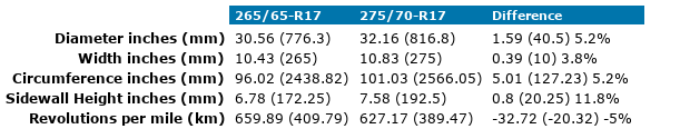

    trim the inner plastic? I'm planning on removing the mud flaps if I must.

    Even if you remove the flaps still have to trim/cut parts of the inner fender.

    That's a 32" tire. Should be OK without trimming. May need to remove front mudflaps.
    Are you using the stock Dunlop Grand Treks right now? Measure the gap between the tire sidewall and the spindle. If you have more than 1/4", the new tire shouldn't rub against the spindle.

    I run 275/70/17 Hankook ATm's with 2 1/2" of lift on stock Sport alloys , no rub , no trim and I still have the flaps on

    You'll only see about .8 inches lift from those tires (half of the diamater gained over existing tires), and you may need to get new wheels.
    That said, they won't rub.

    I run 275/70/17 on stock Sport alloys

    Don't know if you ordered these yet but I just ordered them from Discount Tire for $984 out the door installed. :)
    They matched discounted tire and wheel warehouse for $198 a tire.
    Those are a 10 ply tire but Im just gonna run a lower psi in the tires. Im doing the same 5100s with 2.5" lift in front and stock height in the rear.
