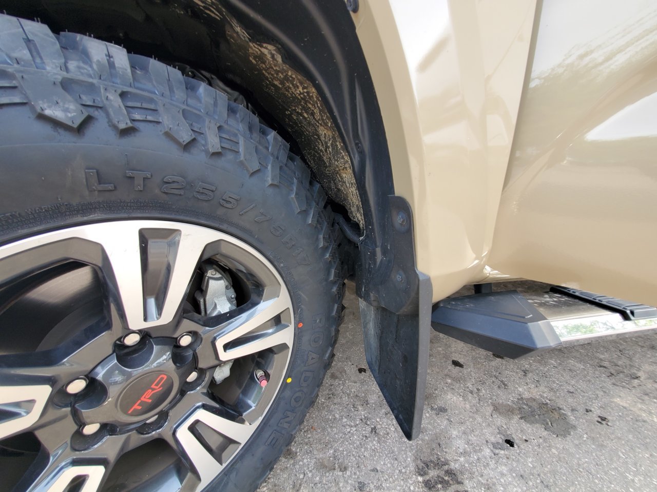

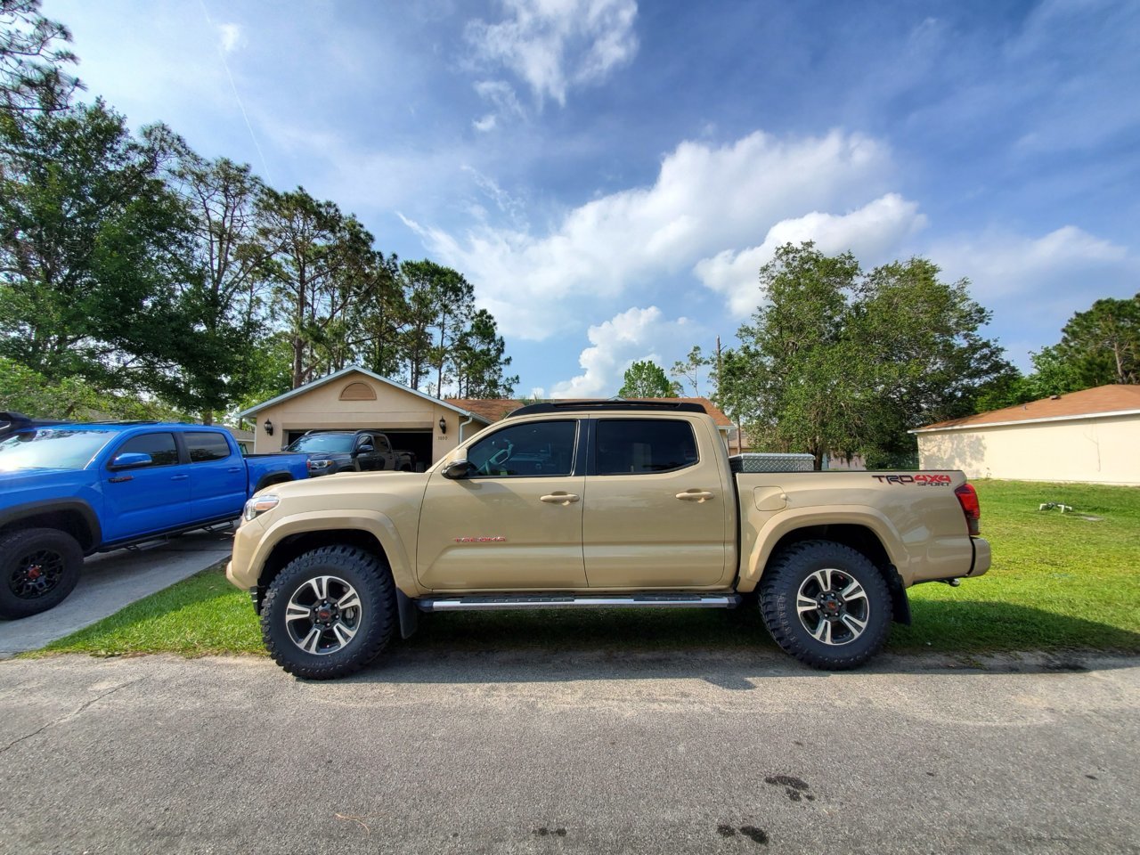

    I installed on my no lift 2018 sport 255/75/17
    Road one MT tires for me they were the best bang for buck. I also installed it on a 2019 TRD OFFROAD
    285/75/16 I have about 20,000 miles on them no issues great in all conditions. Might be a little too aggressive for you since no offroading. But for an MT they are quiet and well priced here is a link.
    https://www.amazon.com/Cavalry-RL1293-LT255-75R17-Rated/dp/B07M94GKML
