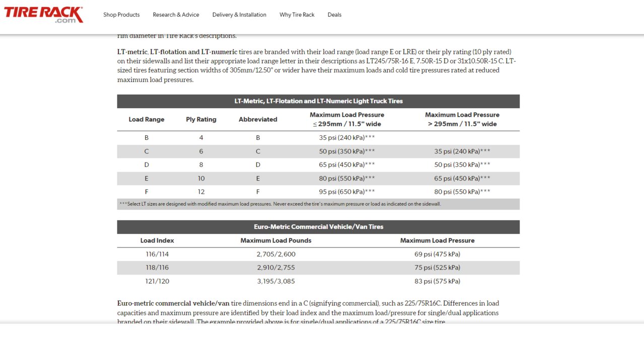

    One more question, this time about Load Range. Looks like the Wild Peaks come in either SL (standard load) with a 4 ply rating or E1 with a 10 ply rating. What is the difference? I am not going to be pulling any trailers, etc., although I will load the bed full with gear from time to time.

    Realistically... weight.
    An E tire is a heavy ass tire. I'm of the personal opinion that it's way, way too much tire for a light duty truck.
    Others will disagree, as an E load offers the best puncture resistance there is on the trail. This is also true. However, I, like most people, do not take my truck across the sharpened lava fields of outer Ganymede. And that's why I run SLs. Even with taking my trailer and camping gear out into the mesquite ridden desert, the SLs have done perfectly fine by me.

    Have a read over here or here. The simple answer to your question is a 4 ply rated tired can handle the load of a 4ply tire whereas the 10 ply rated tire can handle much more load (the equivalent of a 10 ply rated tires). The Es will be heavier and stiffer because they can handle more load. That strength comes at the cost of weight which you should think about because that will impact your Taco's performance. Check out those two hyperlinks, one is to tire rack and the other is a camping website.
    If you have a Discount Tire in your area head over there and talk to one of the support staff about SL vs E. See if they have any inventory on hand in the size you want and have them bring out each so you can bounce them around and get a first hand look and feel the differences.

    Thanks for all the replies, super helpful! Sounds like the SL rating is for me.
