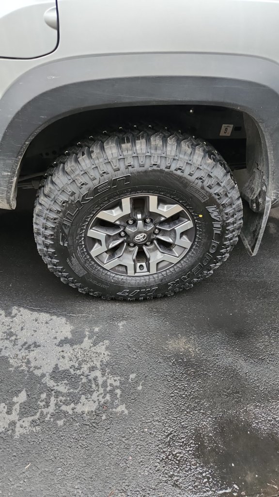

    I have 255/85r16 no lift nor chop required. I only get very little rub from the mud flaps but that is about it. I ended up getting falken wildpeak mt101.

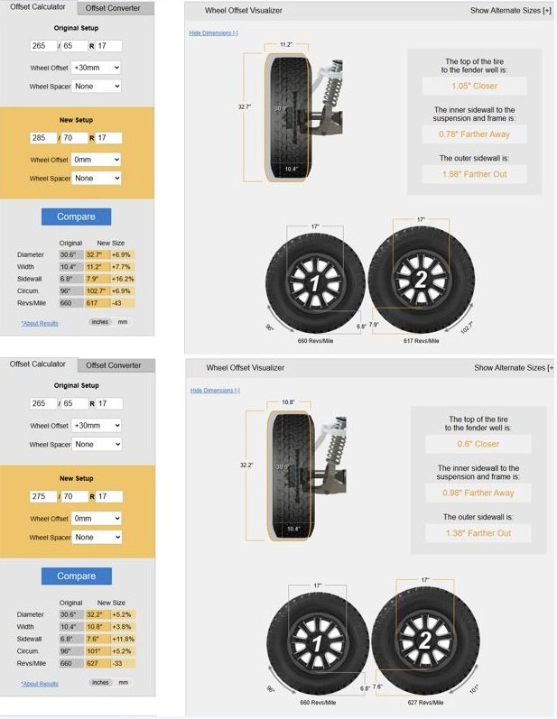

    I know, right?
    Here's the 2 sizes I'm considering with my OEM TRD Lift.
