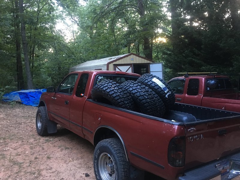

    Help me decide.... I have a 2.7 L 4 cylinder with 2.5" OME Lift coming.
    Should I :
    A) keep the 32x11.50 KM2 I have (just bought new, never used or mounted)
    B) pay $200 more for 33x10 (buy new)
    C) pay $200 more for 32x10.5 (buy new)

    32s. $200 aint worth the half inch more ground clearance. i think the wider tire looks better anyways. plus the 4 banger can turn them over slightly easier.

    I'm worried the wider tire will bog down the 4 cylinder. I like the look of the slightly skinnier tire... It's marginal I know, but I came across a good deal on these 32x11.5 on craigslist, figure I could sell for a little more than what I paid and use it towards what I "think" I would like better...
    I am hoping other's experience with the different sizes might give some $0.02. Plus, I haven't done a poll before... figured it was a good opportunity.

    The larger diameter will have a greater affect than the extra width in regards to accelerating and braking. The pizza cutters will "roll" with slightly less effort though.

    a few pounds per tire won't make any difference at all to the motor. Girlfriend weighs more than that and you don't tell her she may be a factor in motor performance.
    A wider print will simply be a question of how much more they rub and this is determined by the wheel backspacing. Skinnier tire may track better down the road.
    The overall diameter is what you need to be concerned with for gearing. either set of 32's will pretty much feel the same. The 33's will have a noticeable difference in the gas pedal.

    If I would not have found these 11.50's for such a great deal, I would have definitely gone with a 10 wide. Mostly because of how light the truck is. I would think the tires would dig in a little better with less surface area. And because of the 4 cylinder, I would have stuck with the the 32" probably.
    Just wondering how much a difference anyone has experienced between the sizes... Particularly with a 4 cylinder.
