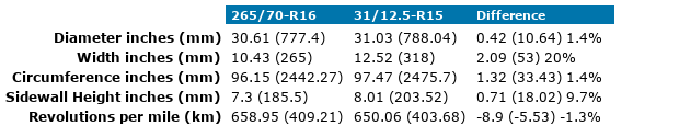

    I have a Tuff Country 2" Leveling kit installed on the front of my truck and 3" TC add-a-leaf springs on the back with Rough Country 3-4" shocks. I am currently running my stock size of 265x70x16 Cooper Discovery ST's so for the time being I'm letting these tires wear out and replace with a new tire/wheel combo(which isn't so hard considering only 15,000 miles with balance/rotating and only 25% tread left). I am heart set on the TSL Thornbird tires and am highly considering new 15x10" wheels due to offset, and somewhat cheaper. The big question is, I am looking at the 31x12.50x15 Thornbirds and wondering if they are ANY taller than the tire's I'm running now??? That's what I'm looking for, bigger and wider tires to raise my stance^

    from the online tire size calculator
    You could find a 32 to give that little bit extra bump up.
