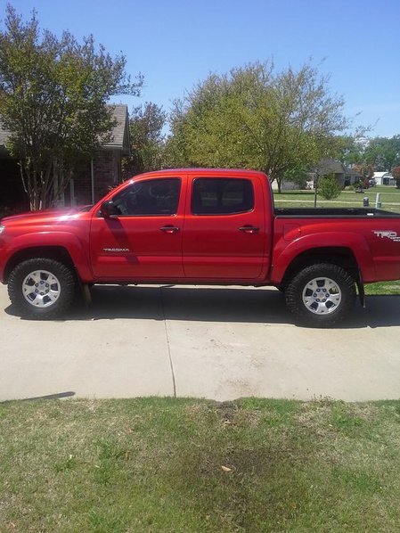

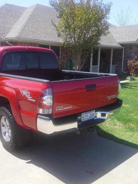

    265/75/16 Duratrcs are what I had on my stock 2009 Prerunner OR. No problems.
