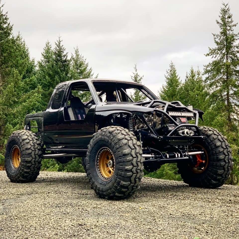

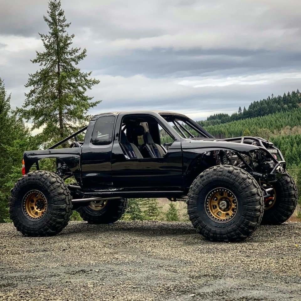

    @Spoonman did it p much at stock; I know they are other TW members who actually have done it on stock, no?

    Zero rubbing anywhere. Only suspension modification is 1/2” front lift from Bilstein 5100 shocks.

    I like your build for sure... but your fenders are cut at minimum in this pic.
    Stock, truly stock... no way.
