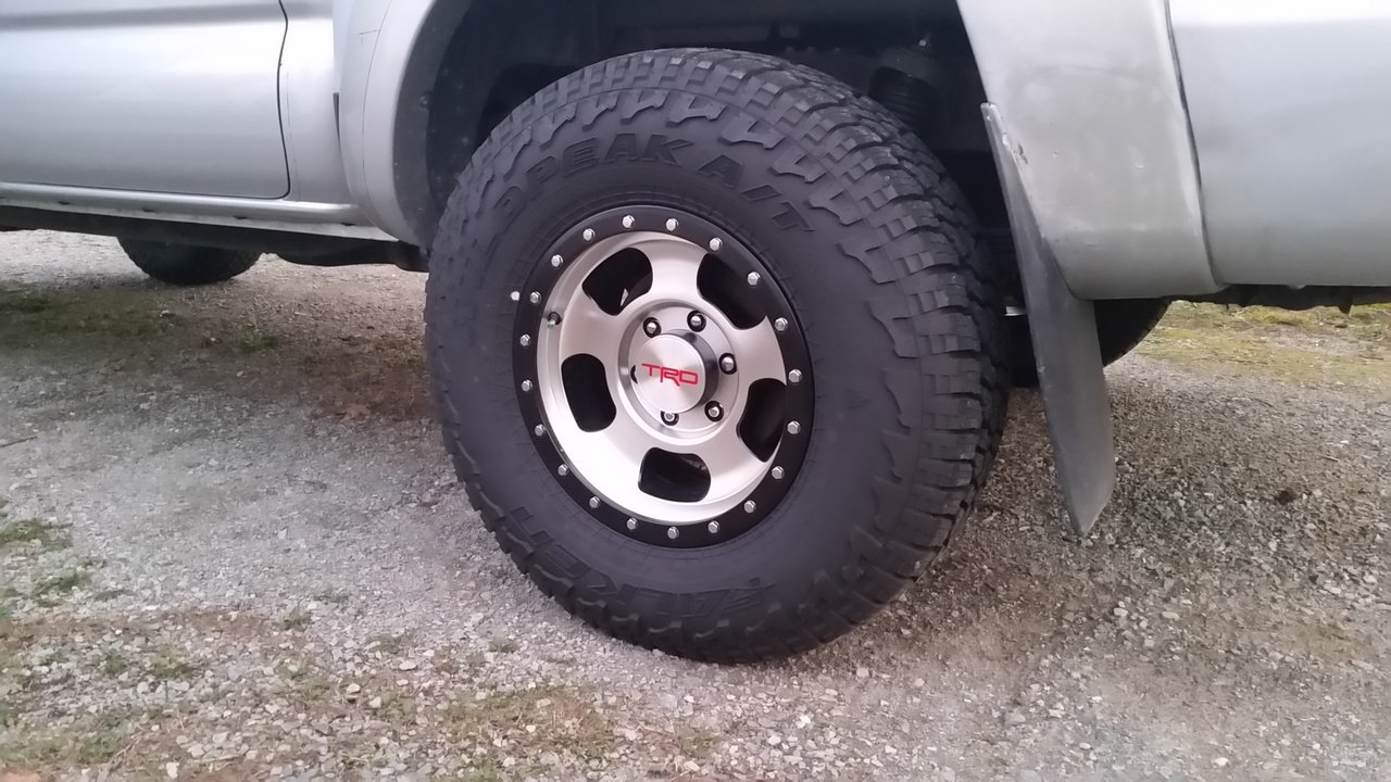

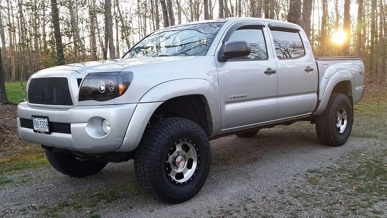

    Falken Wildpeak AT3 265/75/16 should fit right on there with no issues. You may have to lose your front mudflaps. They are only about 1.5" taller than the ones you have but the aggressive style makes them look much bigger. Here they are on my '07
    There's no need to buy new rims if you are happy with the ones you have
