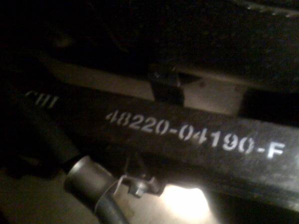

    This is what I have !

    08 White Access Cab TRD OR, Debadged
    AFE oil free drop in, Secondary removed, tint, front D-rings, Toyota bed mat, Undercover tonneau, TRD seat covers and floor mats, Pioneer speakers, Westin Platinum bars, Fumoto oil valve, short antena, Nifty Xtreme's, TSB leaf springs, Bilstein 5100's set at .85" in the front
    Noticed yours is built in Mexico and doesn't have 4 leafs total in the rear? Thought those did.

    Neither, Just thought that trucks made in and for Mexico and Canada on the 08's anyway already had the four leaf rear springs. All US made trucks are still lacking these as well.
