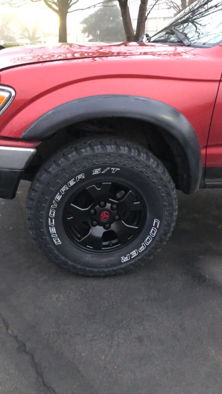

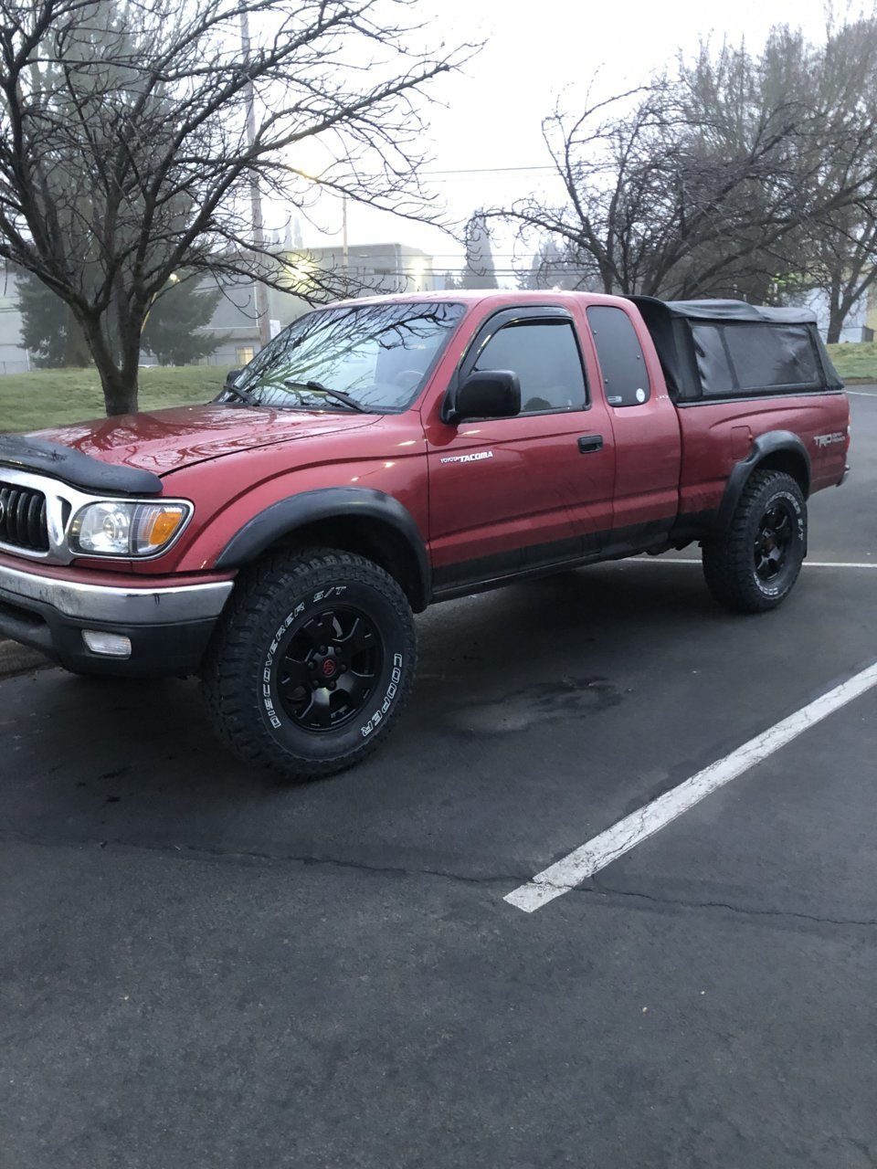

    Cooper ST Maxx 265/75/16 got them on less than a week ago but so far love them
    C8869B1D-4203-427E-9A97-84A3ECB3FA43.jpg 9740B5BA-80D3-4142-9F9B-F73F33BEBBE9.jpg
