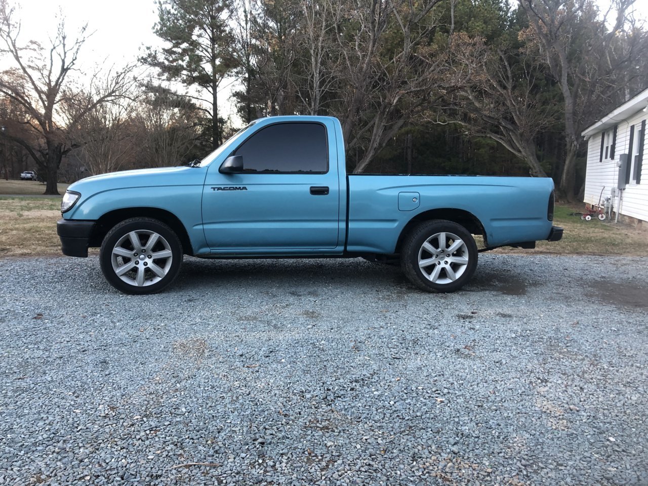

  6. Jan 2, 2019 at 5:21 PM
    Babybluetaco
    Babybluetaco Well-Known Member
    Dec 9, 2018
    #275343
    1,834
    Austin
    Monroe, North Carolina
    09 5 lug
    Actually no they didn’t. They are factory 5x4.5 so the lug pattern fits. But the problem is the center hub bore is to small. Simple to fix. Go on YouTube and type in boring wheel hub. You use a metal router and run it around the inside of the hole to machine it out to fit the Toyota hubs. Took 15 mins each wheel. Or the more exspensive way is to have a machine shop bore the centers of the wheels to the size for a Tacoma
  7. Jan 2, 2019 at 5:23 PM
    Babybluetaco
    Dec 9, 2018
    #275343
    1,834
    Austin
    09 5 lug
    Here is mine on the stock 14” wheels

  8. Jan 3, 2019 at 6:04 AM
    jgwilson88
    jgwilson88 Well-Known Member
    Jul 20, 2016
    #192448
    133
    Josh
    1999 Tacoma Single Cab, 2009 Tacoma TRD Sport DCSB
    1999 Rear lowered 2 inches 2009 2" Leveling kit
    Yeah that's pretty much everything I have read. All have ran into issues with center bore. I was hoping to find some Lexus or Toyota wheels what would work just to keep it in the same family unless I found a way to get rid of Nissan center cap.
