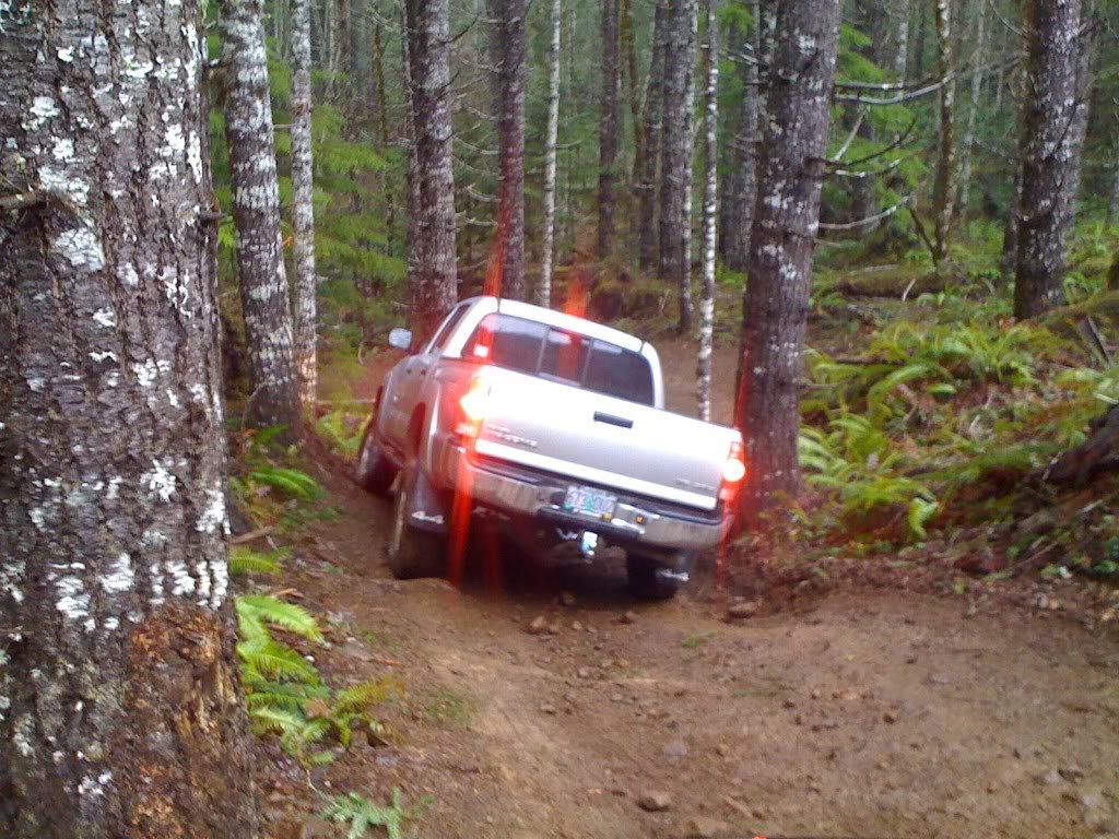

    I've taken my Rugged Trails through moderate trails (and a difficult rock garden) at TSF and have made it through, though it may take me a few extra tries or heavier reliance on the locker. Being utterly new to 4x4, I'm still able to keep up a decent amount.
    It's no secret that the Rugged Trails aren't great for offroad capability, so don't buy them... but if they came on the vehicle, that doesn't mean you have to rush out and buy new AT or MT. It just means you might need more finesse or might get extra help on some of the more extreme things you do.
    This is me on a moderate trail (again, pic makes things look easier... maybe this was just an easy spot :p):
