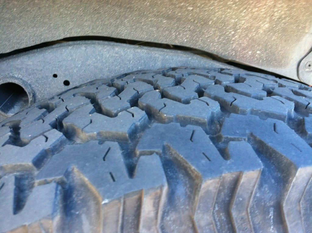

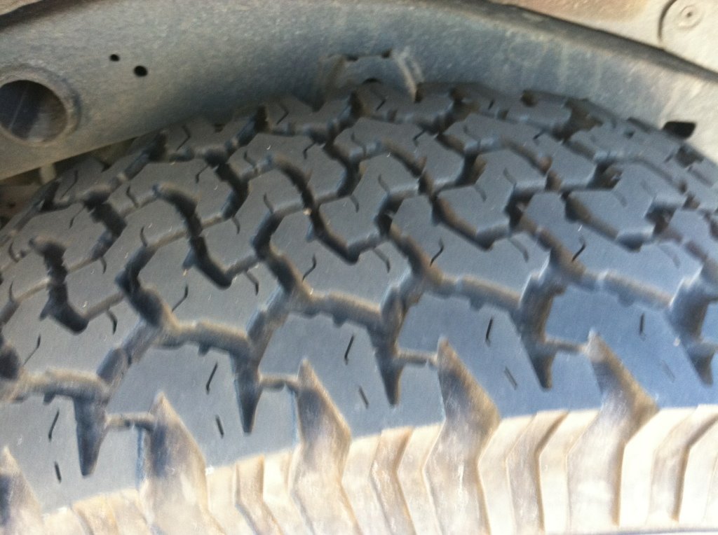

    I'm tempted, but I don't have that much cash to float around if they don't work. It will probably be this week if I do it.
    I was surprised to, but the guy said anything 33" and under he can do. I told him they were BFG AT's and he said that's fine. Sounded like he knew exactly what he was doing.
    That's what I thought as well. I have them at 45 PSI in the back right now to help with it.
    That's what I've heard as well. I just don't want too much to be shaved off.
    I do have the cupped tires in the back. The fronts I think have a very very minor cupping if not none, but the rear are a bit worse.
    It would be a really annoying couple thousand miles if I went this route.
    Here is the worst tire for reference.
    13FBB7F2-3118-4A4C-9706-BA42129E985F-334_cf32db556a59d9143e6bc6138ce8827faa15b5aa.jpg
    19F18983-F2D7-4E53-AAD8-0B7D676BCDEE-334_b440fe9f408dc518d01a291a313deeef2e59d707.jpg

    That's really not that bad. I'd just throw them on make sure the pressure is good and call it a day.

    It's not horrible of wear, but it's really annoying on the freeway. Around town I could care less, but I drive 15 minutes at least to work on the freeway and my 4runner is the primary trip vehicle. I may just do the rear tires and go from there.
