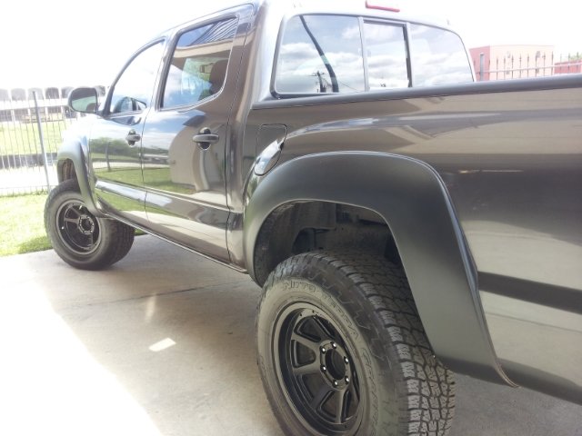

    OME kit 885, LR UCA, XD addict 17's, 265 70 Nitto, ultra gauge, weather tech
    You can probably fit a 275 70 17 with billies at 1.75 and trimming. Im running 265 70 17 and I bet I could go bigger. Only downside is not many tires to choose from in that size.

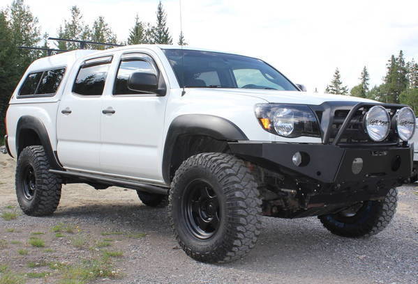

    SAW 2.0 Coilovers Eibach 14" 650lb springs Camburg UCA's All pro expo springs OME rear shocks All pro front bumper All pro IFS skid All pro sliders SCS f5 matt black rims Lightforce blitz 240's
    I run 285/75R16's with 2" of lift in the front. Had to remove mud flaps, trim some plastic and do cmc.

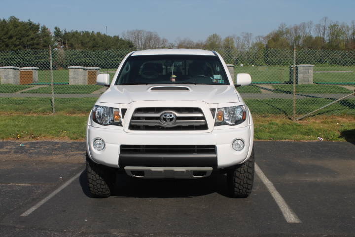

    UNDERCOVER, EIBACH COILS, TSB 4 LEAFS, TRD WHEELS, 255/85R16 KM2

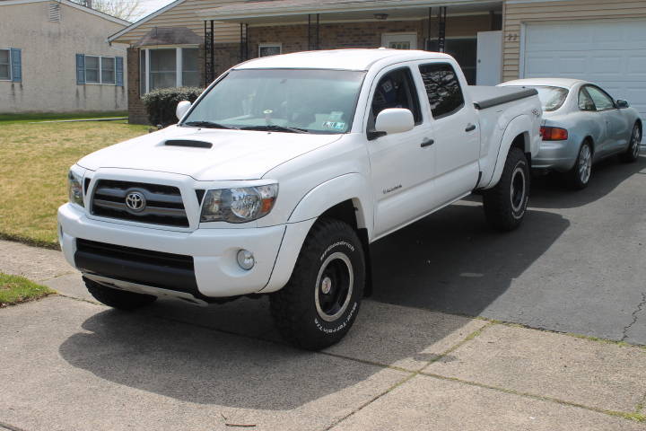

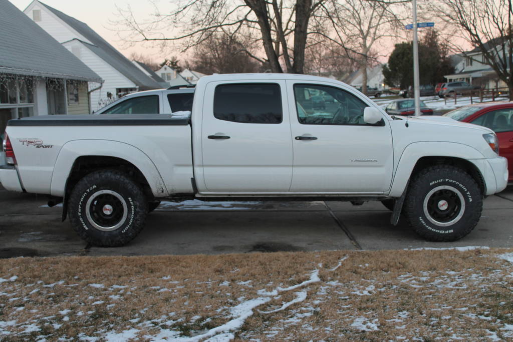

    I have about 1 1/2 inches of lift from Eibach coils and the tsb leaf pack. I haven't trimmed or removed anything. My tires are 255/85/16 BFG KM2 Mud Terrains mounted TRD fake beadlock rims 16x7.5 with 4.5 inches of backspacing.

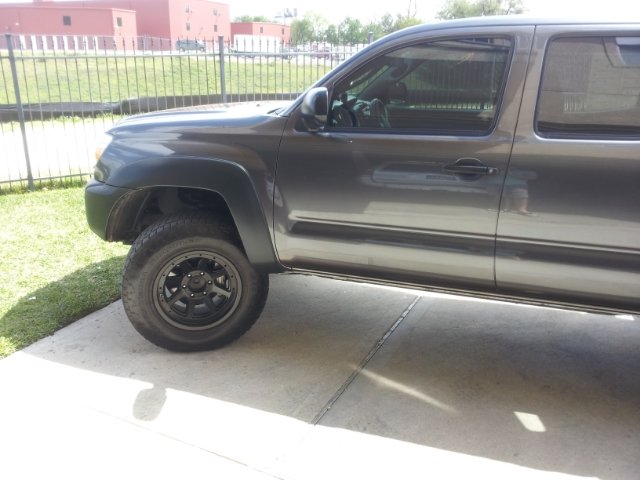

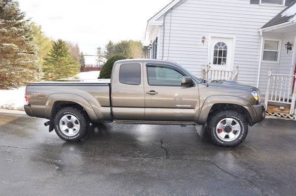

    im wondering the same question as OP. I have the 2 in lift already and am still running the tires I had when there was no lift. 265/70/17 and there was no rubbing at all. I would like to go with a taller tire but unsure of how tall I can go. I see some people have a 75? does anyone have an 80? or do they even make those?
    No lift:
    LIft:
    Same tires

    correction my size is 65 not 70...stupid me
