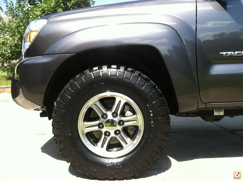

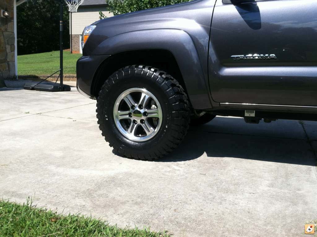

    Ok gotta pic of my new bfg km2's....265/75/16. apeqyne6_31f34726343bfd653fca40a1c7fc2b4ca1dfe052.jpgajunytu5_1d4d4ddc3df60dff14cd48439edd85c81da2b74d.jpgusupegyj_2eda4b111649b81fe628cf043865e7dbd61a93dc.jpg

    Looks good! ^^^^

    No rub?? thats what I would like to do. I think we have the same lift.

    Nope, no rubbing. You will have to remove the front mudflaps, including the small one in the very front

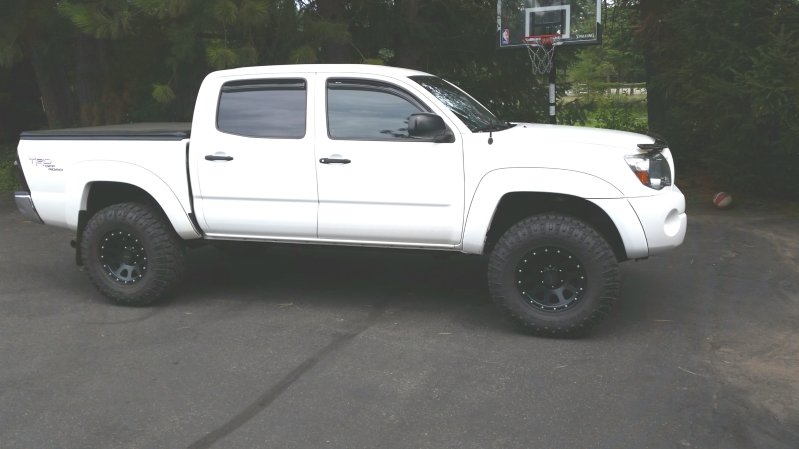

    2in spacer lift with 1.5 aal 285 75 16s

    So im looking at doing bilies at full 2.5" lift in the front, and a Wheeler's 2" AAL to level it out. I do not have mudflaps, and want to go up to 285/75R16s and have NO wheel rub at ALL.
    From what i've read, a 2" lift will only allow me the stock upgrade of size from 265/70 to 265/75R16.
    So looking at your post, would I be able to fit 285/75R16's on the STOCK rims, after adding the AAL and bilies?
    If so, how much would I need to trim off to avoid wheel rub?

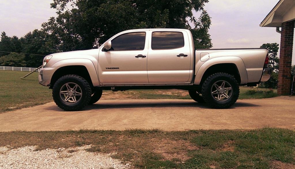

    Mine with OME 885x coils and 5100s @ 0 up front.Back is 1.5" aal on non-tsb springs. Also 1.25" spidertrax spacers and 265/70/17 km2's.

    285 75 16

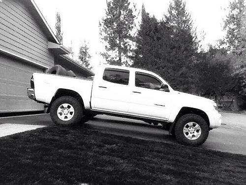

    265/75R16 will fit with no rubbing on stock suspension. I had that size when i replaced my BFGs but when they wore out i went back to stock size. this time Im going back to the 75s with probably a 2inch lift 5100s and 2in aal

    Did you have to use the spacers with those wheels? Same wheels I have and I am looking to do something similar.

    No I just wanted them for a little wider stance.

    That's 2in spacer lift and aal

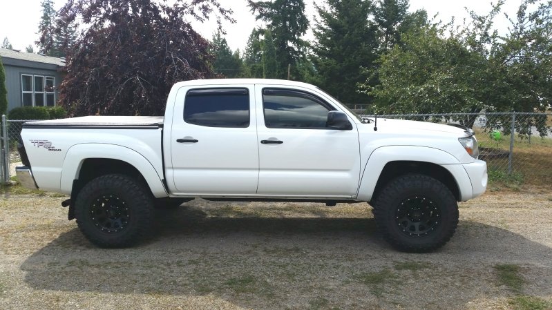

    How does it ride?
