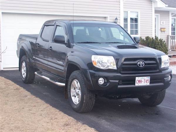

    Here's my truck with 265/70/17's,GoodYear Duratrac's.......This is with 2.5 inches of lift,however,I put this size tire on before the lift and had absolutely no issues.It is the consensus here that this is the largest tire you can run stock.With this size,your sidewall will be .5" taller,making your entire tire 1" taller.The width does not change.It's a great way to give your truck a beefier look.

    Sorry for the double post....Here's 265/70/17's with no lift.

    nice looking truck! are the duratrac's very loud on the highway?

    Thank you......After the first day,I would have said that they didn't make a sound.A couple of weeks in and now I can hear a slight song.It's very minimal.
