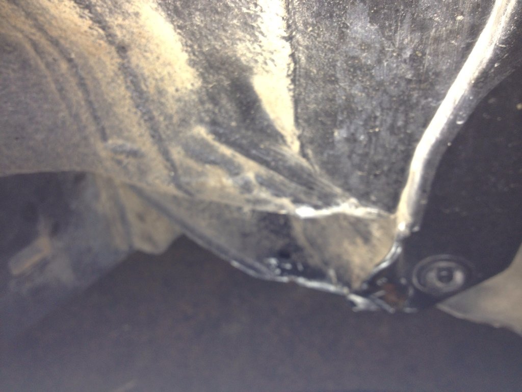

    whats the best way to "shave a little" on the body of my truck so my tires dont rub at home?

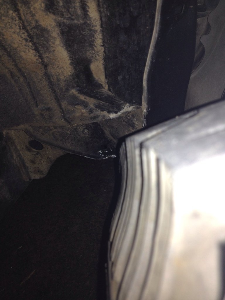

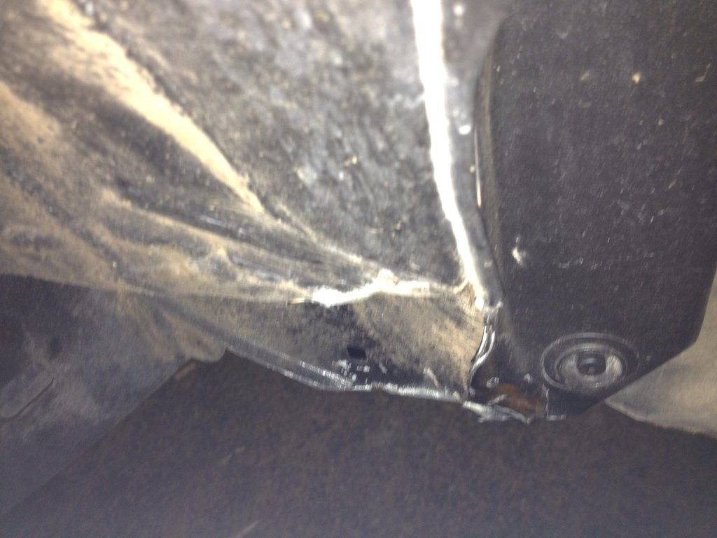

    its not just the fender and front bumper, it looks like it might be the frame. heres a pic

    You sir need a "cab mount chop". Try searching if you want a visual

    AAAHHAAAA, so this is the one huh chris ????
    There'll be no cab chopping on a 1st gen, none to chop, how big tires ??

    Yep, BMFH & pound the pinch welds over, and as far as hitting the inside frame rail you'll have to live with it....

    if this won't get rid of the rubbing you have 3 choices
    1. get smaller tires
    2. cut and weld
    3. more lift

    I looked at it and it looked like chassis not just the cab mount... :notsure:

    we tried!!! ill see what i can do with a hammer and grinder, and idk if i want to lift it to 3" just cuz i already tore both cv boots. although if it wasnt for that i would lift to 3" or even higher (deep down i want anything between 4-6 inches:rolleyes:)

    Do a diff drop, that'll help & didn't you have some extra goodie on there throwing your cv's into a batshit angle ??
    Anything over 3" with IFS you'll need a drop bracket, you really need to SAS (so do I )
