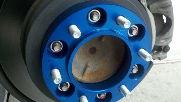

    The spacers bolt to the hubs with a lug nut and they have their own studs to bolt the wheel to. They are not any shorter what so ever. Plenty of people run them. Look at the picture closer:

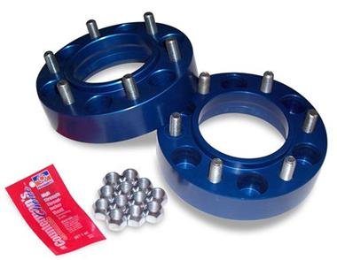

    DT is referring to the "shim" type of wheel spacers which use the existing studs to attach the wheel. These do shorten stud engagement:
    http://www.wheelpros.ca/store/images/wheelSpacers.jpg
    Spidertrax-type spacers have a separate set of full-length studs for attaching the wheel:
    40933d1298937252-spidertrax-wheel-spacer_c4cf4714e12fe6b44f23900d6580daf873d534bb.jpg
    Spidertrax spacers are safe if installed correctly. However, Spidertrax's instructions specifically prohibit the use of impact guns. Unless you trust the mechanic to use only hand tools, you will have to do all the install/removals yourself.
    Like mavrick0509 mentioned, one way is to leave the truck at home on jackstands, and take the wheels and 285 tires in a buddy's car to DT to get the tires installed. Then you can put the wheels on the truck yourself.
