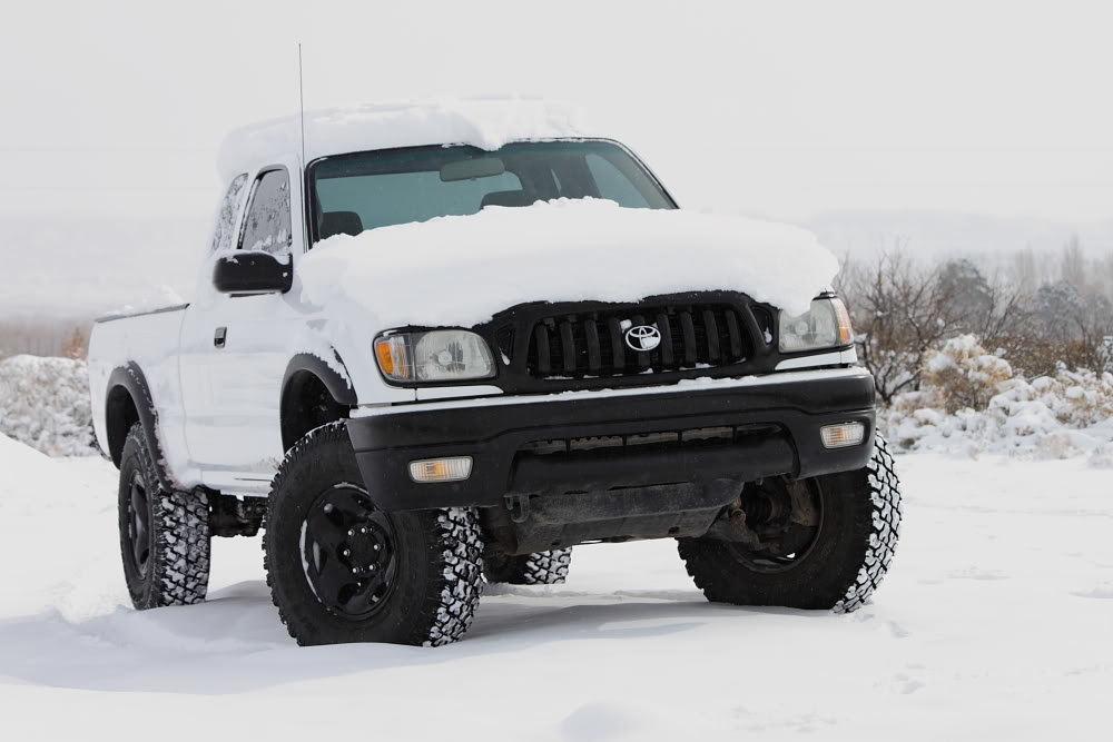

    265/75/16s are the same diameter as m3bassman's 235/85/16s (close enough 31.65" vs 31.73")
    You could probably do the bigger Pizza Cutters 255/85/16s (you might need new bump stops) I think it's XXXX that is running them on a 2nd Gen with 1" lift & new bump stops.
    My 2nd Gen with 3" lift 255/85/16 BFG KM2s on 1st Gen TRDs.

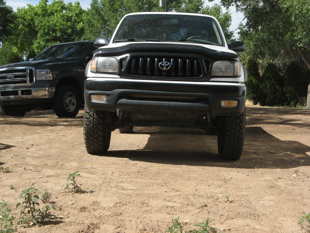

    back when I was running 255/85/16's. Yes they rubbed but not terribly and only offroad.
  13. Jun 24, 2012 at 12:09 PM
