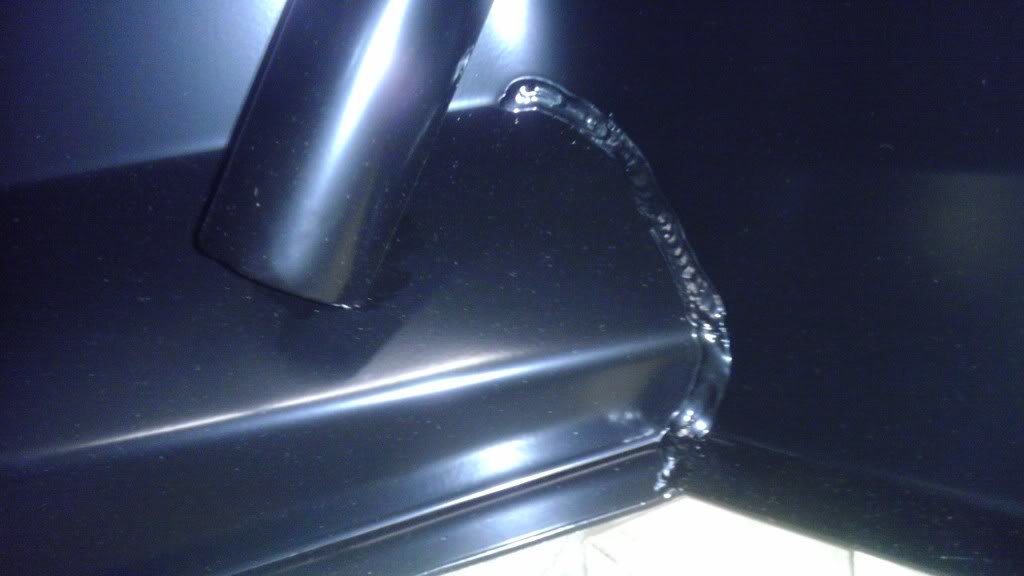

    I finally got to install my T15 this weekend along with the 9k winch. Overall, I'm very happy with it. I'll start with some pre-mount pictures.
    This is on the inside of the passenger side wing. The bars that protect the headlights are welded on top of the bumper and continue through the top, where they are welded to the inside of the bumper.
    Main hoop weld

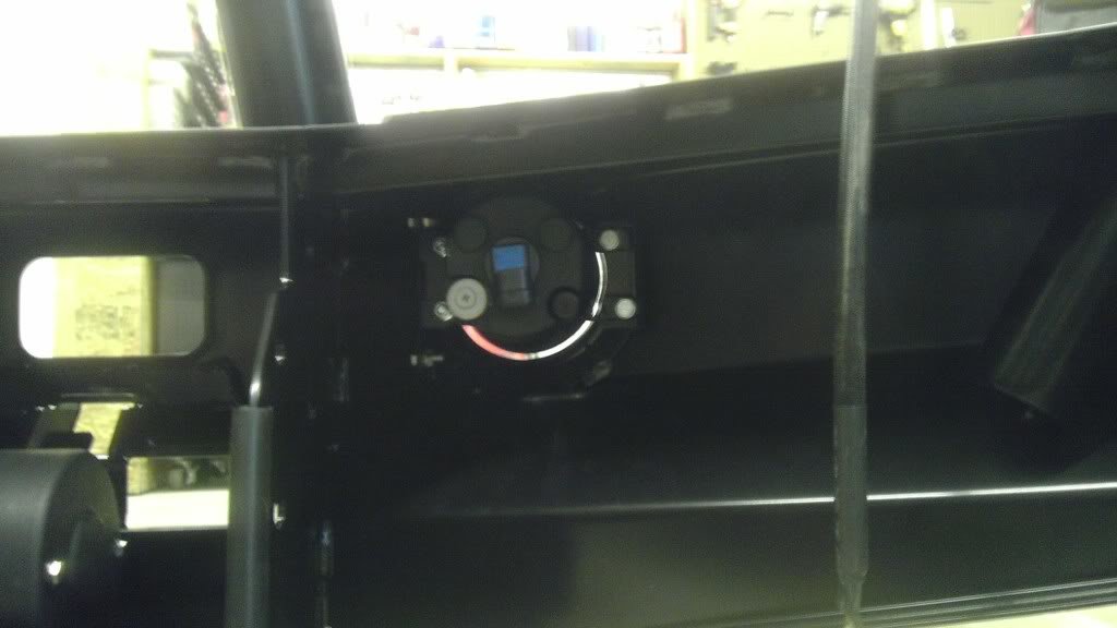

    Winch, from the inside

    in my opinion, not having closely examined any other aftermarket bumper, the quality seems pretty nice. The welds are generally good, and the powder coating seems pretty tough. The winch mounted very easily with plenty of room and the holes in the bumper are in the right places to reach the clutch and spot to plug the corded controller into. I was disappointed with the way the fog lights mount though. They are pretty difficult to get into place and it is generally a poor mounting design. I broke 1 mounting tab on the passenger side light and two on the driver side. Loctite superglue did the trick however, and I just didn't tighten them down so much the second time.

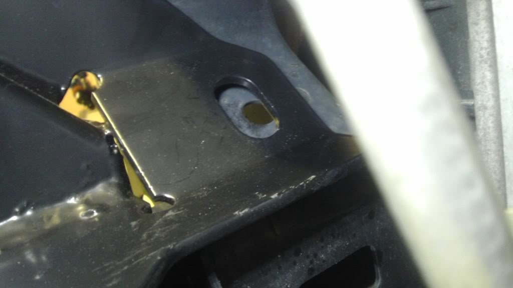

    This was really disappointing, however. This is a bolt hole behind the three main holes on the front of the frame rails.

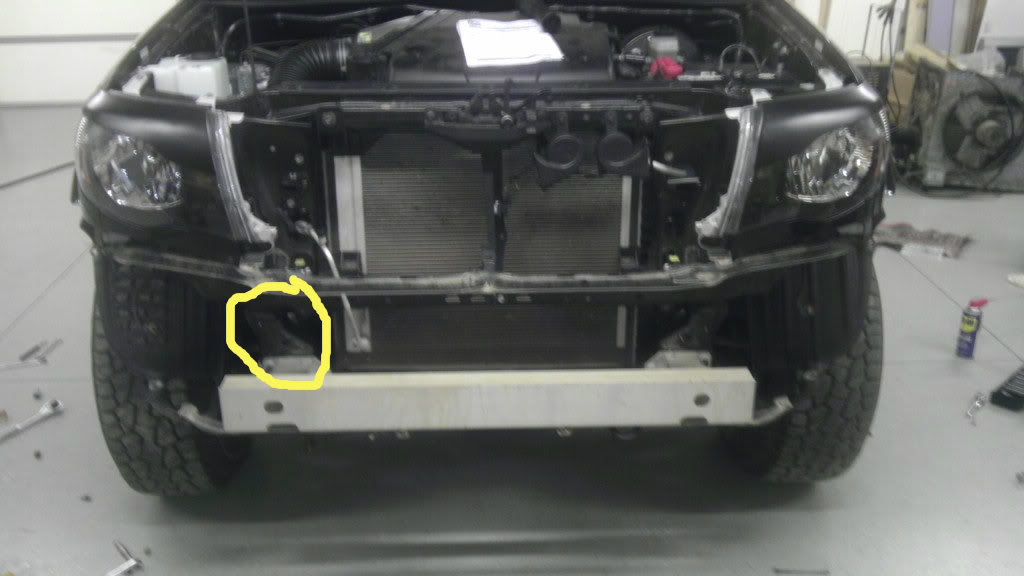

    Inside the yellow circle is the area you are looking at. The bumper has angled brackets that sit inside these curves and bolt up to them. As you can see 2 pictures above, my passenger side bolt holes did not line up, not even close. This bracket is not sitting on the curved part of the frame either, though the driver's side was. I know my truck had a front end fender bender before I got it, but it seems to me that the only way this issue could've come up is if the space from the OEM bumper mounting surface to this bolt hole was incorrect. That would be a hard feat to accomplish. For that matter, in my case it would've been stretched, not compressed. I loosened everything up and tried to get the bumper to come over but it wouldn't, so I don't have a bolt in that spot on the passenger side. There are 6 other bolts holding it in place on the passenger side though, so I'm not loosing any sleep over it.

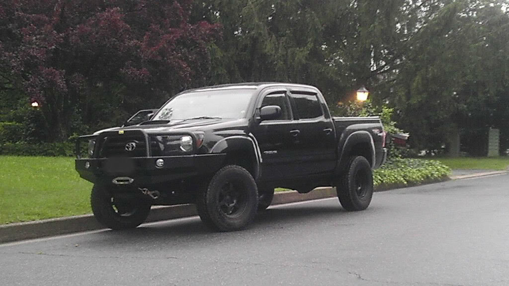

    Here is a much better picture of the finished product. I sent TJM an email about a month ago regarding the bolt hole that would not line up, haven't heard back yet.
