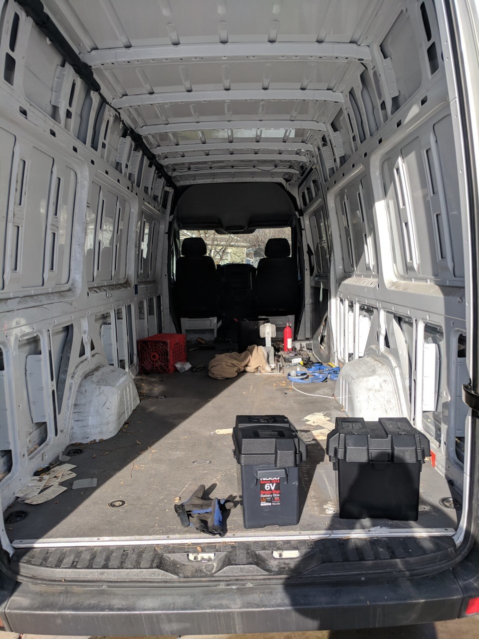

    it was big and empty and noisy and dirty as hell. 27798151_10215361956021324_3728311734668_d5675c3d658a570f26fc3eb4761f650778310f50.jpg

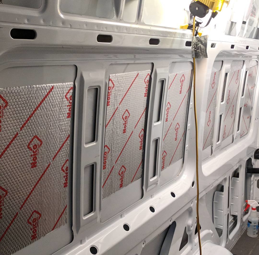

    So we put some sound matt everywhere it would fit on the ceiling and walls
    27173585_10215277742916049_8528337119468_126e348ddeb1b2bc6f0422fed2fdf07f916e66d0.jpg
    Fargo Taco, Drainbung and uurx like this.

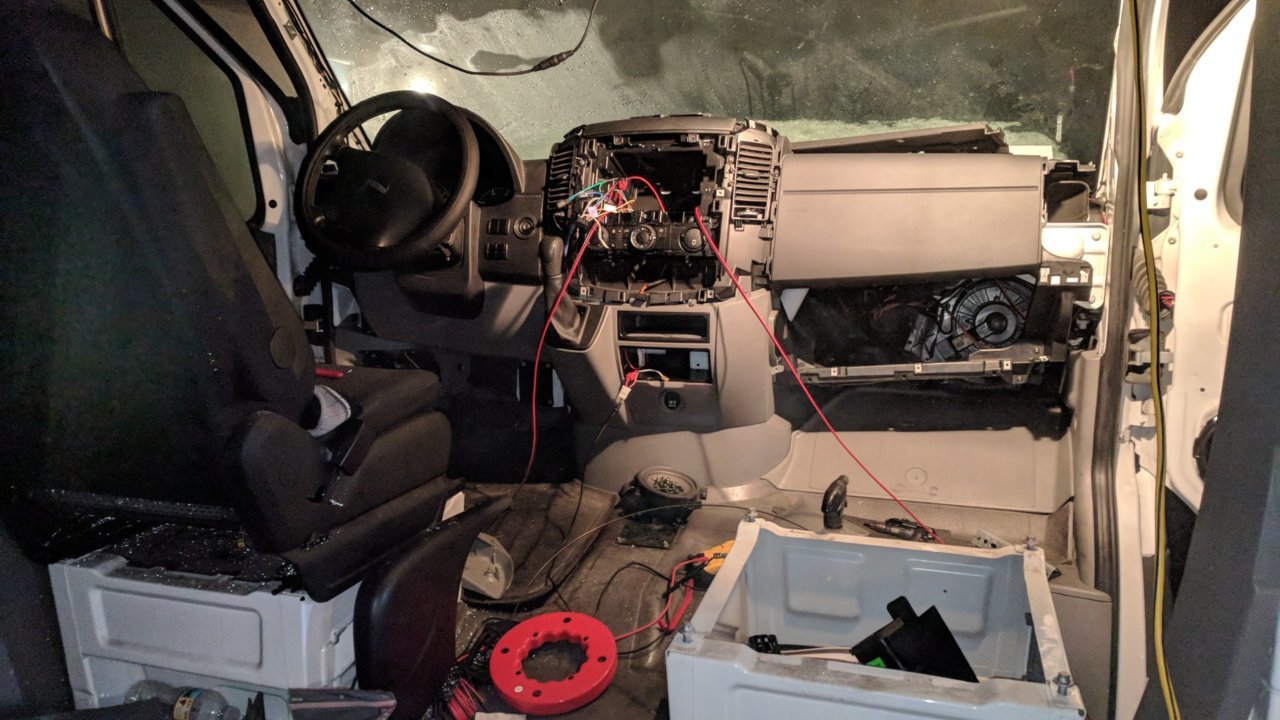

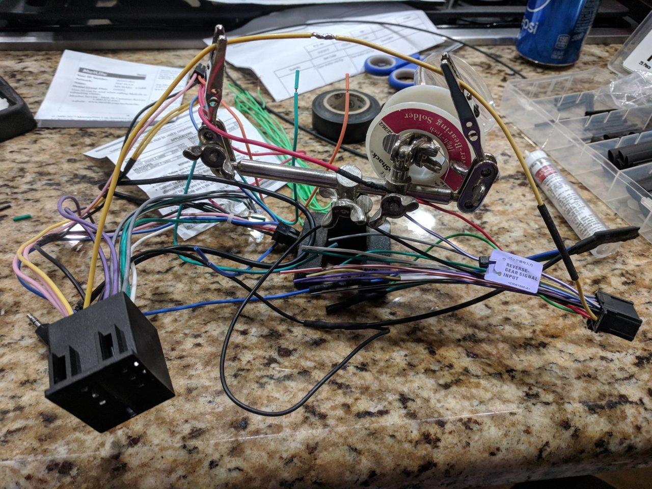

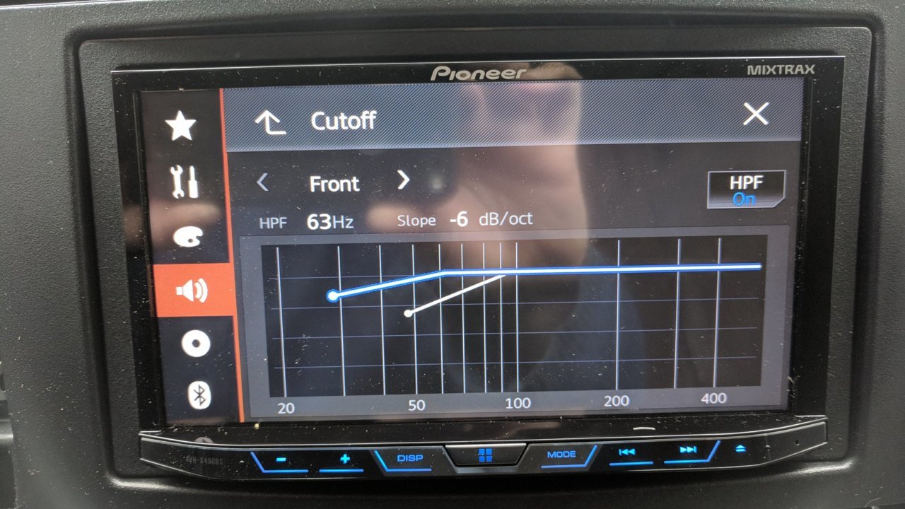

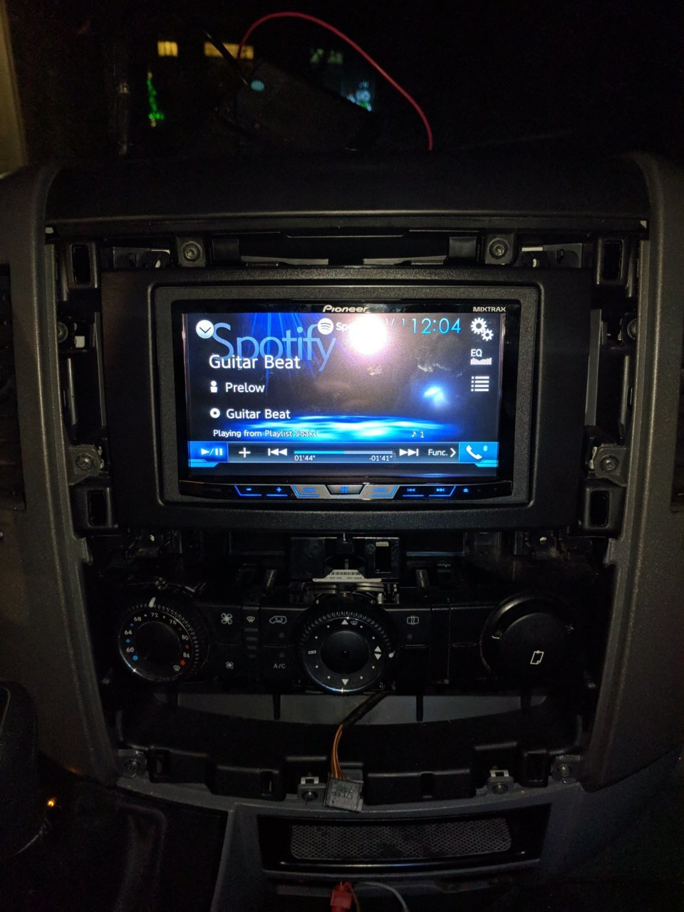

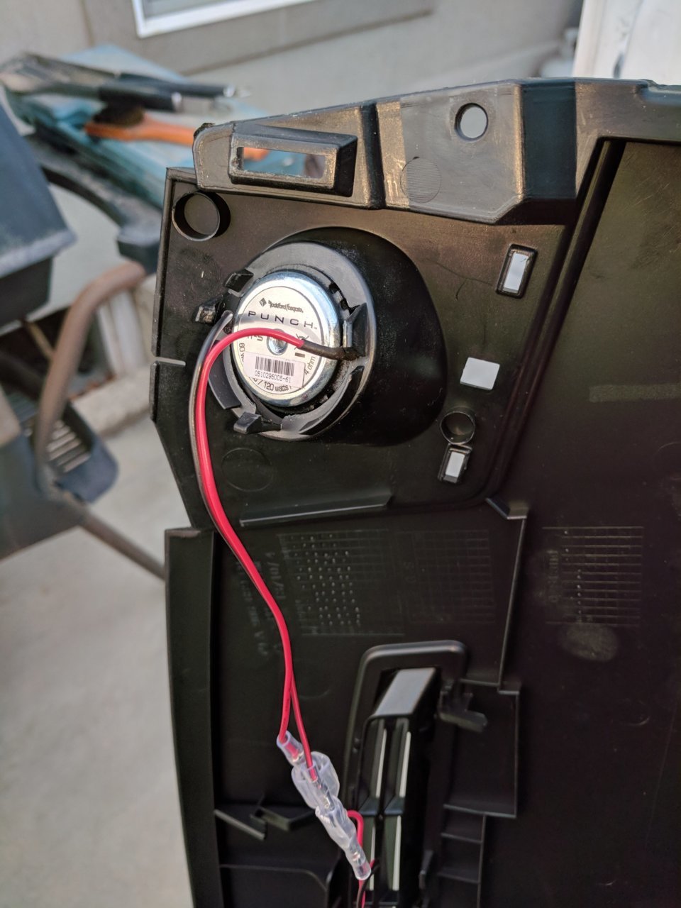

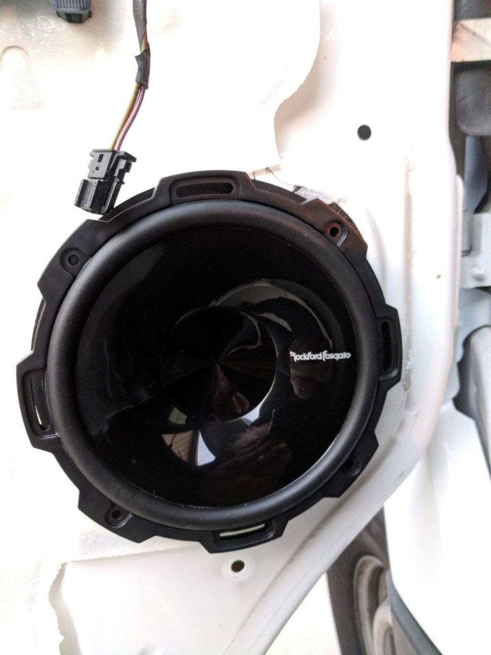

    then we tackle the truly important part: sound system!
    27625143_10215361971181703_8222517664014_e85204f29cfa3d3d67268335320441eba763def4.jpg
    27788257_10215361948981148_2867940000593_1a39047029ee298d36a446e5fafd0ba34aef3c9b.jpg
    27788933_10215361950781193_6724630248564_e0aa06e3994209e5a8a0beb10c6cb1fa800a4ef0.jpg
    27788720_10215361951661215_4340158731387_4e072a2f4474882fb15e9e0ea4a1b60619e8ef37.jpg
    27629411_10215361964661540_8223435271470_62013f32b0f5ae24ca7e89a86be15b127597a635.jpg
    27709934_10215361954421284_5882204516149_1e02d11da05101910ae68de0afb443c9b8e4a5b4.jpg
    60345916_10219342296687353_3854168170982_4adc0ae088bfdd370a9a4a58e1ced92a063c06f6.jpg
    Fargo Taco likes this.

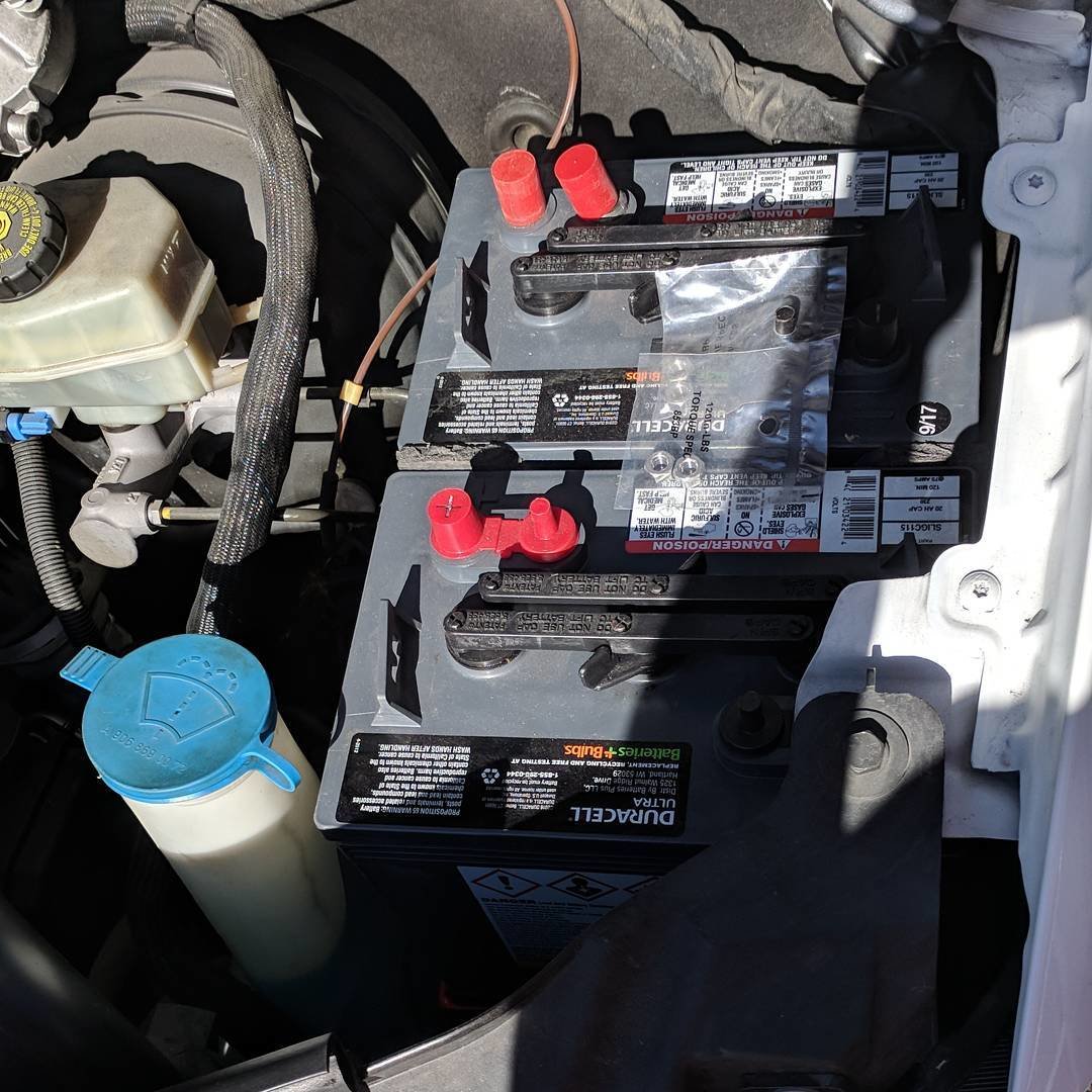

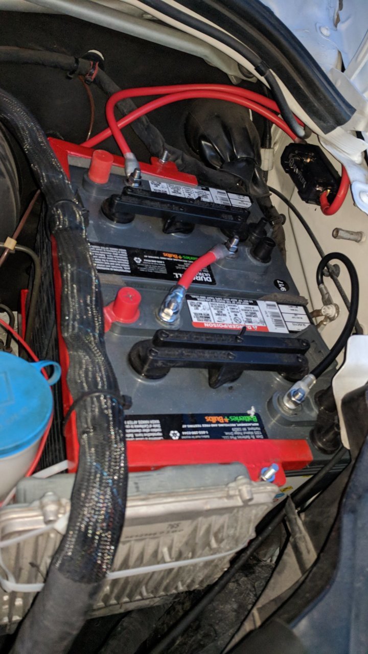

    then on to the aux battery system for lights and accessories when the van is parked. this is 2 6volt deep cycle flooded lead acid batteries in series to get to 12v. built a custom battery box under the hood for them.

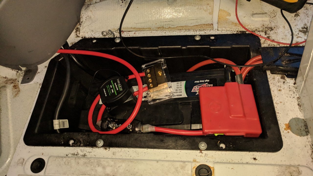

    tied them into the van's charging system using a battery isolator. charges them when the van is running but isolates the van battery from the aux battery so i can't get stranded running the batteries down.

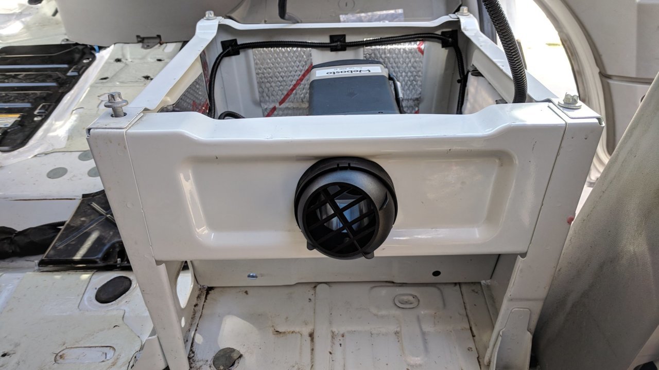

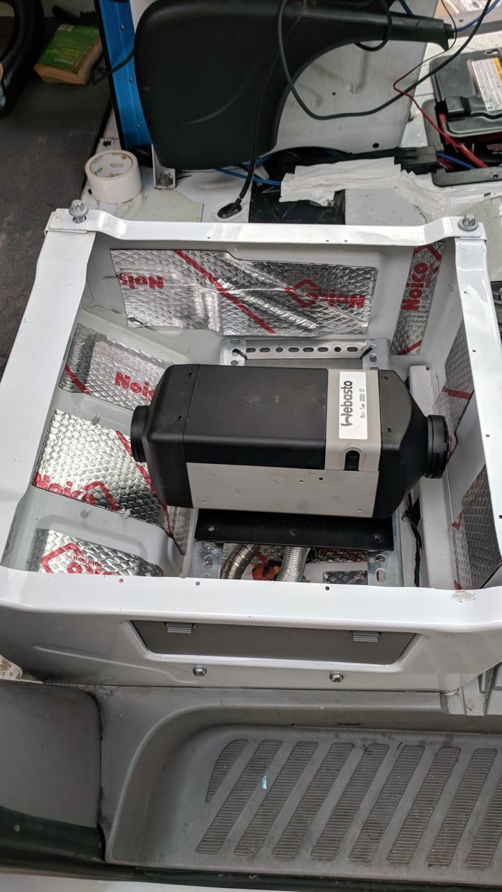

    now that we have aux power, let's power some aux stuff. first things first: heater!
    This is diesel fed from the OEM fuel tank. uses 12v power to run the fan and the little glow plug inside. the result is temp controlled interior whenever we need, complete with a digital thermostat. worth its weight in gold.
    27624968_10215361961461460_4948040024220_03bd0a6d4bbe76a8ecdddf60021730c864281022.jpg
    needed to build some bulkheads to make this install work. cutting holes in the floor was super stressful the first time. now i cut big holes in the van without flinching!
    27629235_10215361962101476_5582400400542_000f339382b86ed959dd576fd0b2de76167d219e.jpg
    27788036_10215361966981598_1068469489573_fb686c2d7506fec0c0de943d29255b6dee15d6be.jpg
    27625154_10215361963861520_2944442810305_f3adfbdf6aeeb41e24249aeb75097a79beed0811.jpg

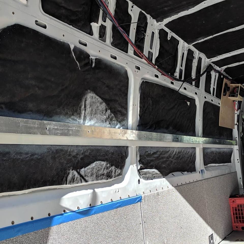

    we added insulation to the walls and ceiling everywhere it would fit.

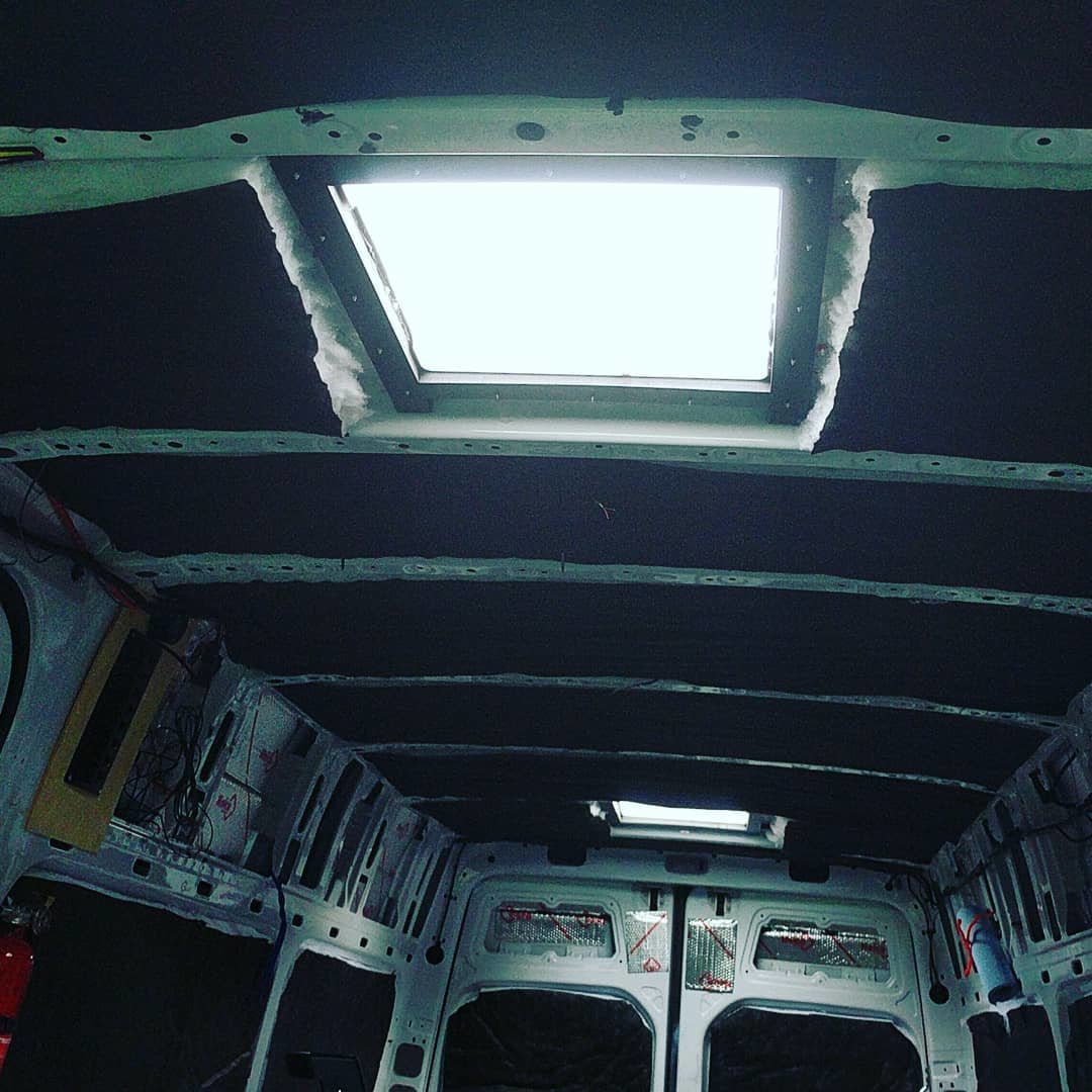

    and cut 2 big gaping holes in the ceiling for fans :eek:

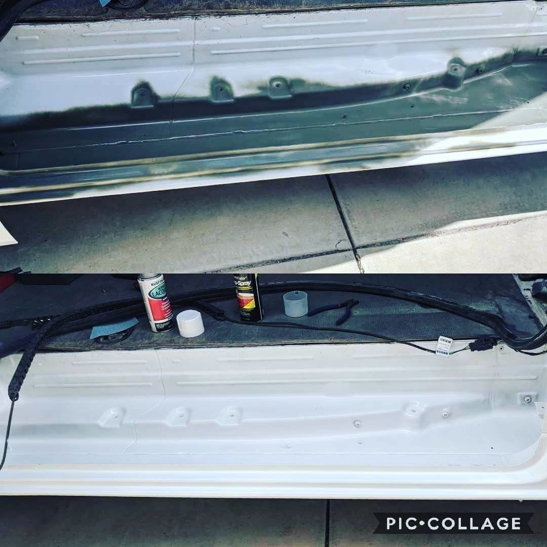

    i had to make a repair to the sliding side door because of water ingress and rust.

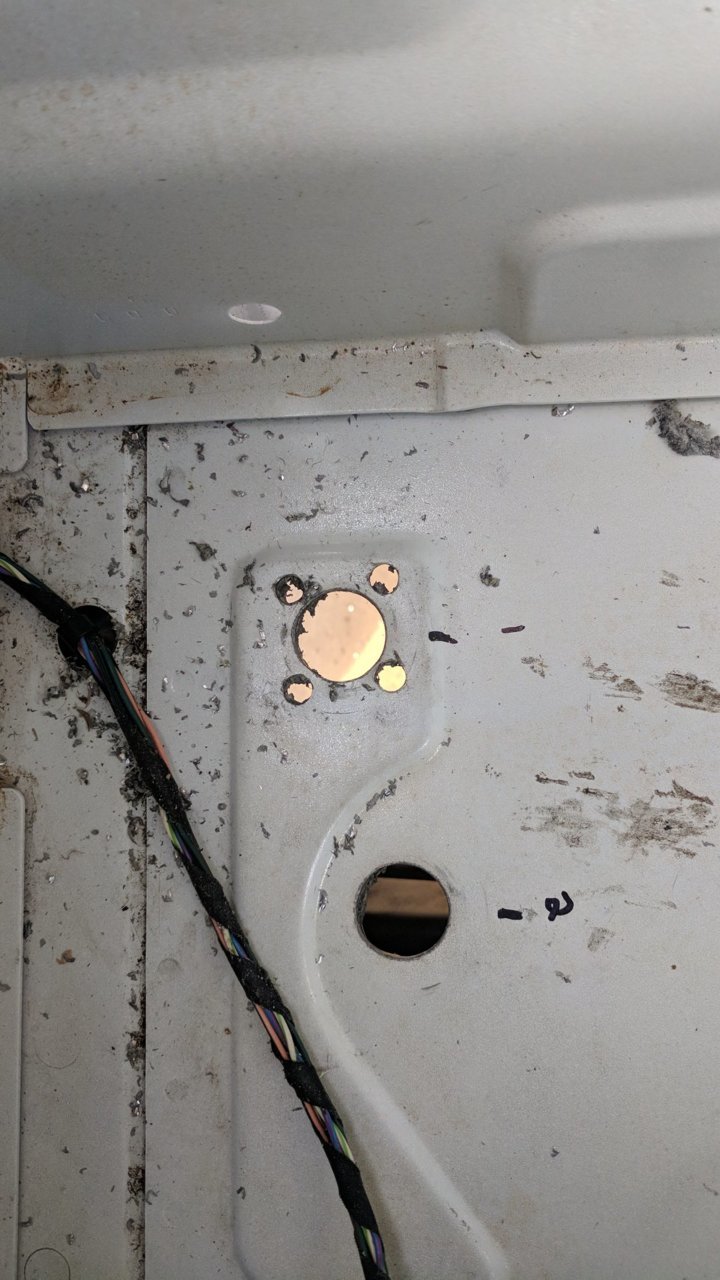

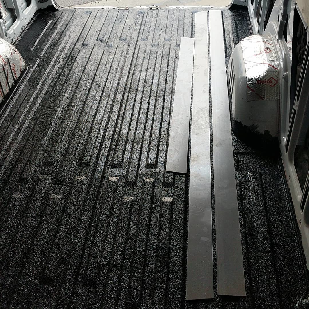

    welded in a steel plate to hang the bed rails on.

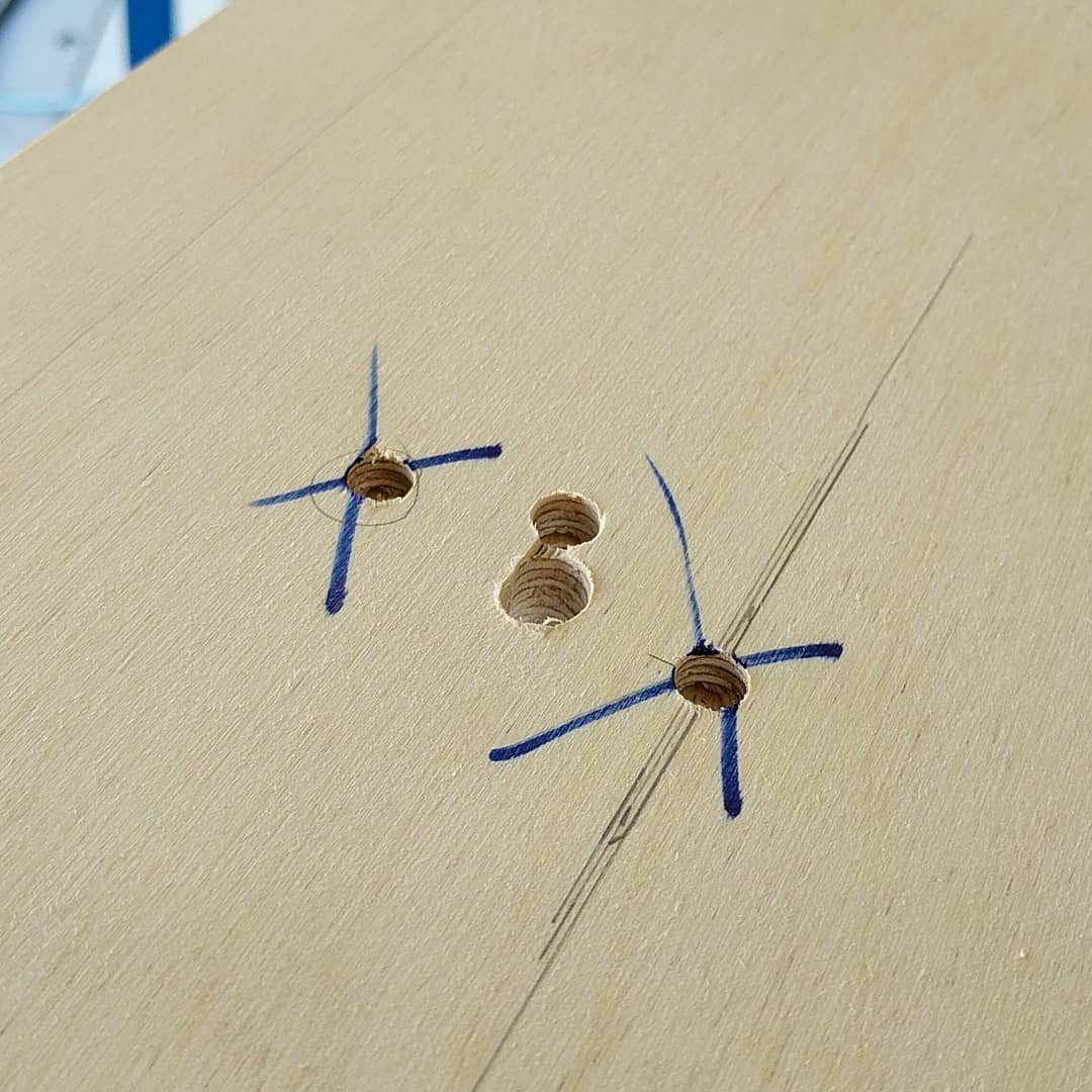

    precision is my middle name.
    40095234_10217038316649292_5192860574647_d2e0fb6edef4f5481a4fa6f44bddc85968949882.jpg
    R4D4G4ST and Fargo Taco like this.

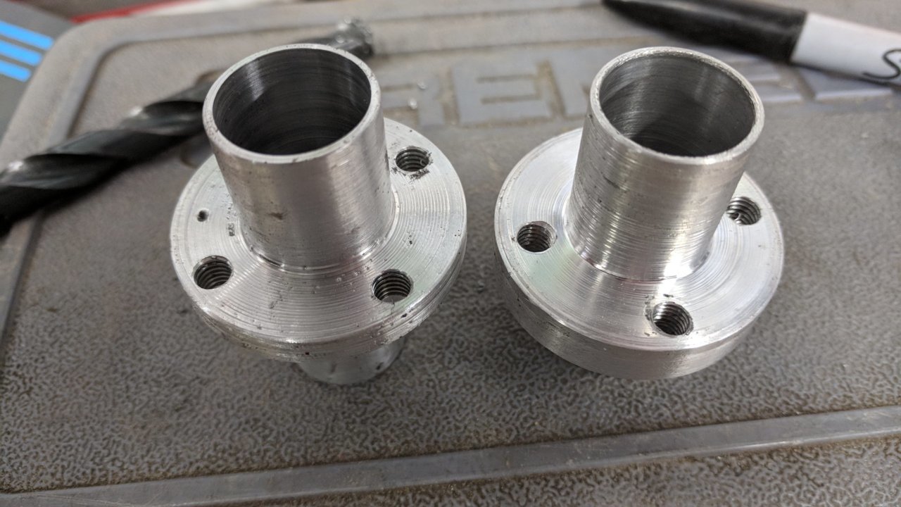

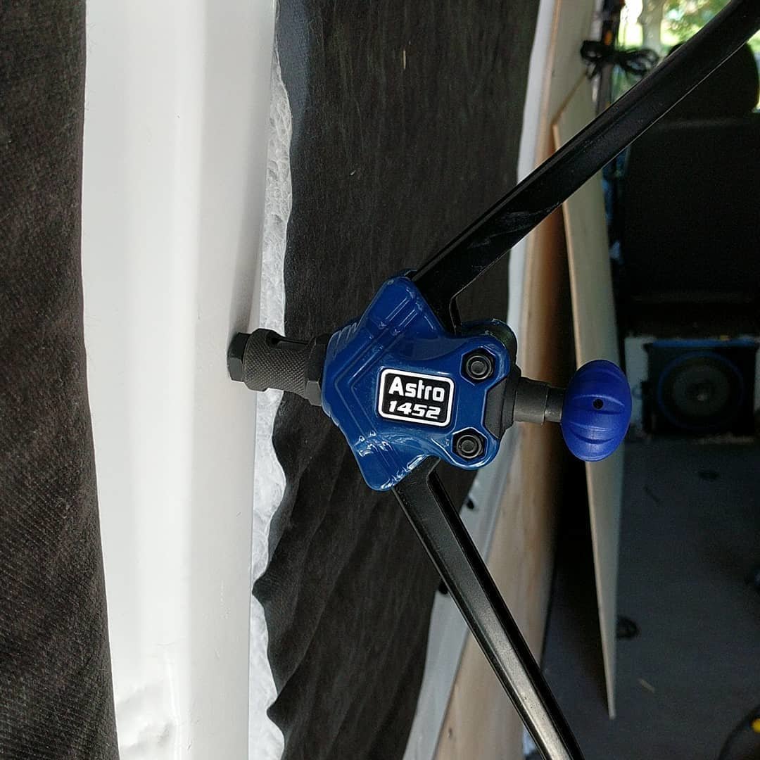

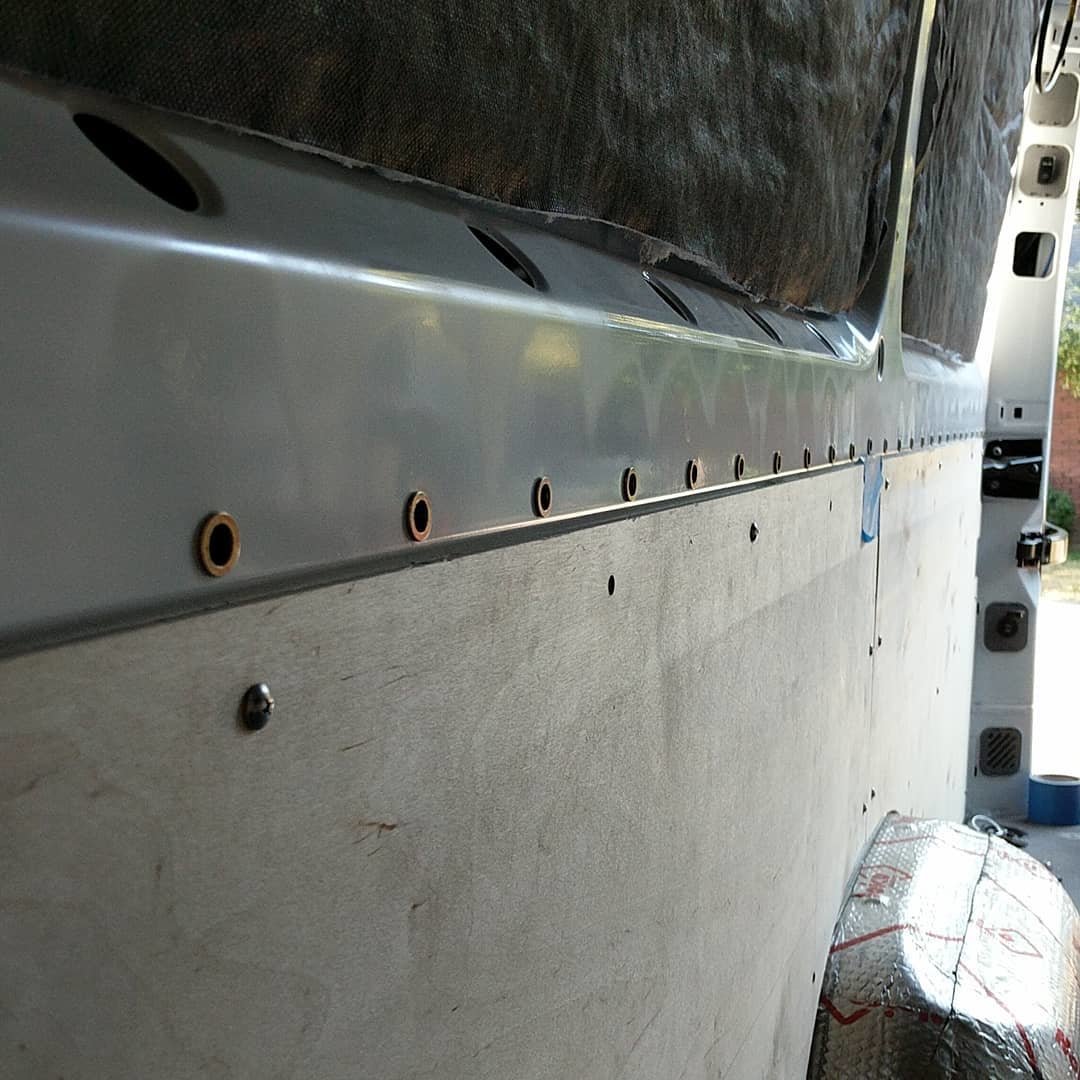

    i hung about 2 billion rivnuts.
    40565378_10217117946519989_8266417752386_05138f48a0de873c61f86f3a1ee9a8f865033430.jpg
    40205733_10217068711969156_7849452564830_8b7de258053877f0fd6bff4323aff60b926a93be.jpg

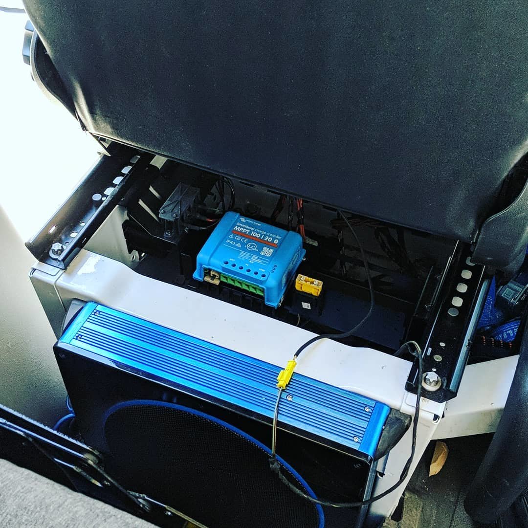

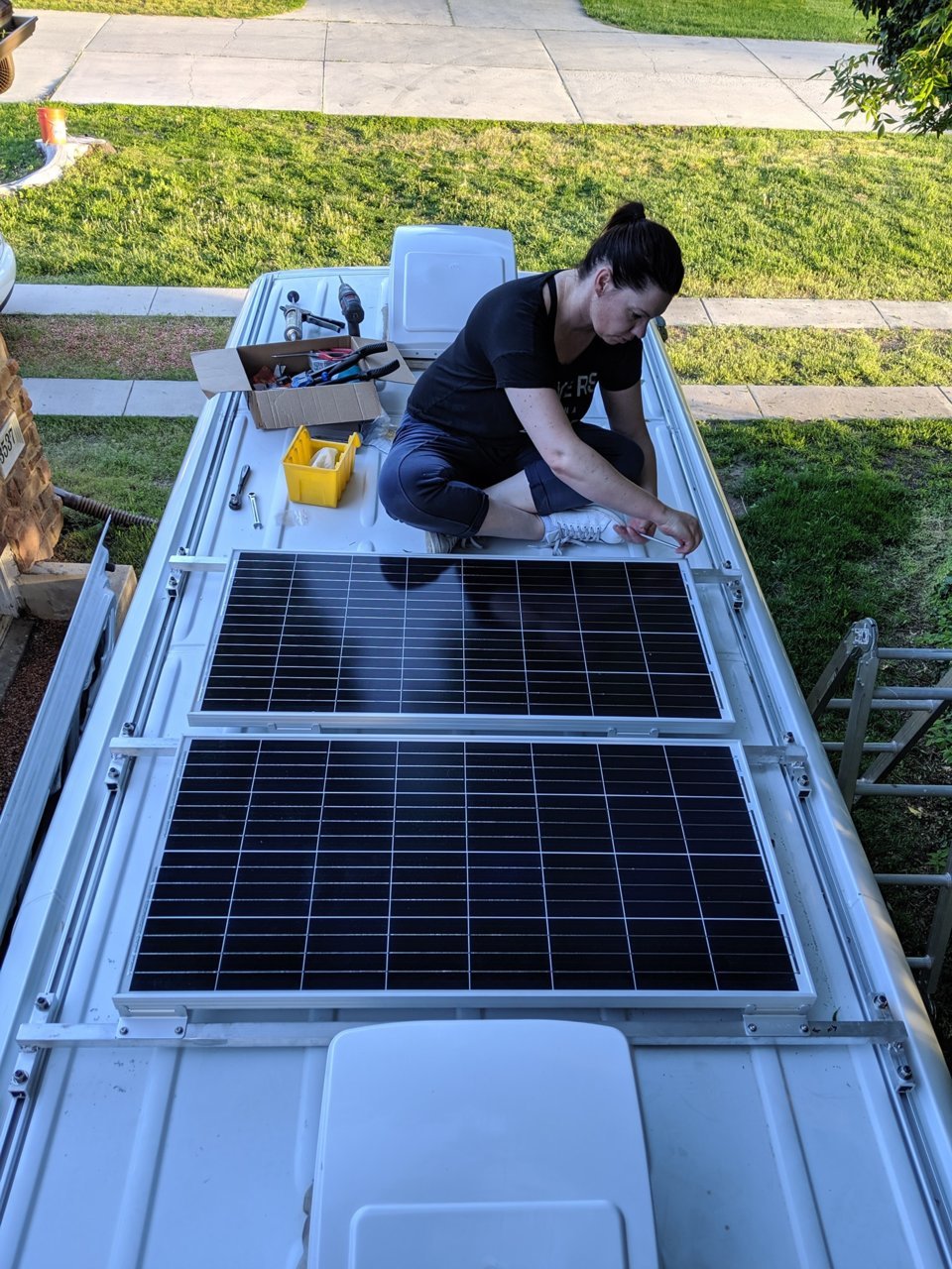

    the girlfriend helped me get the solar panels installed. we fabbed the brackets to hang it all out of 1x1 rec tube aluminum. v2 of this rack is going to be more bolt together.

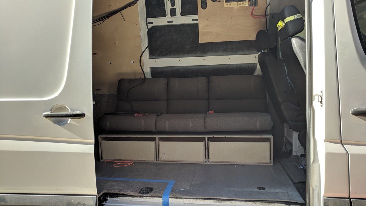

    found a couch that converts to a bed for guests. built 3 big drawers for under the couch.

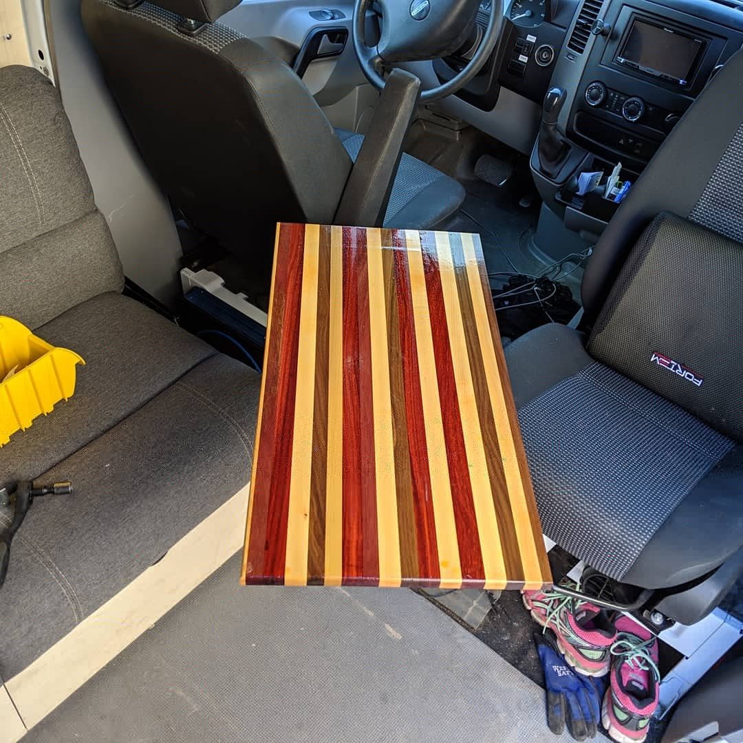

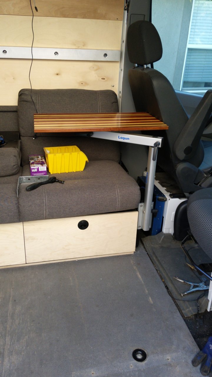

    adjustable table stand bolts to the couch, can be used by the front seat on a swivel as well
    58691844_10219204400800042_7761040942215_ddd5cd531a4da565711582ff146fc7114bec02c6.jpg

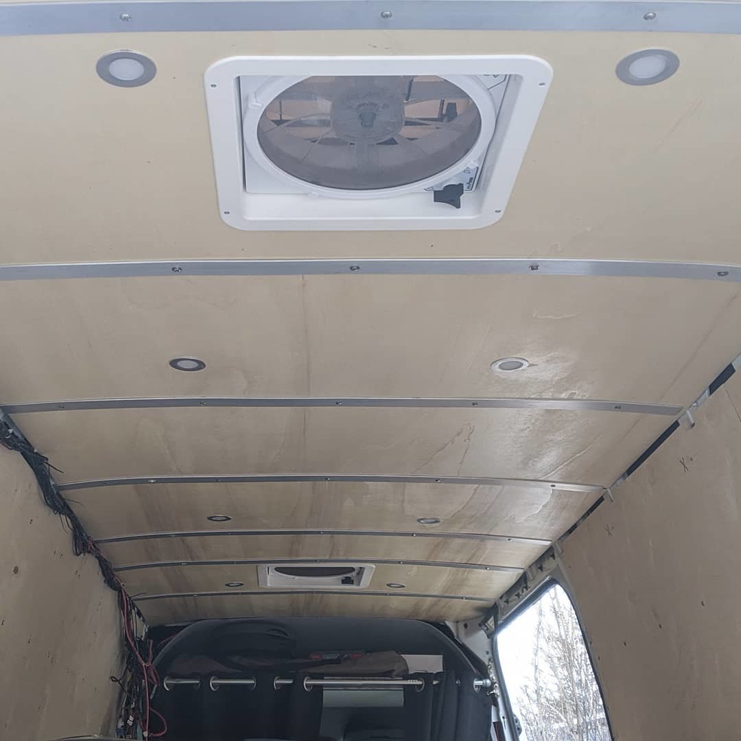

    ceiling and walls going in
    87309093_10222168790307927_2068427147055_fad28803737f3e5768b6bd3dda587ca6e9ac4e6a.jpg

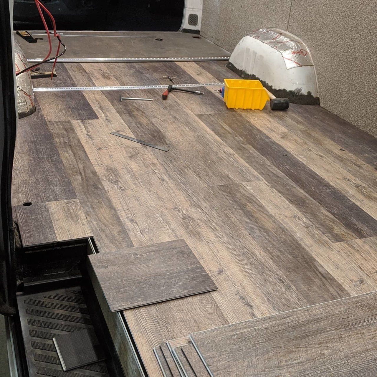

    flooring with L-Track going in to haul the bikes
    119093836_10224304260093337_691369738527_198069c69c4e7fd879e5fb820958f35ab943a9ba.jpg
