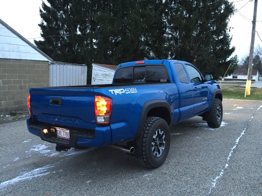

    2016 Offroad AC

    What tires and size are you running? That looks awesome

    Cooper ST Maxx. 265/75-16
