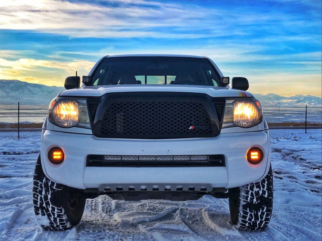

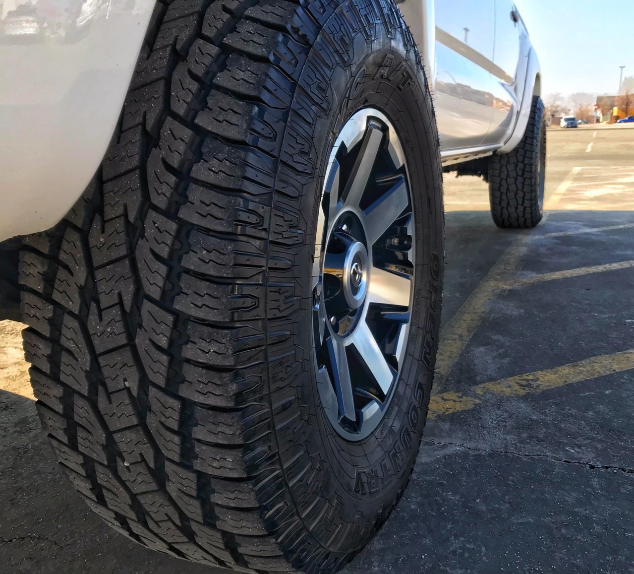

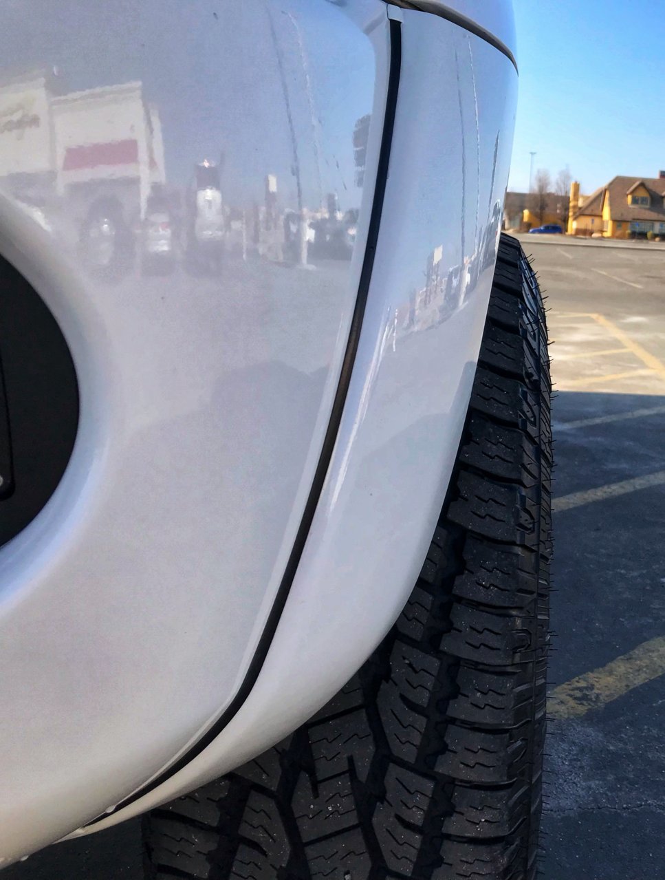

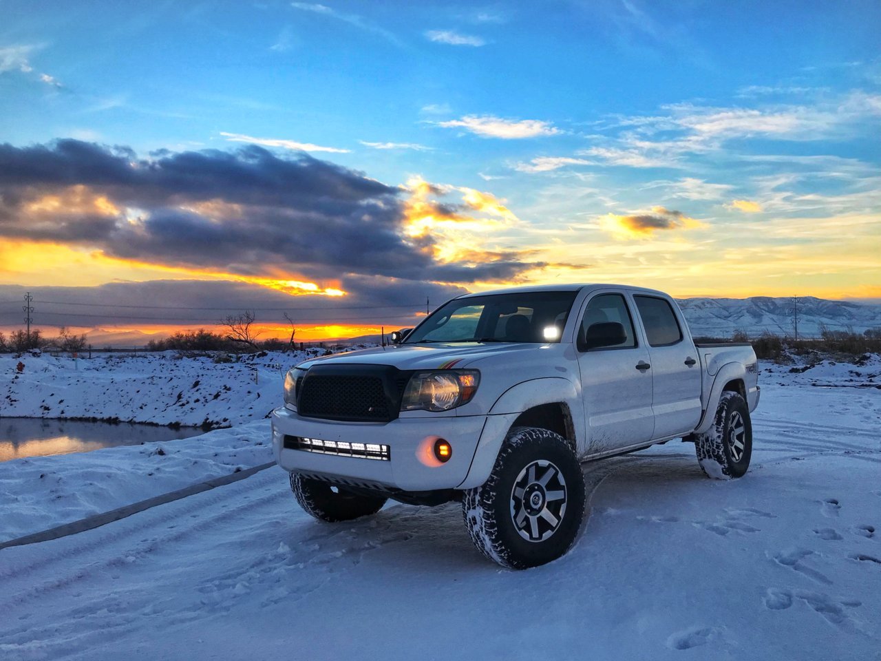

    2nd gen guy here but I just installed spidertrax 1.25'' spacers a couple weeks ago to fit my 285's. I'm on a leveling kit and 4runner rims. The only reason why I added the spacers was because I was rubbing the uca. I did a lot of research because I always heard bad things about spacers and I didn't want to fork up the money for different rims since I like the 4runner rims. To my surprise, contrary to what most anti-spacer people say, I was hard pressed to find any issues with the hub-centric spacers. Now the normal plate spacers are bad and that's what gives spacers a bad rep. As long as you run hub centric ones like spidertrax, unless by install error, you won't have any issues from what I've seen. I've read hundreds of posts by people that run them for years and off road with them more than I do and never had an issue. Again, just my $.02 since I recently did a lot of research about it and was skeptical at first. That being said, once my 285's wear out i'll be getting 275's and hopefully won't need the spacers anymore, I did this more for a temporary fix till I need new tires next fall. They give the truck a good look too and no more rubbing the uca :thumbsup:
